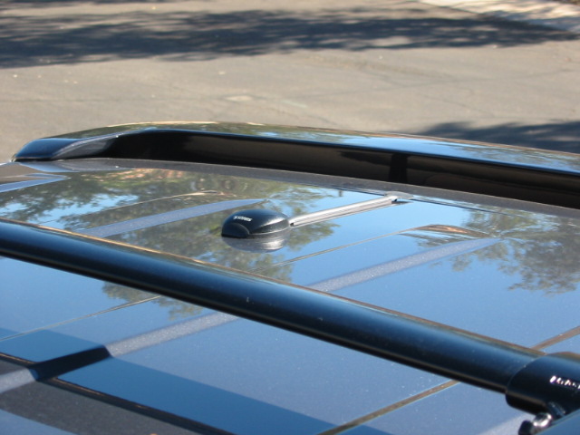

I mounted the antenna on the back/center of the roof by the rear hatch. I ran the wire down between the body and the hatch, pulled the rubber hatch seal out a bit, ran it along that seal to the left side of the car until you come to a point where the interior headliner and plastic come together (just above the rear mirror or speaker(w/JBL 10spkr)). You can easily push the headliner in a bit and stuff the wire in the gap between the headliner and plastic. When you get to the doors, just transition from the headliner/plastic to the headliner/rubber. I then ran it down the A-piller to the bottom of the dash, across to the center console. I then ran it between the silver dash trim and the dash itself over to the storage cubby.
I thought it would be tough but its actually really simple. Just use something really flat to help get the wire stuffed where you want it. I'd recommend something like a credit card or the like as it won't scratch up the interior if you happen to slip.
If you are running to the center console, You could do it like I did or veer off at the B-piller. I still had maybe 2-3 feet of wire left so it might be close if you took it all the way to the dash first.

I only have one pic of the antenna that I snapped for fun. I don't have any of the interior, but then again, the wire is hidden so you wouldn't see anything anyways.
If you are looking for something else, let me know and I can snap some more pics tonight.
