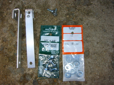

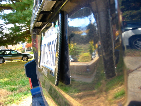

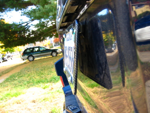

Well the rear license plate has annoyed me from day one of owning the T4R. Why did Toyota only have the top mounting holes and let the license plate sit against the sheetmetal. I got annoyed with it and finally decided to do something about it. I made some brackets out of 1/8" aluminum that was 3/4" wide. I bent it and then cut some holes with an 17/64" drill bit and mounted it to the truck. Then I mounted my license plate cover and license plate to it with some hardware from home depot.
Here is the pic of the materials I used:

I understand it's a pretty ghetto job, but no one sees it so I'm fine with it. Let me know your thoughts...
Oh btw, no it doesn't get in the way of the rear hatch handle. Well maybe it would if you hand ham hocks for hands...
