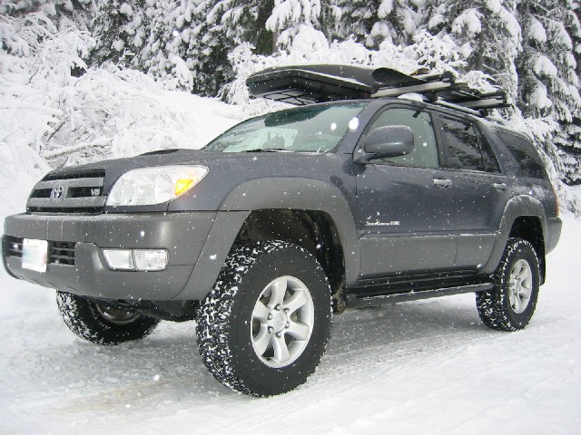

You didn't miss much today, the coverage was horrible! I now have two huge scratches in my board. :mad:
On the bright side, I left early and got to play in the snow with the new tires and lift!

damn!!...that sucker kicks ass! thanks for all the kind words about NE, we just keep getting lucky with awesome customers like yourself. wish i was with ya in that snow.
AK:)

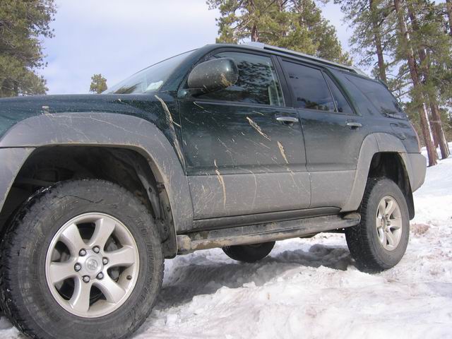

Guess I wasn't the only guy out playin with my newly lifted runner in the snow today. Took this just after a macho moment pulling a pal's van out of an ice rut while our kids were having their fun on the sleds. The mud was from new year's eve--haven't yet had the heart to wash it off.

Nice.
You gotta love it when you can help out a buddy like that.
I haven't had time to wash mine either! Too busy playing in the snow. I just wish we would get some down here in the low lands.
