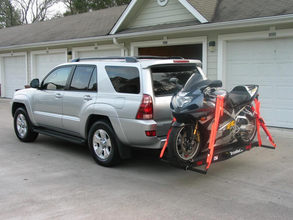

Versa-Haul Sport pictures
Here are the pictures I promised for the Versa-haul Sport model.

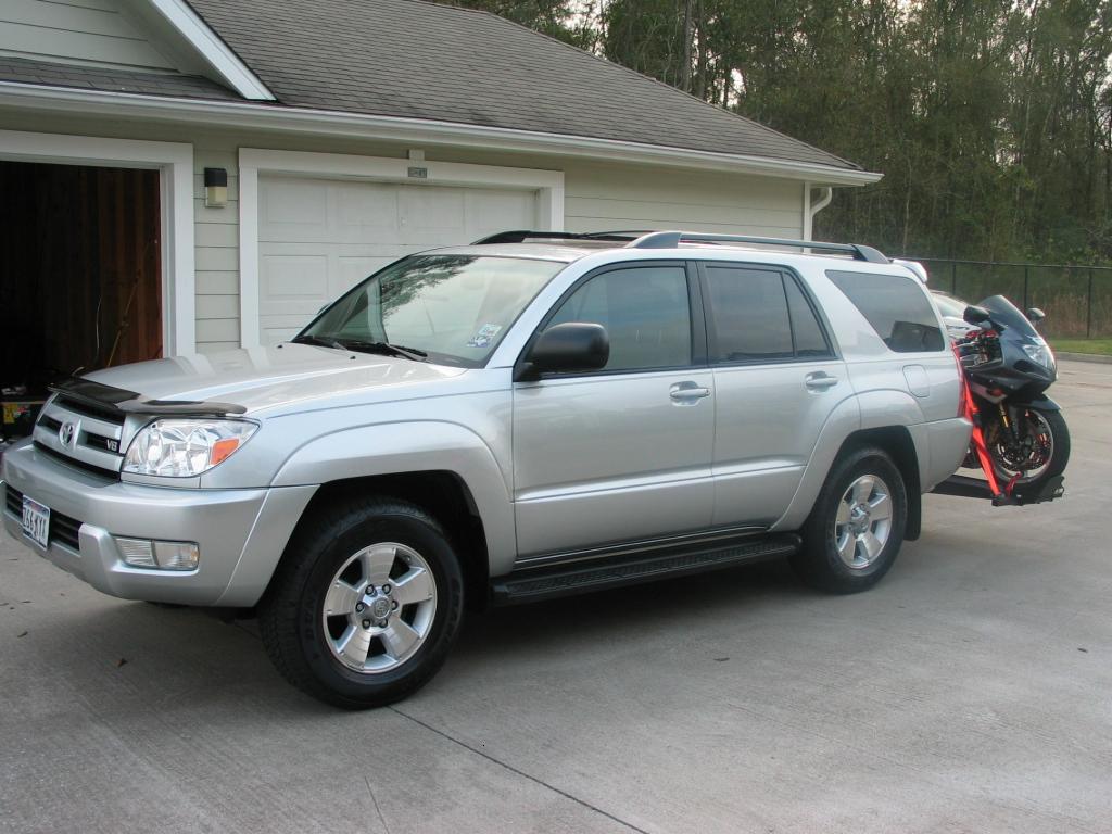

pic #2

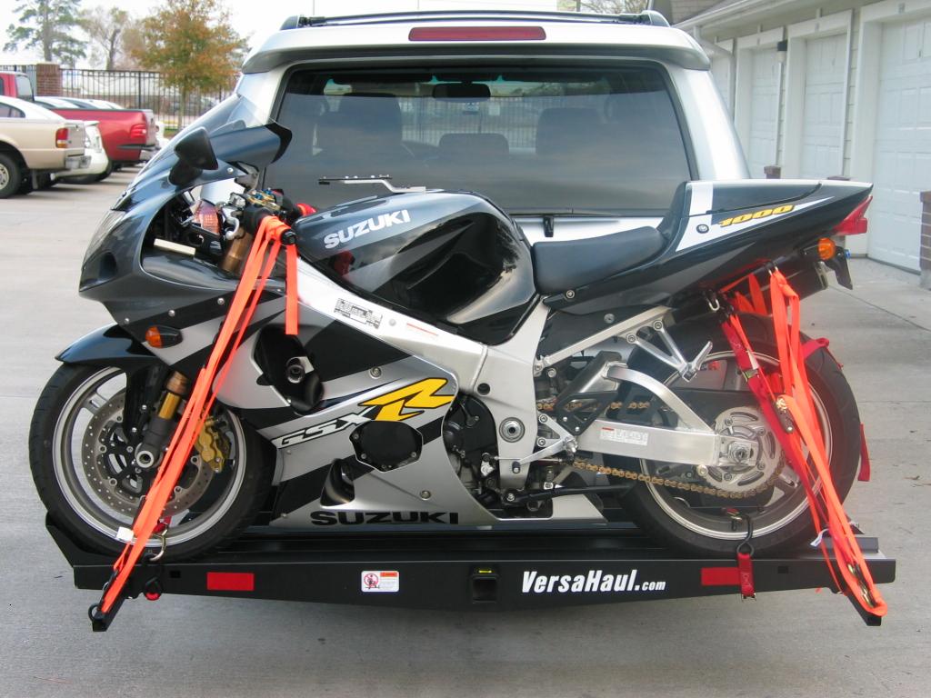

pic #3

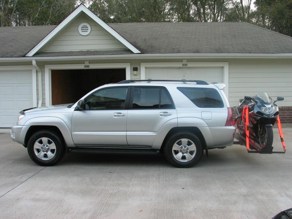

pic #4

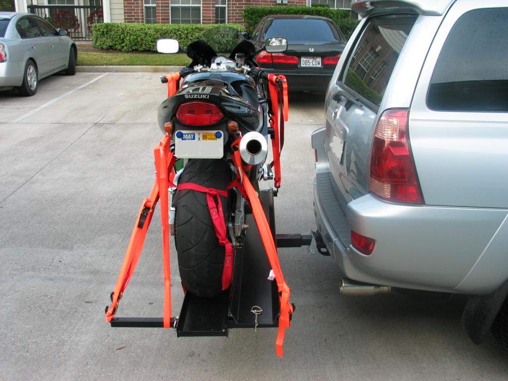

pic #5
