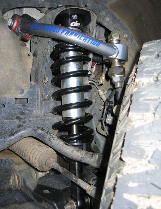

Here are three photos of my Donahoe 2.5" Tacoma Coil Over struts installed on my 4th Gen 4Runner.
This is a photo taken from the front.
The amount of lift is just under 3". This was established by the amount of lift in the rear. There I have the NE spacer still in placee, with the Revtek shocks connected to the stock shock mounts. The front struts were adjusted to a height that leveled the 4Runner frame front to back. This measurement was taken between the bottom of the frame and the top of the alignment table.

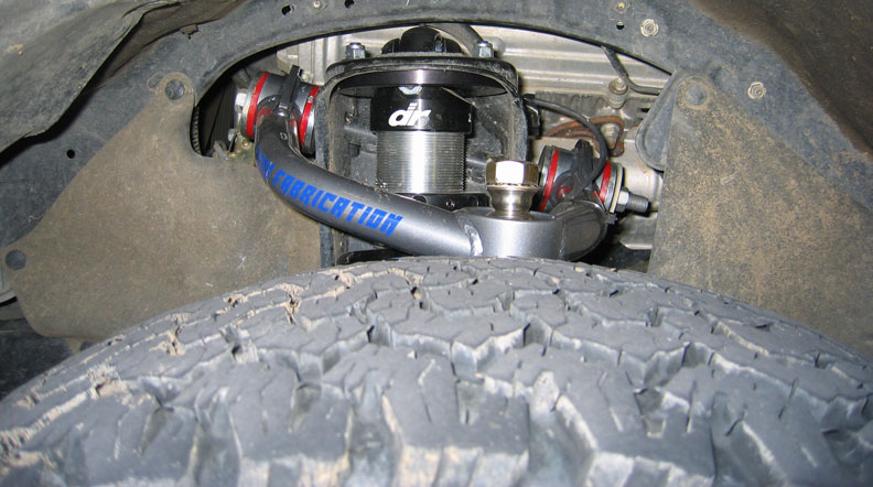

This photo is from the back.
The Total Chaos upper A arm required that the top hole in the spindle arm be enlarged to 3/4". So, no going back.

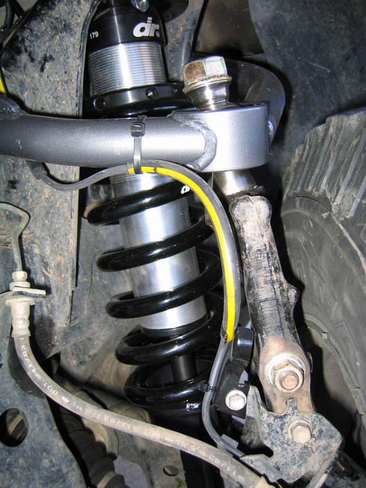

This is a side view. What you see when walking by the 4Runner.

OK, measurements across center of wheel: FR - 37.25, RR - 38.50, LR - 37.75, & FL - 37.00
Remember though, the measurements for the proper front strut level were taken from the bottom of the frame.

Yes, BFG AT KO 265/70/17.
I don't know about the body measurements. I'll do it again tomorrow to see if it is different.
Yes please check again. It seems like you got a nice 3" lift from the Hoes :D And if I look at the way they sit now on the 4R it will be easy to get a bit more if required, even with a bumper and winch. NNIIIIICCCCCEEEEEEE!!
