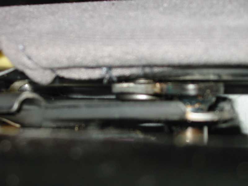

So here it is...
First, thanks for the hint Jim_Chow. I would have started with a much higher torque by accident.
Now on with the work at hand. I removed the seat but after doing this and diagnosing the issue I realized you can install a fix without removing the drivers seat. My fix is semi-permanent in that you wedge the front thigh cushion into a fixed position (in my case, all the way up) but the wedges can be removed if necessary.
Push the seat back on the rails, raise the seat height and thigh cushion adjustments to the top upper positions. This gives you room to work and install the wedges (pics to follow.)
My cushion rear pivot points don't have excess play or movement. The front inboard and outboard adjustment cam & gear have excess vertical play and slight horzontal play. This allows the cushion to shift and make clicking sounds. Right above where the adjustment mechanism is anchored (in the horizontal seat framework) there is an angular gap that is ~15 degrees. I cut small wedges out of hardwood flooring material (this has a groove that fits over the seat framework.) Gently tapped them into place and no more movement.

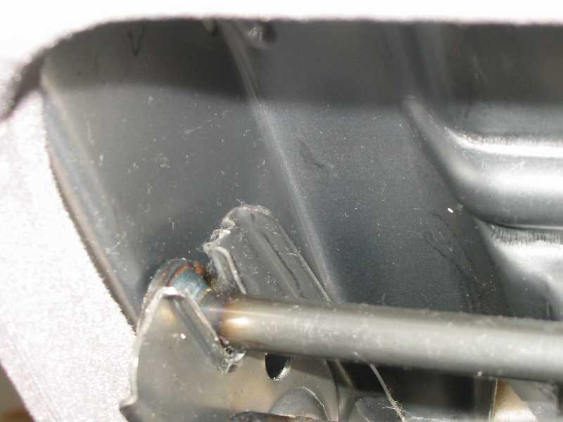

Right side

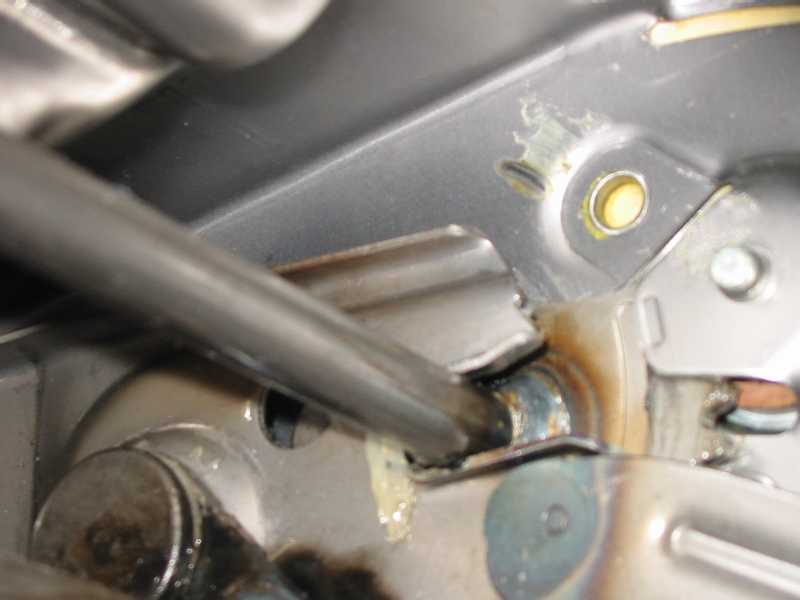

Right side front outboard pivot with lots of play/movement

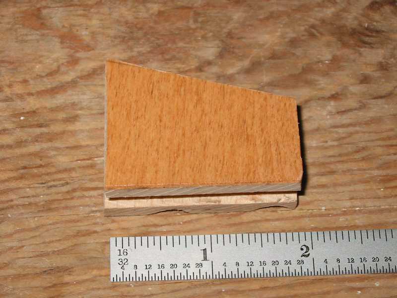

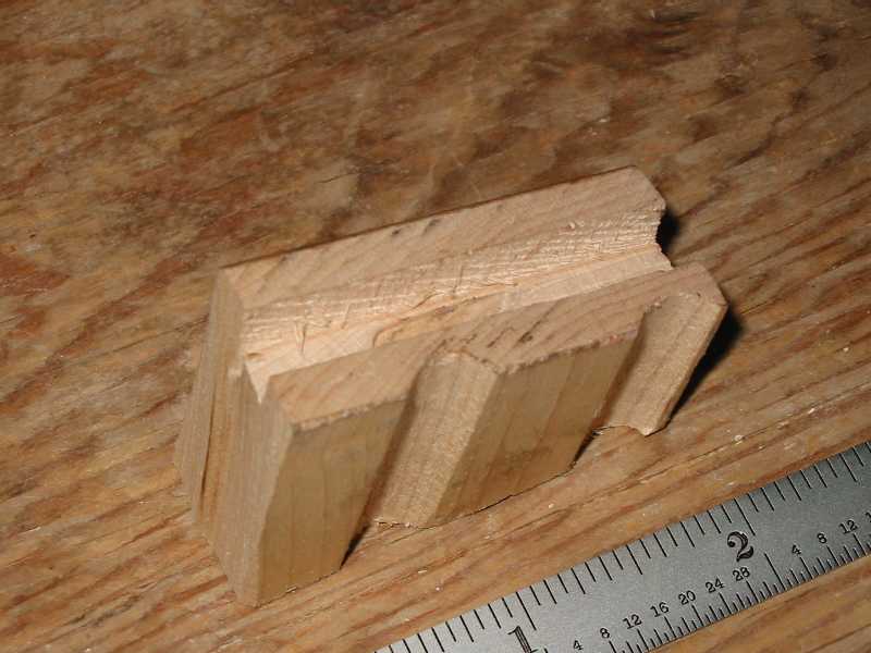

Wood wedge less than 2" long, 15 degree angle 1" high at wide end

Edge view of wedge showing groove.

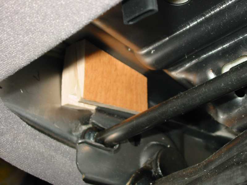

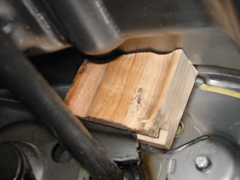

Wedge in place on left...

and right side (notice how groove fits over framework)

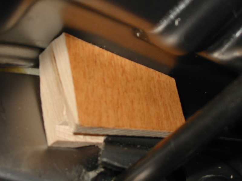

Last pic with larger view.
