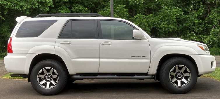

I just wanted to thank Gimli and Wiley for this discussion. By coincidence, I am in almost the exact same situation, and will be having the Eibach kit installed in my newly acquired 2008 V6 Sport next week. So all of this information is invaluable.
Mine only has 91K miles, but the X-REAS is still 13 years old and feeling a little squishy, and I want a moderate lift/level anyway. Usage will be 90% pavement / 10% moderate off-roading. (I'm in snow country.)

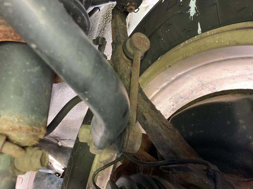

I also have a torn LF CV boot and it looks wet on the other. Because I have no service history at all, I don't know if it has been torn for 1000 miles or for 30,000 so I will be replacing both axles while everything is apart. It had a bad LF bearing when I got it, and I also plan to replace the RF hub assembly, as well.
So maybe I will re-phrase Wiley's question: is there anything else under there we should be replacing in hopes of avoiding any repairs for the next 100K? Gimli mentioned the top hats, which I hadn't thought of. Is that due to corrosion?
The shop will be changing the sway bar bushings, but I'm wondering if I should consider other things like the sway bar links or even the control arms just due to the age of the rubber parts? I'm in the northeast, and fortunately rust is not a serious issue on mine, but that is in the picture. (Fluid Film is planned after the suspension work.)
Thanks to everyone for any advice.

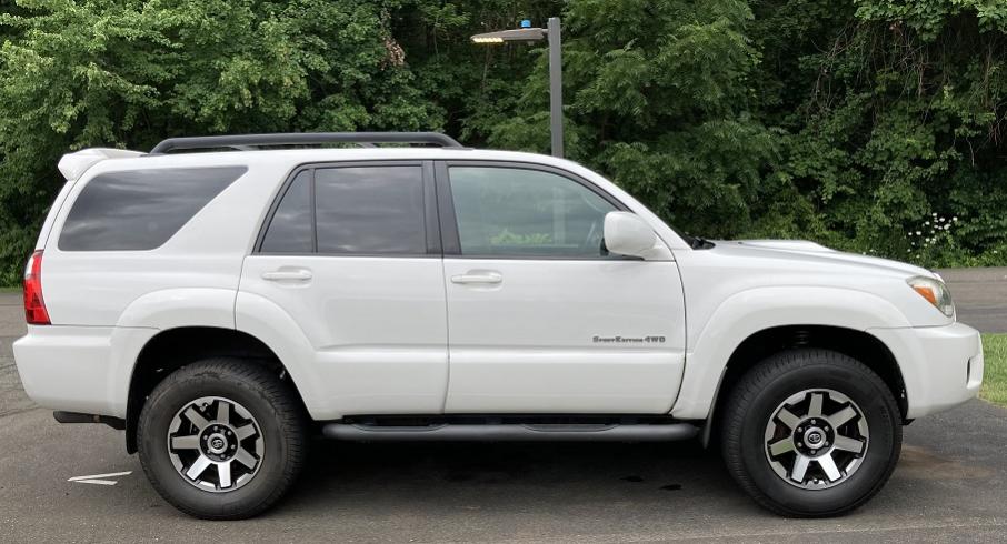

Just an update after the Eibach kit was installed.
1. Love it. Looks great, rides great. Nice option for replacing an old or failing X-REAS system.
2. Great price on the components via tire Rack. Even better if you subscribe to freeshipping.com .
3. Still rubs a bit with 265/70R-17 on full right reverse lock, but I'll heat/reshape the fender liner shortly.
Before and after:
