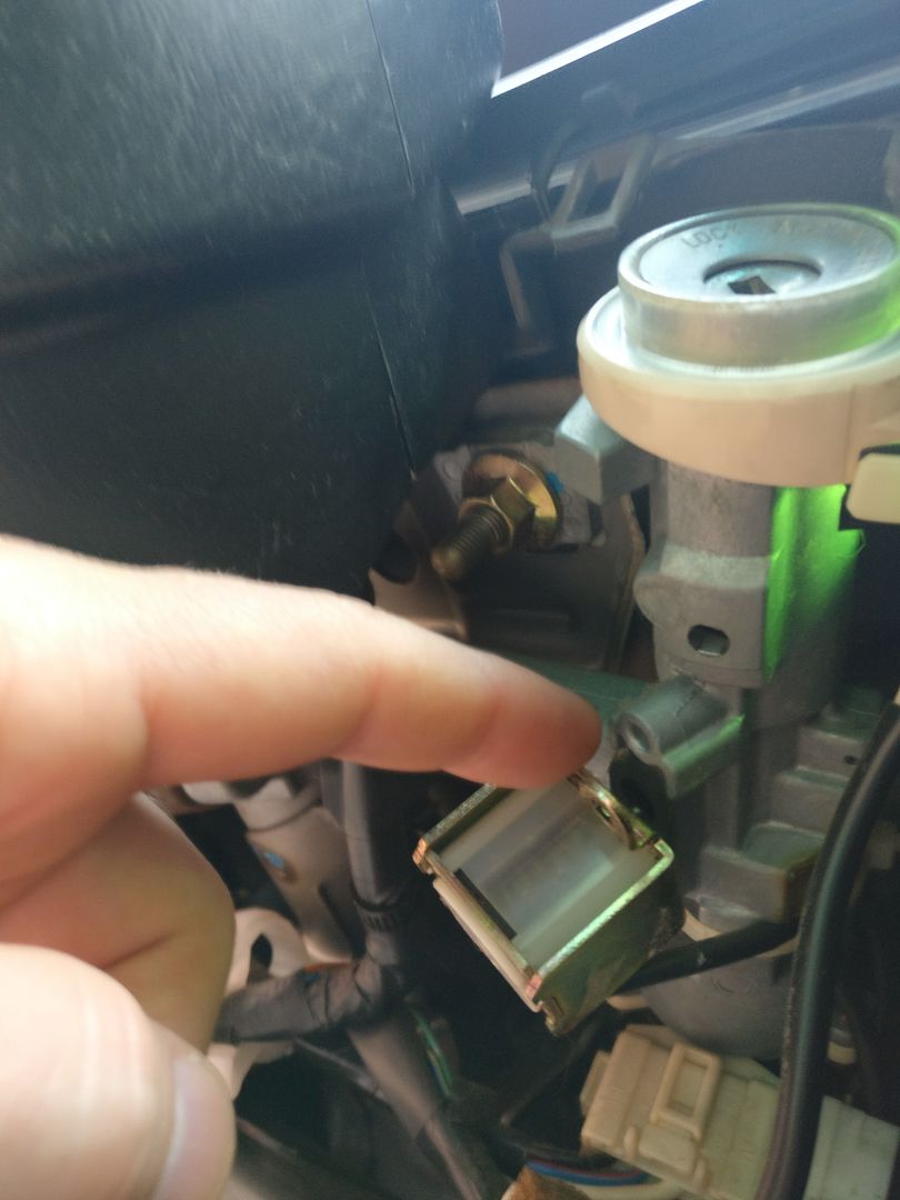

Anyone know how to fix this? Been dealing with this for a few years now. I tightened the linkage to the transmission so it applies pressure to the shifter pushing it forwards a little more which helped, but can't seem to always get it to "click" into place all the time so I can take my key out.

Pull the lower dash portion off, pop the black trim piece off around the ignition & you'll see this little square solenoid held on by 2 Phillips head screws. Back the front screw out completely & the solenoid won't allow the key to lock in. Leave the other screw out some, but leave the solenoid attached & your problems should be solved. Some have reported that they can pull theirs out in any gear... Mine stays locked in outside of Park. Hope this helps you.
