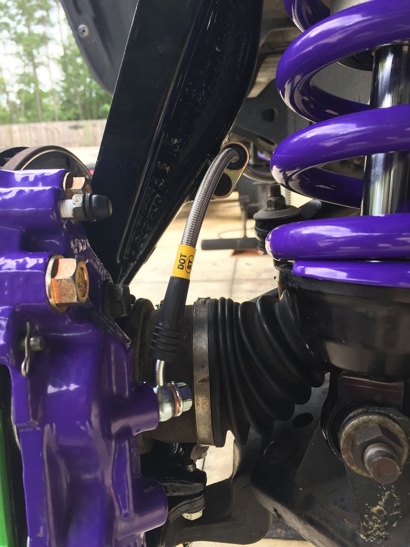

Quote:
Originally Posted by papabeach View Post
theeostericone,
Looking at your pic something about your gusset looks different to me. Is it the angle or were they installed so the access to the UBJ bolt is accessible from the back instead of the front? Maybe these are different than the TC ones I have...or maybe its 3am here and I am confused.
Quote:
Originally Posted by turbodudey2 View Post
Yeah, it looks like the gussets were installed on the wrong side (left gusset on the right spindle, and vise versa).
No wonder I never have any clearance issues others talk about. I never actually looked at any install directions. Just trimmed them and welded them up. Incorrectly I guess. lol
After wheeling on them like that pretty hard I'll probably weld my next set up incorrectly as well. I don't think it compromises the strength. The way I have them gives me zero clearance issues and I can replace the SPC slug pretty easily.
Thoughts? Other then I'm an idiot?

Quote:
Hey man, at least itís functional! I wouldnít beat yourself up too much...I have a number of ďmodsĒíthat work but arenít really what was intended...part of the fun 😜
I'm not. I'm laughing pretty good right now. None of my wheeling buddies caught it. Given that I solved all clearance issues it might be the new standard. lol
Nothing wrong with it, looks like an improvement to me, with my experience changing the slug. I have another off-road vehicle with a set of (cough) radius arms, installed opposite and upside down for better up travel. Its been that way for years.

Looks to me like it somewhat defeats the purpose.
The gusset looks to be designed to provide good support to the upper ball joint flange(my word) and support to the shaft.
Mounted as designed they catch the ball joint flange on the far end (point of most support) and one side (lesser support). They also support the shaft.
As pictured there is only support on one side of the upper flange (lesser support) and then support for the shaft. You’ve also moved the corner of the gusset (strong part) away from the outer edge of the ball joint flange where it was intended to provide support.
Just my opinion......

Quote:
Originally Posted by midcoma View Post
Tacoma brake lines. Mine weren't extended length or anything. Tacomas have a banjo fitting at the caliper instead of a hard line. These spindles are from a Tacoma, so I'm not sure if the mounting tab for the brake line is different or not.
Midcoma, Sorry to resurface this thread, but had a question for you. I've got the StopTech/Centric 950.44014 Taco lines ready to install.
I'm running 199mm TBU
I've read in some places that the Centric banjo bolt it a hair too long and you should double crush-washer it with a crush washer on each side of the banjo.
Did you find that to be true for you?
Thanks!

Quote:
Originally Posted by WeakSauz View Post
I've read in some places that the Centric banjo bolt it a hair too long.
Iím running the 231mm TBU, and itís been a while since I installed these brake lines, but I donít remember the banjo bolt being an issue.
Either way, Iíd recommend buying shorter banjo bolts instead of doubling the crush washers.
Thanks!
Try threading the banjo bolt into the caliper without the brake line to confirm if it will bottom out or not.
Mine were slightly too long. It's not the threads of the bolt that are too long though, the inside diameter is what will interfere.
It's an easy fix. All you have to do is slightly drill out the end of the banjo bolt to provide a little relief. Then recheck the bolt in the caliper, and you'll be good to go.
