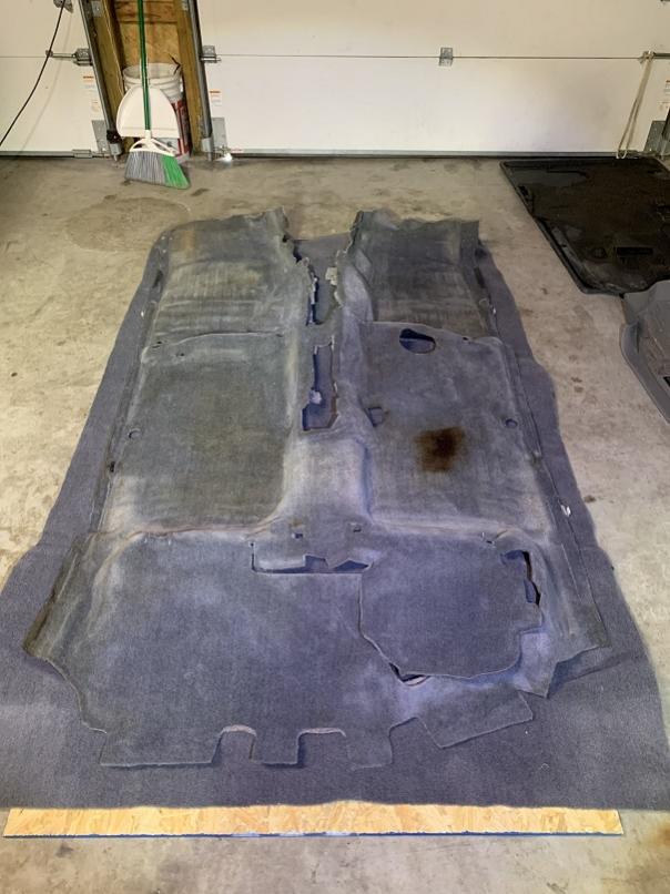

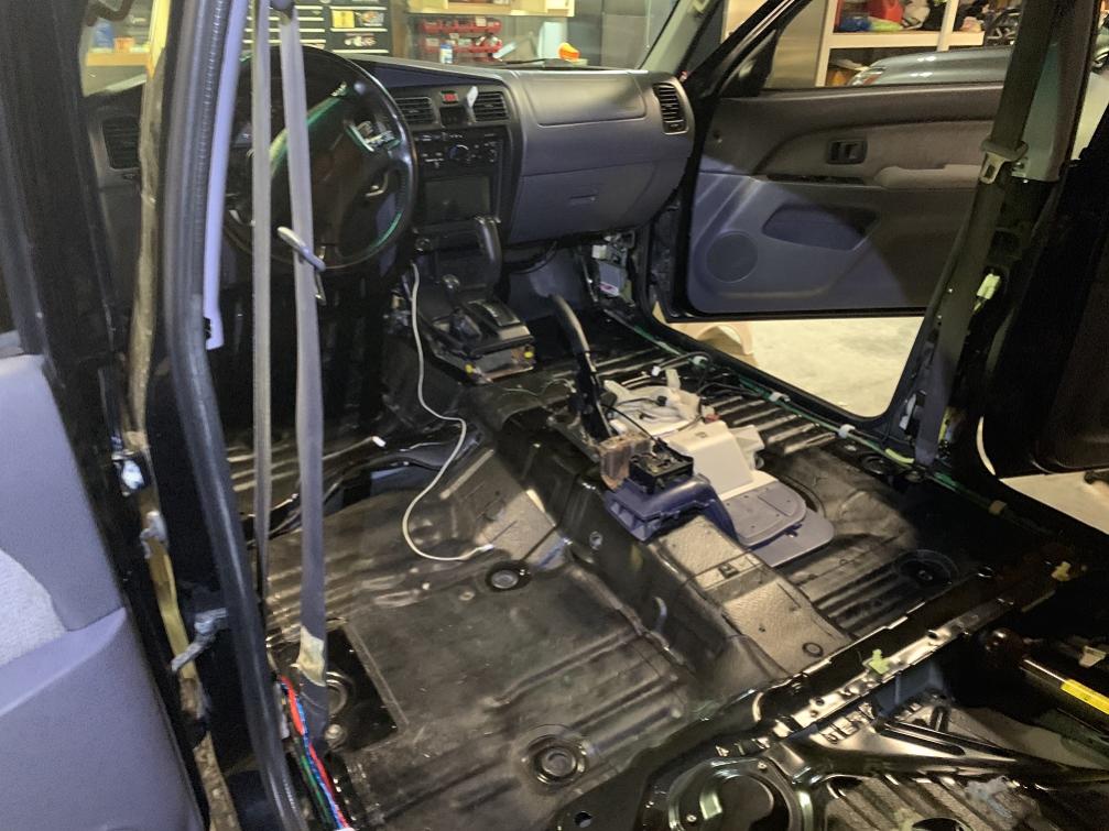

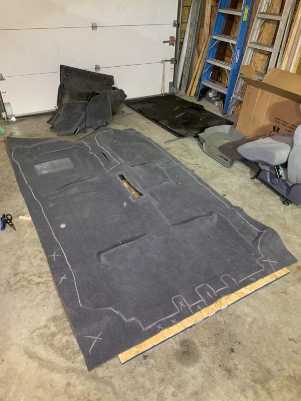

Attached a few pics from when i did mine. Did it over two afternoons but definitely could have gotten it done in a day. make your cuts very conservatively/slowly to avoid taking more material than absolutely necessary.
