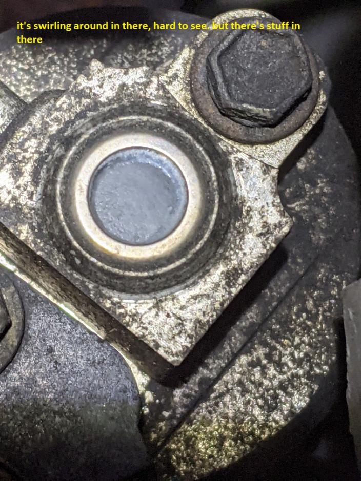

Manifold hooked up and set up the AC to high, doors open like FSM says....no pressure readout at all. The gauge knobs were indeed open.
Then I set a vacuum to the system to the lowest I could get (-30 on the low side) and closed valves, came back 10-15 minutes later, still at -30. So there's not an obvious leak.
As for the sight glass, I don't know what's normal. The manual says it should froth a bit right after turning off then go clear. I think it does that, but I ran over to see from the driver side so maybe it was clear the whole time. During operation, I'm not sure if there are bubbles. It looks like clear liquid is swirling around in there but a bit of white foam...are those bubbles? I would need to see an example of an obvious bad sign.
The major deficit is that nothing happened on the manifold~!

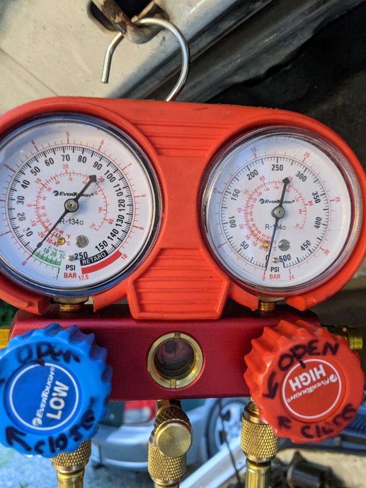

Quote:
If your compressor clutch is engaged then you have a problem with your gauges. Compressor clutch will not engage unless there is enough pressure in the system

I decided to try the manifold test again and realized that I did not have the Schrader valve depressed on the service ports of the car. And I ran the test and found 5 to 10 PSI on the low side and about 140 psi on the high side. Both much lower than factory specifications. I'm doing a vacuum test right now

ok i did the recharge using the process outlined in Timmy's video, loading into the low side with the engine running at the above specs. During further testing I was trying to get numbers again and I think I drained all the freon out. oops! I believe the valve in the kit I rented isn't functioning right. It holds a vacuum in the yellow line, but if any pressure comes out through either the low or high side of the manifold, it leaves through the yellow line.
So i basically started from 0 recharging things. I got it up to 34/215 psi on the low/high. that's within the specs (21.7-36.2/198.7-227.7) and just like in Timmy's video I disconnected the high side then tried to drain pressure back into the low side, problem is the valve on yellow leaks so instead it leaked out that way, potentially lowering my system pressure too, but I stopped it soon after I realized what was happening. During the recharge I got the temperature down to 46 degrees in the cabin, started from 97. I may want to try this on my wife car too, it's not warm like mine, but it's only 6 bucks a can for freon, why the heck not! Then I'll top mine off as needed.
