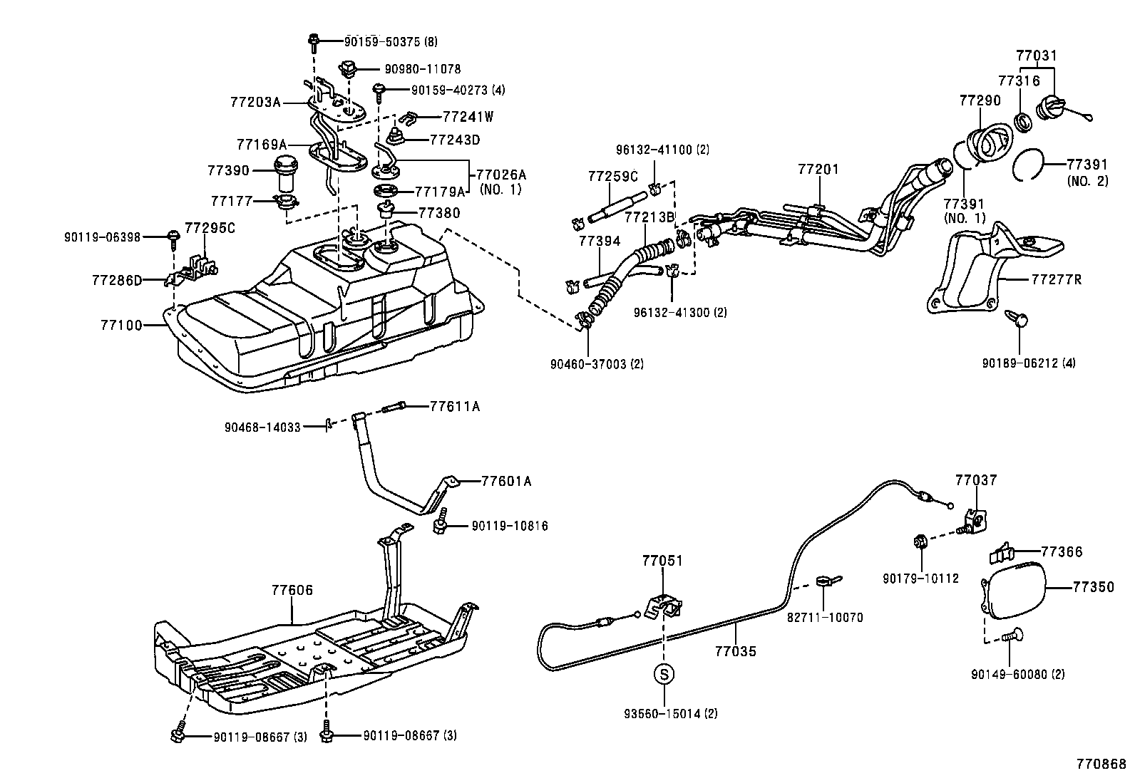

Quote:
Originally Posted by JohnLocker View Post
I’m still trying to find the necessary hard to mount it for my 2001
90189-06212 4 req'd
96RedRunner is offline   Reply With QuoteReply With Quote

Quote:
Originally Posted by 96RedRunner View Post
90189-06212 4 req'd
JohnLocker is offline   Reply With QuoteReply With Quote

http://www.japan-parts.eu/US/3/770868.png
Looks right!
thank u so much and i need 4?
Old 11-15-2022, 01:52 PM #23
96RedRunner 96RedRunner is offline
Senior Member
Join Date: Jun 2016
Posts: 2,071
96RedRunner is just really nice 96RedRunner is just really nice 96RedRunner is just really nice 96RedRunner is just really nice 96RedRunner is just really nice
Senior Member
Join Date: Jun 2016
Posts: 2,071
That's what the 4 in parentheses means.

Yeah, they are the same nasty square plastic grommets that hold the wheel well liners on. The ones that are impossible to remove without breaking. I just had to do that filler neck which rusted out and I could not save a single one. Luckily I bought a dozen on eBay a while back.
EDIT: Here is a listing for 20 of them for half dealer price. I recommend keeping a stock.
20Pcs Fit Toyota screw grommet clip splashguard bumper wheelarch 90189-06212 | eBay
