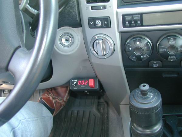

I have posted two shots of the Jordan controller installed on my 04 unit. I have placed my foot on the brake pedal to indicate the LED display.
My 4Runer came with the factory wiring harness in the glove box and I simply spliced the required wires to it, plugged it in and that was it - about 30 minutes total, including the bracket on the brake pedal

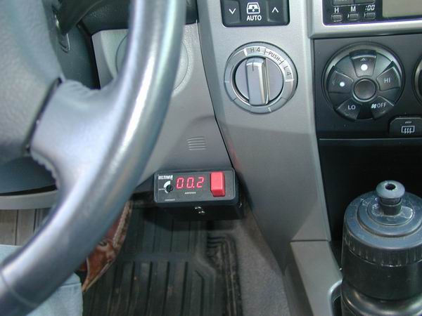

Second shot

Just finished my prodigy, I put my on the fusebox door. If i sell or trade it in i can replace the fusebox door prior.
http://64.26.171.210/hitch/9.jpg
http://64.26.171.210/hitch/8.jpg
Took 30 minutes or so, buried all the wiring up under the pedals with tie wraps.
