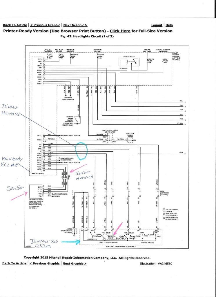

Quote:
Originally Posted by Bimmer-Bob View Post
Did you end up doing this? It looks like it's $200-$300 in parts (for the light sensor and stalk switch), which I'm okay with. I also don't have a problem pulling parts of the dash, but I'd like to have some sense of how to do the wiring before I start.
Anyone have any diagrams or schematics or anything?
I'm also looking to do this. It seems like a lot of progress was made in this thread, but then it just died off. Surely someone got this working. I'd love to see an update.
trickinit is offline   Reply With QuoteReply With Quote
"...Anyone have any diagrams or schematics or anything?"
Hi Bimmer-Bob,
I'm leaving this 5'th gen 4Runner 'limited' Headlight circuit diagram here on this thread; hoping that you (everyone) will accomplish your goal. I took a quick look at the diagram and marked the essentials needed to make it work, "see below":
It looks like you'll need only four parts as noted by the I.D. labels in pen e.g., the Headlight dimmer switch assm, Dimmer SW. harness, Automatic light control sensor, and the Light control sensor harness. The Main body ECU Network compu are ALL the same from 2010 to 2015, so no changes needed there.
Cheers!

Quote:
Originally Posted by rigtec View Post
Hi Bimmer-Bob,
Cheers!
That's EXACTLY what I was looking for. Thank you! I think I'm going to give this a shot if I can find the parts for a reasonable enough price.
Hi Bimmer-Bob,
Cheers!
How can I find the part numbers for those harnesses?

Quote:
Originally Posted by trickinit View Post
No, I never did. I wouldn't call myself much of an expert when it comes to this stuff, so I don't know if I dare take it on without some clear instructions ahead of time. I would still love to make it work though. It's kind of a bummer that this thread seemed to die.
Yeah, I'm pretty much the same as you - I'm sure I could do it, but I prefer to have some clear guidance rather than be the trailblazer who starts picking his new-ish truck's dash apart.
I found this post covering the same retrofit in a 4th Gen. I bet our install would be much the same. I wonder if our truck uses the same wiring harness? The thing I can't quite make out from the thread is what he is unplugging from behind the instrument cluster to plug in the light sensor harness.
