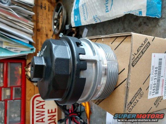

Can someone confirm if the center tube from the plastic housing needs to swapped to the metal housing? I havenít ordered yet but thought the tube is longer from the plastic housing.
Thanks.

Yes you will have to swap out the center tube from the plastic housing to the metal housing. You'll need to bend the center tabs slightly up, then push center tube down and rotate to remove it. Reverse directions to install into metal housing, then bend center tabs back down.

Yes it does

Originally Posted by JAXJeremy View Post
Somethings clearly not right with the tool. Tried position every possible way on the housing and no luck. Going to run up to the Autozone near my house and see if they have one of the tools there to try. The one I have is going back.
Does the new tool fit the original one? What do you see differently from the plastic one you replaced?
you don't need to bend the tabs to get the center tube out. There are instructions on the Trail4runner site that explains how to push down on the top of the tube then slide the bottom or something like that. Mine came right out.

Not sure I understand the question. haven't replaced mine yet, but I'm assuming the new tool will work on the plastic housing just like it does on the metal one in the pic above.
Yep. Written by yours truly...
Metal Oil Filter Housing Upgrade + Motivx Tools Oil Filter Wrench
To reinstall the tube, first insert the bottom plate, with the domed side facing up. Put the spring inside the tube. Insert the tube into the housing at an angle, placing the tabs of it under the ďfeetĒ inside the housing. Push in at the bottom of the tube, while applying pressure at the top. Once installed, the tube should have spring tension on it. Press down on it a few times to ensure that it moves freely, and does not come out of the housing.
57HotrodVW is offline   Reply With QuoteReply With Quote
In your pic the metal housing does not line up with the metal removal tool notches.
But I think I get the issue if the internals needed swapped to work.
I am surprised that the fit was that far off though.
