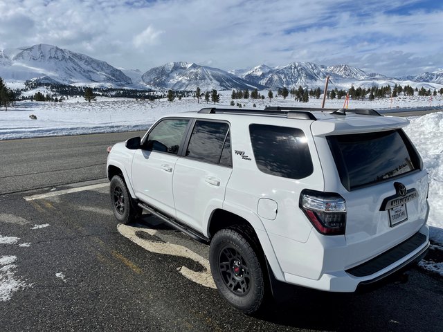

Got my IMS kit installed last week, and already out on the road. C59-300 in the front, C59-599 for the rears. I was going for a 2/1 lift.
Thanks again Mike!!

Quote:
Thanks again Mike!!
Looks great man, thanks for posting the photos!!
Man, that winter landscape also looks killer.

What size tires you running? Looks good 👍

stock 265s (Toyo ATIII)
