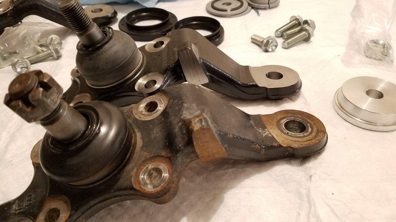

It will rust no matter what
This pic was taken with <1K miles on my 2020 ORP. I painted it black with enamel when installing the skid plate.

Quote:
I dunno what to tell you man, this looks like textbook 4runner AIDS. Frame will probably be rotted out within 6 months. Sorry bro.
That's normal surface rust those parts where bare steel the day our friends in Japan set forth your 4runner in to this mortal coil. The bolts are galvanized and the other stuff is aluminum. It's normal. Decay is a part of life, embrace it. I have a good example sitting here on my bench... the new one will rust as soon as I put it on the truck. Just think of it as wabi-sabi, not rust.
That's surface rust. Guessing they mill the parts after finishing? Ugly but doesn't require the attention of rust in a split seam or on the frame.

Quote:
You are so right--its part of life. I am not complaining, but just sharing my observation.
