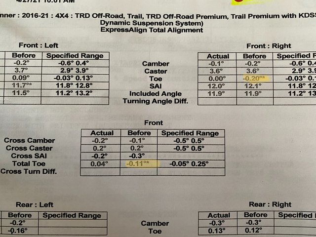

Attached are the alignment specs, do these numbers seem acceptable? a little surprised the tech had to consult the "Toyota hot line" for an alignment job, maybe the slight lift makes it an issue.

It is surprising ALL the original numbers were out of spec. Your new numbers look ok, but I am surprised the caster numbers are still on the low side.
My 21 Pro pulled to right when I picked it up. Dealer did alignment and found right front toe was out. Was fine after alignment. Here is my printout. And I’m pretty sure the pro does not have different specs as you can see by title of your printout, as well as mine.

Looks pretty good, I would like to be closer to 0 or slight negative camber, but not bad.
The before camber numbers really have me scratching my head though. -0.8 and +0.8?

How in the hell did you get +3.5 degrees of caster with stock suspension?
