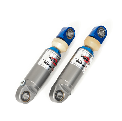

Quote:
Originally Posted by Furagwa View Post
Yes, I know the thickness is different between the stock and KDSS systems. Before I go through the hassle of converting to stock I thought I'd give my idea a try...
How tall are they? I have not looked into this, but i remember seeing a picture floating around here before of what the KDSS links look like. There is a few companies in the offroad world that make hydraulic/shock absorber style sway bar end links
https://www.proutvparts.com/cdn/shop...g?v=1625847234
Walker Links - Rear Sway Bar Shock for Polaris RZR XP 1000/Turbo by Wa – Pro UTV Parts
https://www.superatv.com/media/catal...3:1&width=1600
