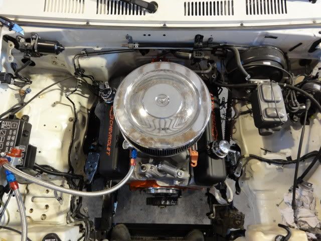

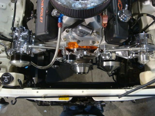

Might as well start with the engine. I decided a good ol 383 was in order for this build. I wanted goobs of low end torque with plenty of High End HP
Block:3970010 High nickel casting, most sought cast iron 350 block. This one happens to be out of a '69 Camaro (sorry Camaro guys) 4-bolt main.
Full forged, Full roller
Lunati rowdy idle bump stick (cam)
Cloyes adjustable timing gears, chain, and cover
Canfield monster valve aluminum heads (ported & Polished).
Weiand single plane high rise manifold (ported & Polished)
Proform Race 850 Carb
Sanderson Headers (Port Matched)
MSD Ignition (6AL)
March Serpentine Conversion

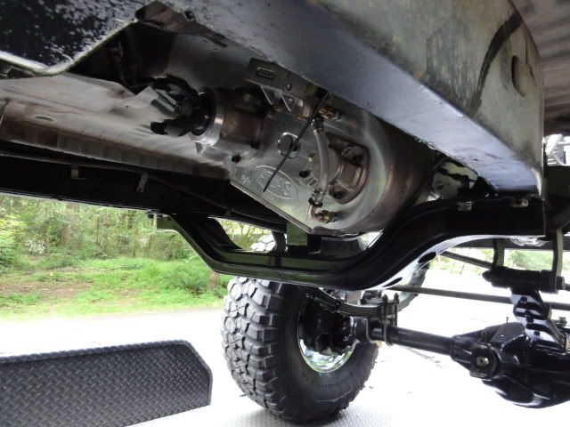

For powertrain conversion i went with Advance Adapters. I only used bolt in motor mount adapters for the engine.
I did have to "massage" the firewall very little. I had to dimple the hump right by where the A/C lines go into the firewall to give the passenger side valve cover some room. I also used Big Block motor mounts to get the engine alittle lower in the engine bay.

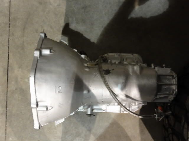

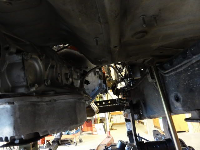

Now for the Transmission
This was a 2wd Th400 that I converted to a 4wd trans (replaced tailshaft and removed tail cone).
It has a full manual reverse valve body, all the moving parts are billet and kevlar, TCI torque converter, deep aluminum pan.
installed, this is about where the transmission will sit complete, as you can see there is plenty room all around... again thanks to the body lift. When doing a conversion like this make sure your transmission pan is level with the ground. alittle angle is ok but dont get crazy.

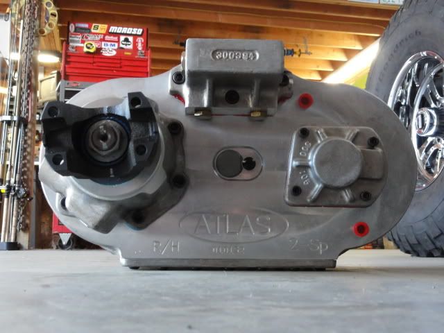

Next up is the T-Case
I chose an Atlas II because they are Bad-A$$ and are Me proof.
This one gets a Two-Speed 4.3 Case with upgraded shafts and 1350 1-Ton Yokes.
I used advance adapters Th400 to Atlas adapter since it is their T-case.
I had to clock the T-case down 25* to get it to fit. Even with the body lift there isnt much room for this hunk of billet.
I used a toyota 4cyl cross member and modified (more metal and welding) it to accept my new mount bushing.

OK now that i had breakfast.
Tires!
40x14.50R18 BFG Mud-Terrain KM2
Make believe test fit... i think they will clear just fine. That's me and i'm 6ft. flat to give you an idea.
Wheels are Ion Forged Thunder's 18x10 -25mm offset
If you look you will see the shackles are now flipped the right way.
Front wheels are on and back on the ground.
Time for a rear axle break down.
I chose a dana70U rear axle mainly because i have a really good friend in colorado that gave me one. It also has a smooth bottom for sliding off rocks and such.
This axle was actually a utility van dually axle out of a late 70's van.
I narrowed this axle 1" passenger side and 3.5" on the driver's side for another 61"WMS. 4.88:1 Yukon gears and a detriot locker.
Since the rear will be used the most i put 35 spine yukon chromoly axles in.
Since it wont be a dually anymore i did a disc brake conversion out back using 3/4ton chevy front calipers, caliper brackets from great lakes offroad, '76 ford dana 60 front rotors, machined the hubs 1mm to accept the rotors and pounded shorter studs in. End product, a disc brake single wheel dana 70U.
Another Riddler diff cover!
Next up Rear axle and spring mock up!
