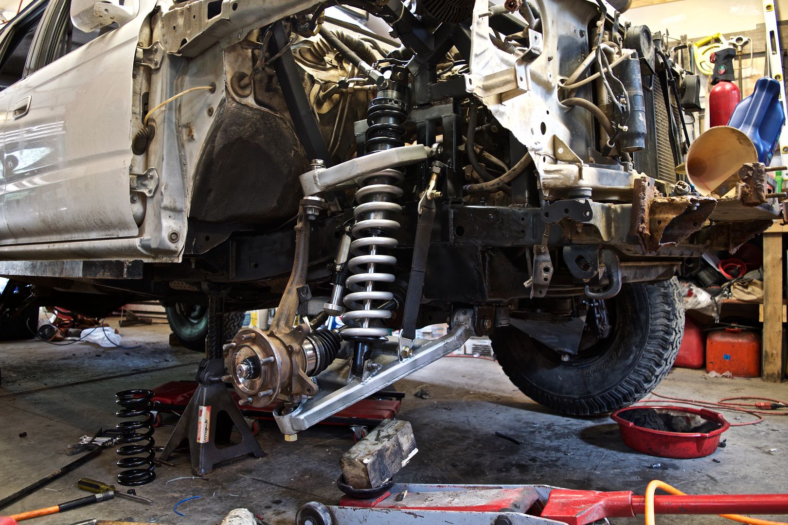

As college students who wanted LT @Cartzo and I made our own.
OP you can run a blazeland kit though which modifies your stock arms, it costs like a grand I think.
Mine, hopefully Cartzo will post his which looks way more sick.

@snivilous
On a side note, have you gusseted the spindle since the above picture? I know they usually don't have issues, but I've seen a handful of 4Runner, FJ, Tacoma spindles get tweaked at that thin portion on the top.

Quote:
Originally Posted by BlackWorksInc View Post
@snivilous
Not yet, my previous spindles were gusseted and I just haven't had time to get around to it. It's in the maintenance/modding queue.

Quote:
Holy balls! That's sick!
