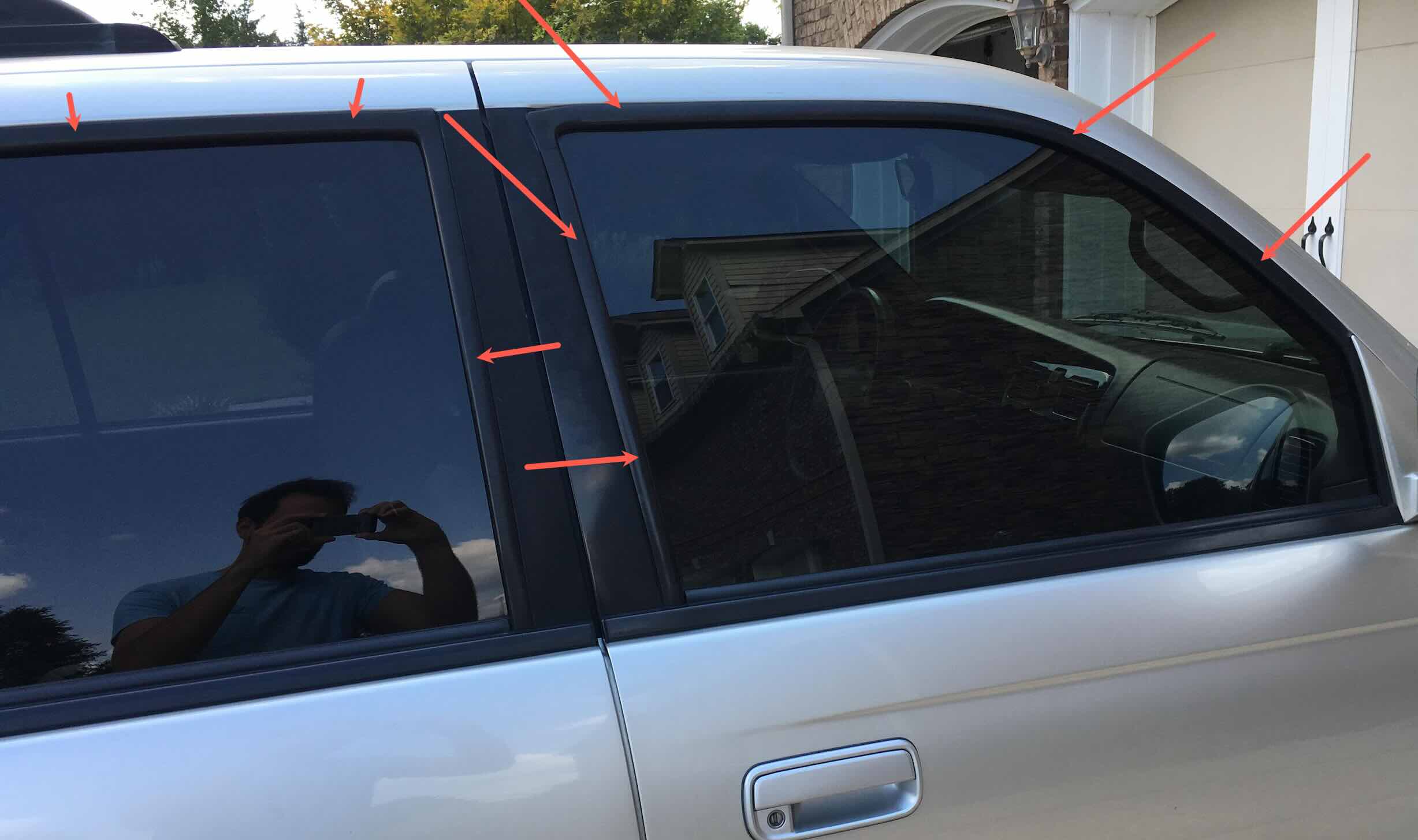

Does anyone know what this piece or pieces is called? I've replaced the bottom molding, and it looks and works great. However, now it's so much more noticeable how bad the tops and side pieces look.
I've attached a picture (this isn't my vehicle but just an example). Thanks for the help. Attachment 410043 |
It is rubber - what products have you tried for maintenance? Most OEMs now recommend some sort of silicone grease as the treatment/protectant for exterior rubbers.
-Charlie |

You need some sort of Rubber cleaner for these. Dawn actually works great to clean rubber. Follow up with some Silicone rubber dressing, buff that off, and you should be good to go. I never used anything special to restore these types of rubber. Just a good scrubbing with a sponge and dawn works great.

I'd recommend potentially using a clay bar like you would on car paint to clean them. This is a very very mild abrasive that should remove any contaminants that discolor it or use dawn and a sponge as others have said. Follow it up with a silicone grease or protectant to help restore it.
