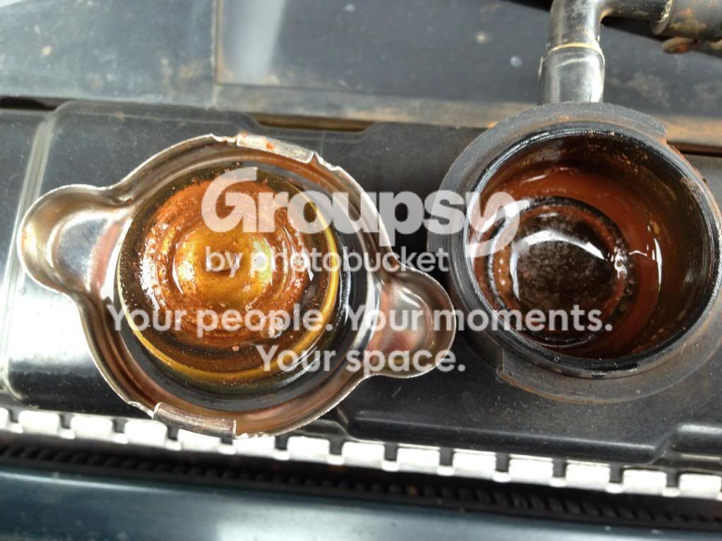

2Dragons 03-29-2013 07:26 PM
Okay, here's what it looks like.
http://i336.photobucket.com/albums/n...6.jpg~original
KidVermicious 03-29-2013 07:39 PM
$10 says that's rust.
Bad_Vision 03-29-2013 07:47 PM
That's solid rust man I think it's time to acid wash and replace the bypass tube and the lower coolant hose tube to be safe.
nicnmike 03-29-2013 09:09 PM
I believe there are flush kits out there that allow you to hook up a hose to your system. Maybe you could try taking out the thermostat, use the hose to do a constant flush and drain out of one of the drains on the block. This is with the engine off, of course.
TX_QtPi 03-29-2013 09:53 PM
Agreed. rust. Acid wash and replace the water pump n 2 hoses just for good measure if it's that bad.

2Dragons 03-29-2013 10:55 PM
The main question is, where are these "rusts" coming from then? Even if I replaced a new radiator or water pump, it will get like this in about 3 - 6 months. I need to find the source and fix that instead of the symptoms.
Bad_Vision 03-31-2013 10:18 AM
once again ill say it as i stated above!!! the rust is probably coming from the block itself and the only way to fix it is a acid dip.
youll need to replace all your hoses and you water pump and for good measure replace the heater core and the bypass tubes.
