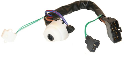

RAD4Runner 07-17-2014 01:12 PM
Quote:
Originally Posted by fourwd1 (Post 1751111)
If that doesn't do it you can disconnect the switch, the 2 wires for it have their own connector.
These two wires are probably the green ones here:
http://ecx.images-amazon.com/images/I/31MTDMXYFQL.jpg
However, I'm not positive because I could never find those wires in schematic. I see a light reminder relay on page 5 of 1988 4Runner schem but I do not see the buzzer nor key-in-ignition switch.
