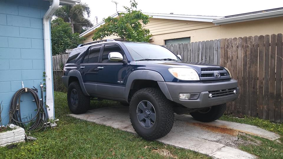

Meet "Pearl"
Attachment 284290 Bought this truck from a T4R.org member here in Florida and I like how he got 35" tires stuffed under this thing, from reading this forum no doubt. She's pretty fast, rides good and handles great. But, I want some V8 Long Travel! Califab, King, and Metal Tech LT medium springs w Wheelers Super Bumps are going in the back. It will be quite awhile and a lot of PBJ before I can afford the TC front kit w Kings. Pics are lacking for now. |

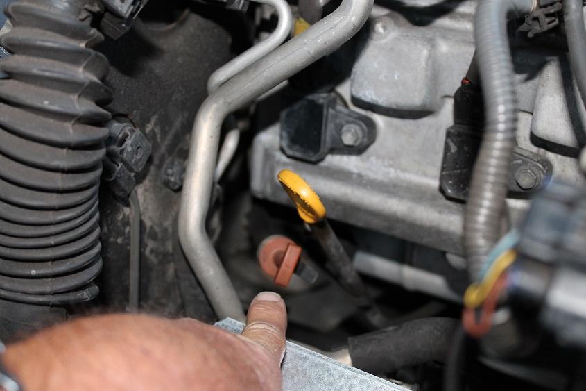

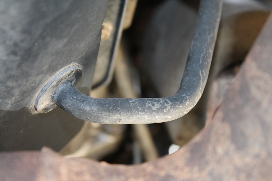

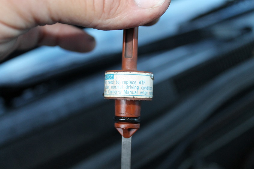

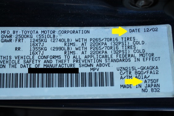

Forgot to mention "Pearl" has one of the few A750s with a dipstick. Stick says Type IV. That's one of the things I'm going to have serviced with a fluid exchange here soon. Attachment 284373Attachment 284374Attachment 284375Attachment 284382
Discrepancy on mileage in the carfax w ODO, so I already had the Aisin T Belt kit put in there just to be safe. Mechanic showed me the other belt and it was OEM and cf shows it was done at a dealer in JAX @ 90,176 miles. The writing is still pretty clear on the belt itself, so who knows if cf is correct. |

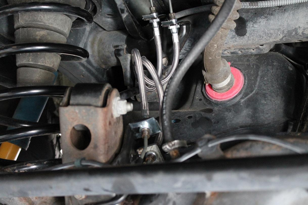

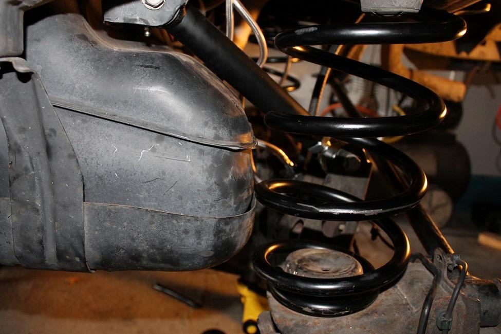

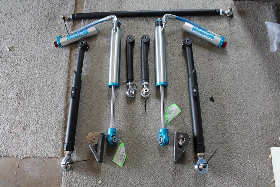

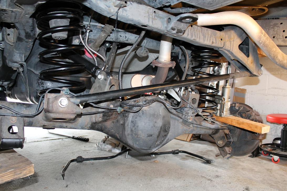

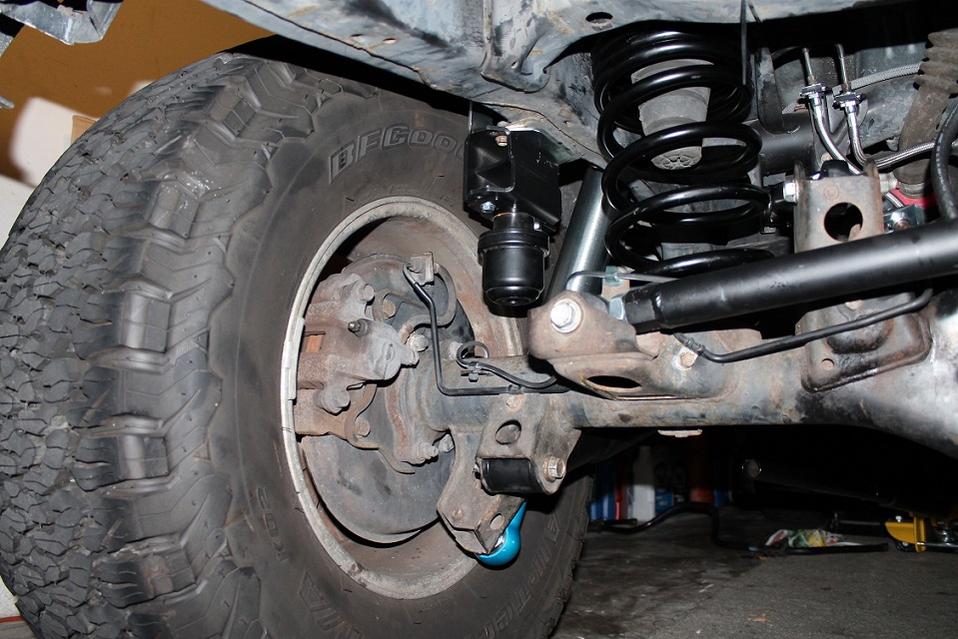

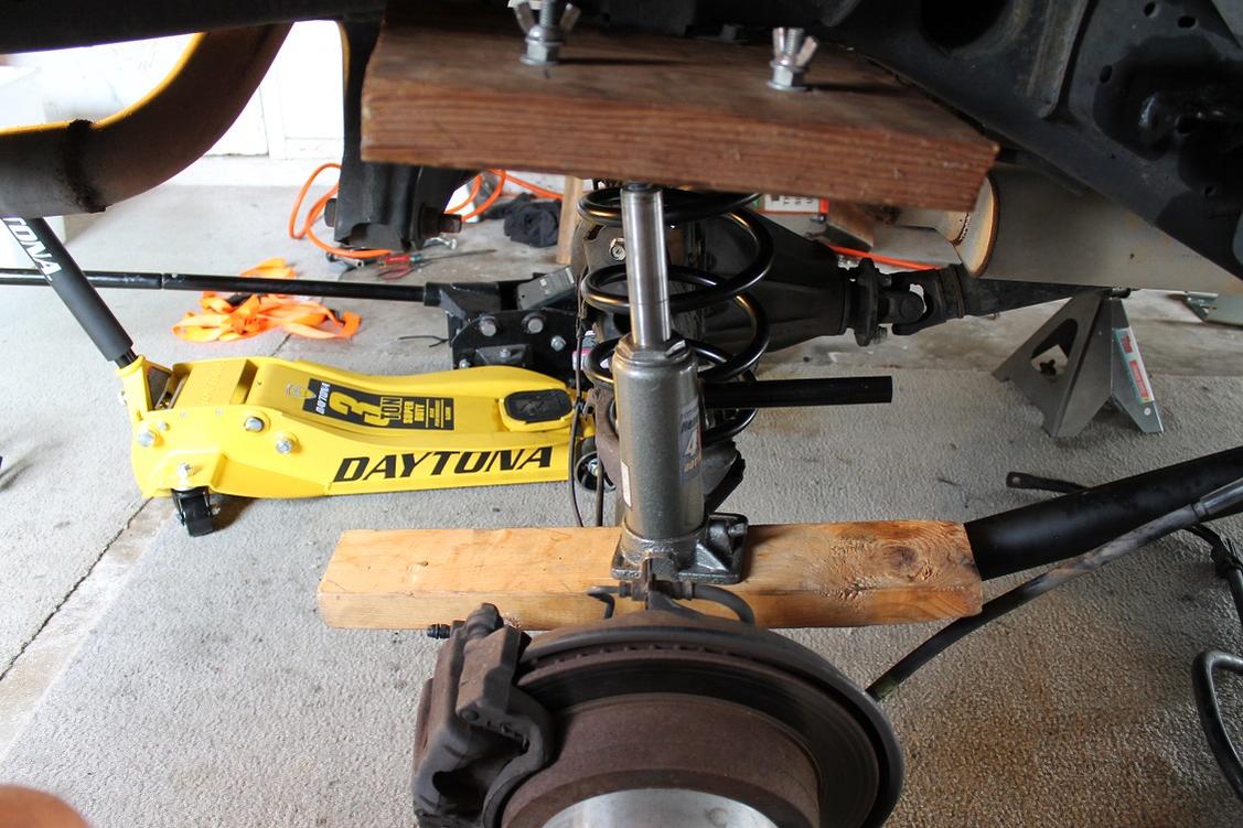

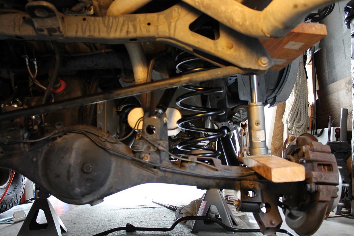

CaliFab and Metal Tech so far......checking my clearance Clarence. Metal Tech brake line extensions look good and ABS wires have some slack so they'll be ok. Drivers spring contacts the tank at full droop. Have to put a little length in the lower links and go from there. Front Coil Overs are being built with a Late May early June delivery.
Metal Tech rear spring contact
1 Attachment(s)
EDIT: I was WRONG....No more clearance issues!
Sorry about that. Apparently the Kings I'm installing aren't as long as I thought. They stop well short of any bind. I was big time wrong on this one. CaliFab offset links still have some travel left tho. Already wondering about going longer........ I've done some research today with no luck so far. I've been cycling the suspension without shocks to make sure of any issues. What I found is the axle needs to move aft to clear the driver spring on the tank. Driver side spring is marked with a "D" and installed on that side just to clarify. @Inv4drZm , @t-man , @rickashay any advice and ugh...criticism lol would be greatly appreciated. So here is my question: I'm wondering how much extension the drive shaft slip yoke can handle and I'm also still learning about pinion angle and if I should be concerned with that. The CaliFab heims have a good bit of adjustment with plenty of shank inside the link for strength so that part should be OK. I moved the axle 1/4" over stock length and I still have some contact and a little bit of droop left on the CaliFab links. I plan on limit straps but would like to get full down travel before I do that. Attachment 292437 |
Quote:
Some adjust their link lengths to fine-tune their pinion angle but IMO you are still using factory geometry and I'm not sure how much you can really change it without getting too crazy. You would need to lengthen the upper links and ideally shorten the lowers but with your lowers already threaded out 1/4" it may not be possible to do much. |
1 Attachment(s)
Quote:
I am thinking about moving the upper shock mount an 1" higher for more up travel. Waiting to see how the Super Bumps and MT extensions make contact as well. Attachment 292683 I do like speeding down power line and fire roads, and there aren't a lot of obstacle/articulation trails near me. My family has settled in AZ so I will be out there hitting some desert one day. Thank you very much for hittin me back tho!! Probably be picking your brain more in the future. |

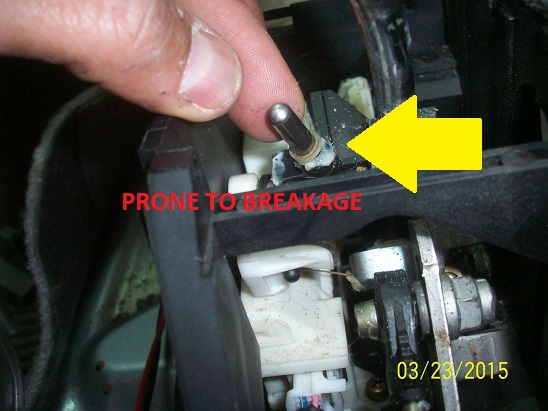

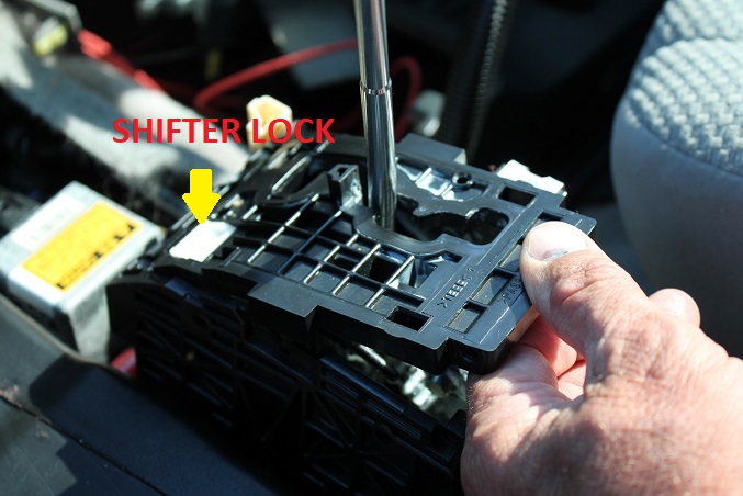

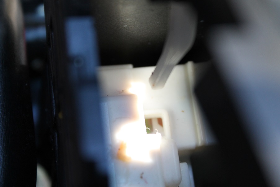

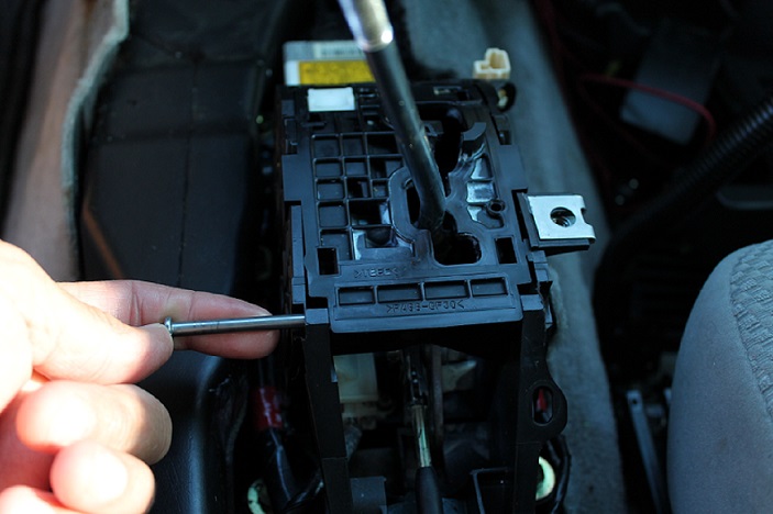

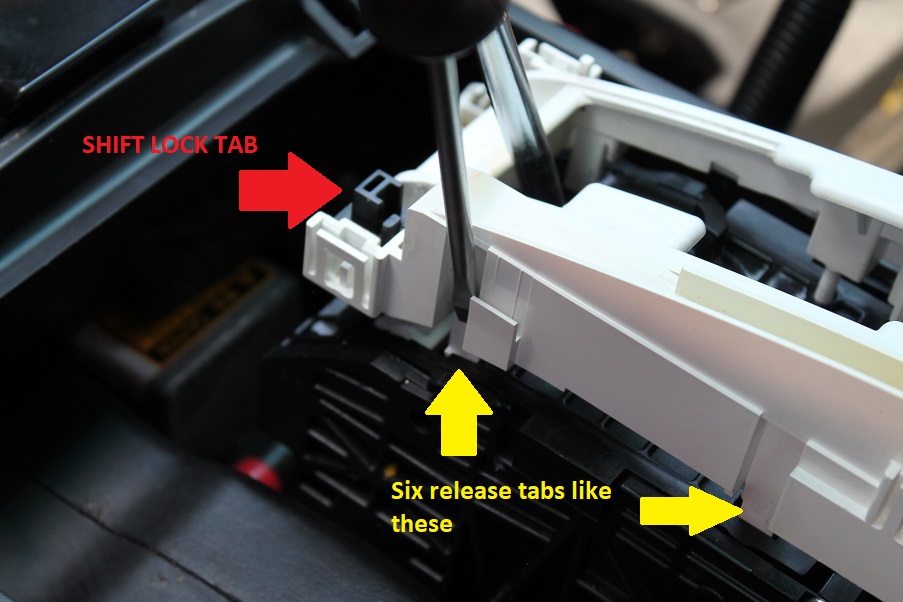

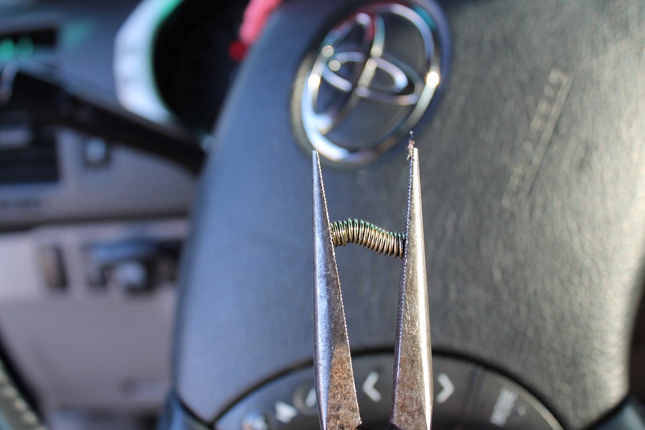

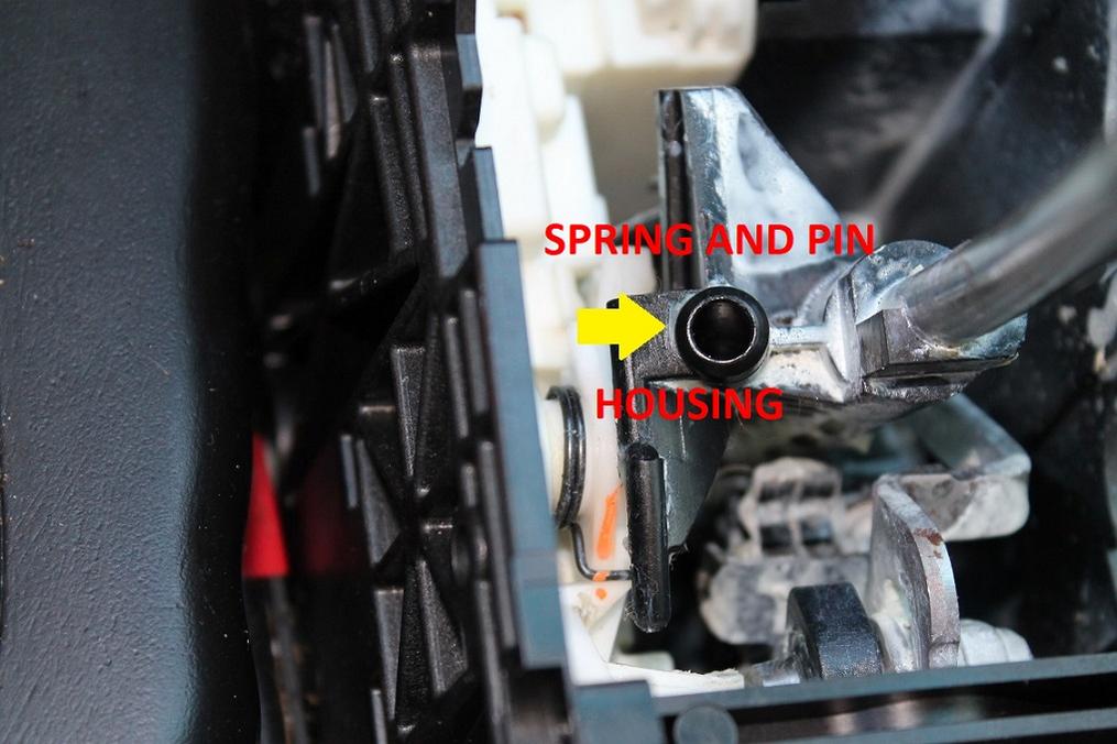

Attachment 295288 Having been through a couple threads on the matter, I landed on this from 2010 and it had been bumped recently. http://www.toyota-4runner.org/4th-ge...y-shifter.html I found through other peoples trial and error, that the housing that holds a pin and spring loaded system to keep tension on the underside of the shifter guide plate, usually breaks after years of abuse and especially when people force a stubborn shifter. So I have a small step by step from the point at which you get the console removed, which is not difficult at all. Here is a link to some schematics of the fasteners. All you need is a couple of small flat blades and a pick maybe. Most of these Toyota panels pull right out and pop right back in. https://www.top4runners.com/ja/2007/footwells.html My first step is simple: Unscrew your shifter KNOB and remove the small plastic cover that has the gear selection on it. It has four release tabs usually can be done with your fingers. Attachment 295278 Then remove the small white cover underneath that. Small flat blade may be needed. I think there are six release tabs and a small shift lock tab that will need to removed. Attachment 295295 Then your gonna use your small flat blade maybe 2, and work this retaining clip off the pin it sits on at the top rear corner of the shifter housing. Attachment 295282 It looks like this Attachment 295285 Then you remove the pin Attachment 295290 Now when you lift up on the guide plate, there are two guide tabs at the front, so pull back and up being careful not to break the shifter lock release button, it's spring loaded and has a small tang that sits down on top of the release mechanism. Moving the shifter forward or backward as you lift may help. Next slide please..... Attachment 295286 Attachment 295292 |
Shifter Maintenance- avoiding the wet noodle shifter
5 Attachment(s)

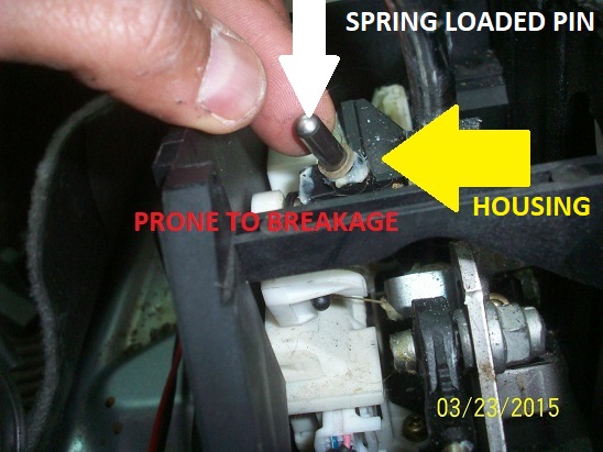

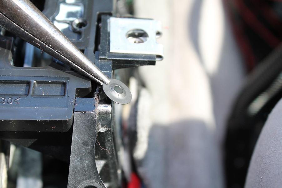

Now when you lift up the guide plate make sure the pin isn't stuck to the underside of the plate. The grease gets viscous and sticky and the pin will pop out. If it did it should be right in that general area.

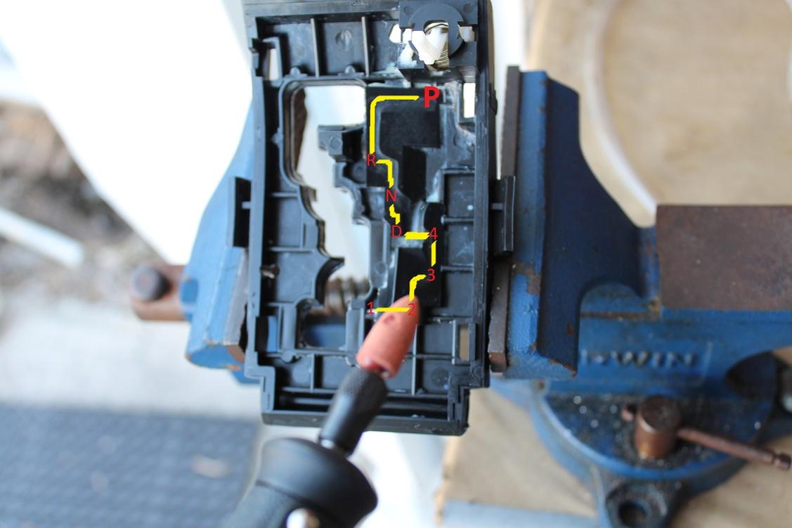

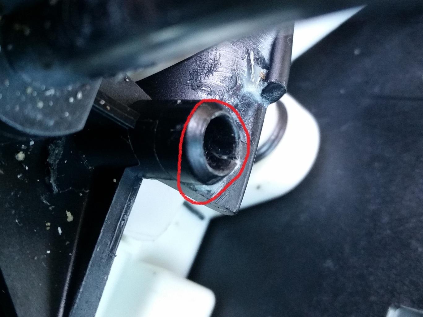

Attachment 295297 Now here is a close up of a cracked housing, so make sure you give yours a good inspection. Stole another pic thanks @ExpeditionBill Attachment 295298 Mine looked good so I started looking for solutions to avoid the broken shifter syndrome. Attachment 295300 Now some people have cut a coil out of the spring to ease some of the stress on the pin making contact on the underside of the guide plate. This may work for you, but my shifter was fine P thru D, so I didn't want to change that. What I did was press the spring together with some pliers to collapse some of it's strength. Attachment 295301 Then I studied the path on the under side of the guide plate where the spring rides. You can see (not that great in my picture) there are little hips and valleys that this pin rides in to lock itself into each individual gear. Mine was stiff between 4th and 5th and almost impossible from 3rd down to 2nd. So my solution was to Dremel out a couple thousandths of plastic out of these hips in the troublesome areas and put it all back together. I has really helped 4th to 5th, but 3rd down to 2nd is still a little sticky so I will take a little more plastic off at a later date. At the cost of what I heard a new shifter can be, I hope this helps some folks prevent "THE SLOPPY SHIFTER SYNDROME" PS if it's already broken @TeryT has a brilliant and simple solution using a rubber band and a washer http://www.toyota-4runner.org/4th-ge...shifter-2.html (Post #27) to keep his in 4th when he's towing. EDIT: 9/30/18 Shifter was still a little stiff so I went back in, cut a half of ring out of the guide pin spring and took a little more of the guide track with the Dremel. I'm concerned about cutting too much off the spring and the guide track, so I'm taking very small increments out. Still a tad sticky going from 3rd down to 2nd but I want a little resistance there for dropping down into 2nd as you can easily drop too far into 1st and possibly do some damage. |

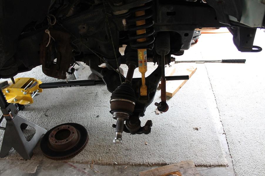

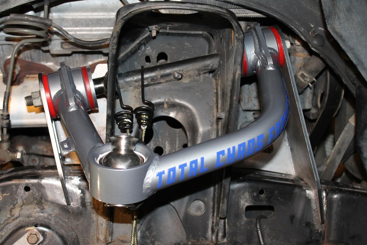

Spindles removed for gussets - Start of the TC Dual Front

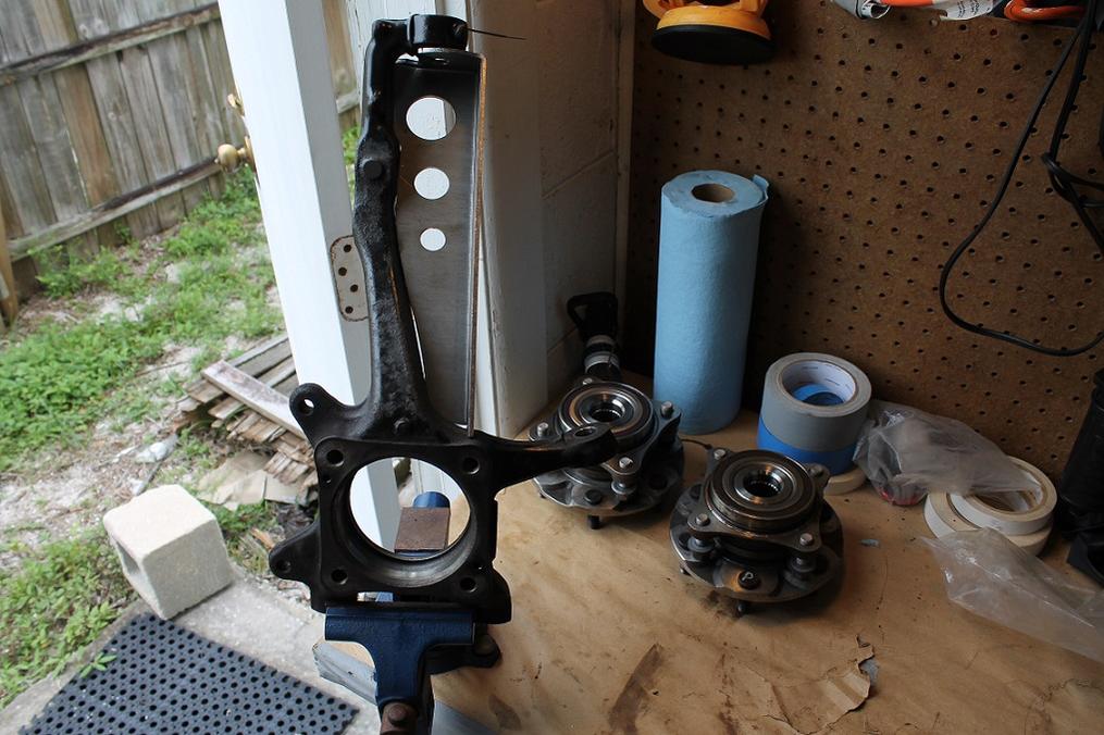

3 Attachment(s)

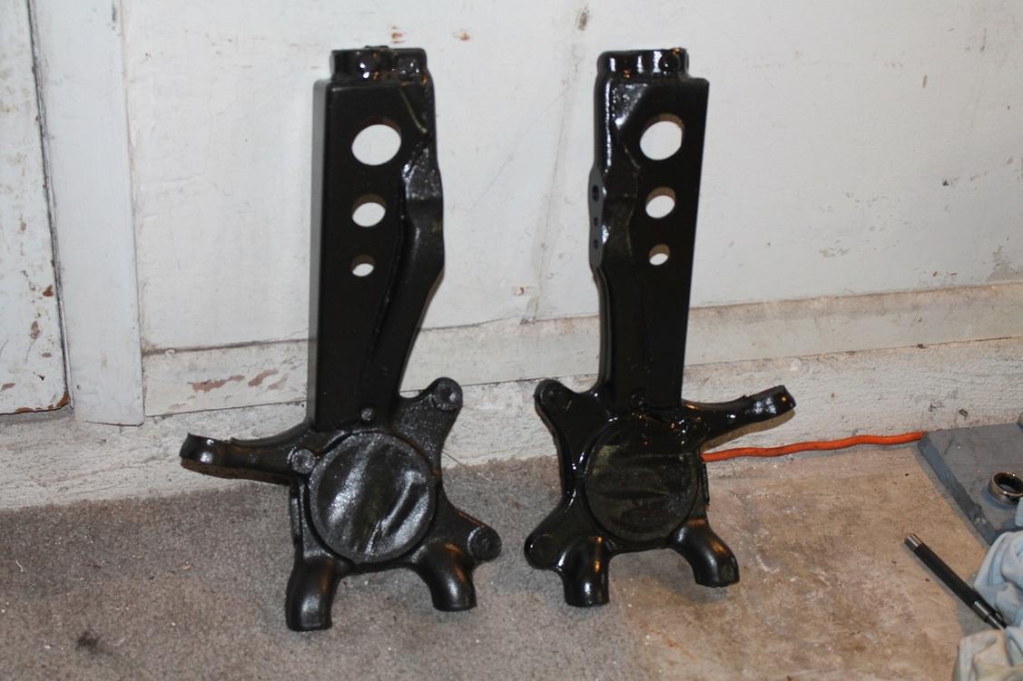

Pulled the Spindles this morning and dropped them off at a local welder this afternoon. Heat index is killing me today. Plenty more to do but I'm taking the Siesta for now......

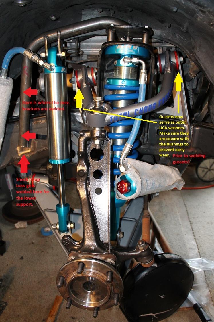

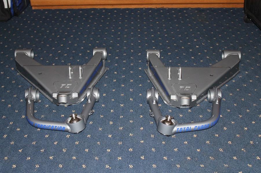

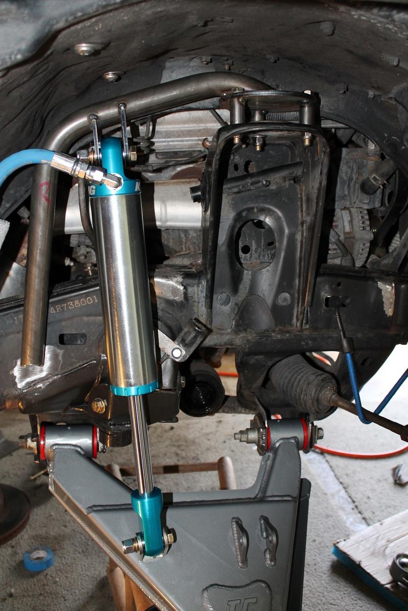

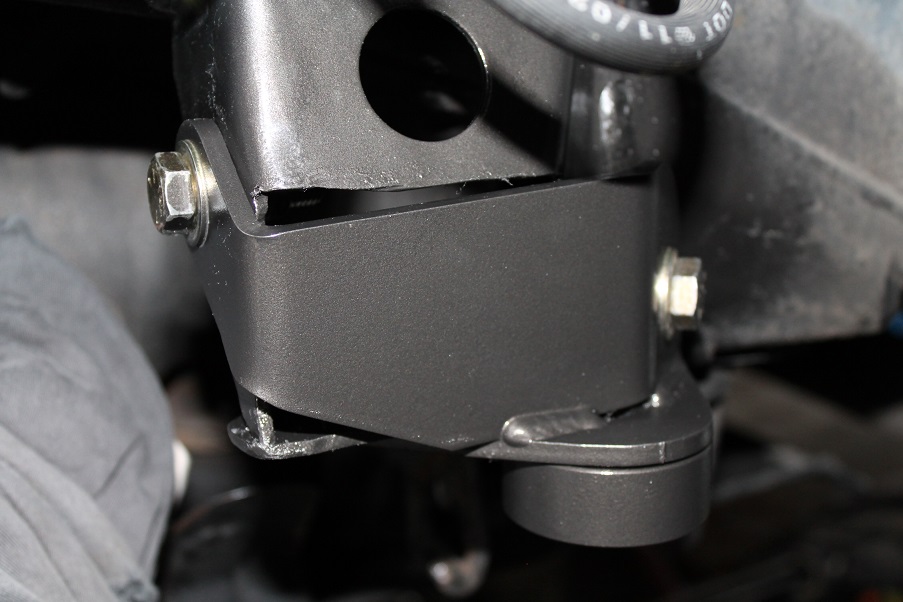

TC Dual Front Con't-Bump stop repo

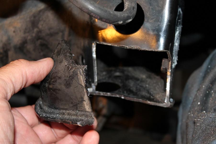

3 Attachment(s)

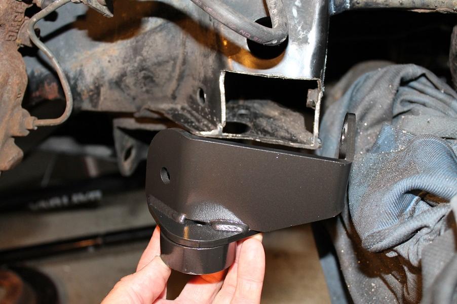

I haven't been on my angle grinder in awhile....scared me. Gettin it done though. Pretty much used up a new 4.5" Home depot diamond blade on both horns. Not the easiest thing I've ever done and it ain't like this was a big deal. Just a little cutting lol. Good Fabricators have got some real passion for they're craft because a lot of this work ain't fun. Attachment 301329
Here is the TC repo bracket painted and ready to be bolted up. You can see how the fitment needs to be. It's not easy marking a cut line for this job. I took some measurements, made some reference lines with my speed square, then eyeballed the rest lol. I have to clean up the rough edges and paint on this passenger side. Attachment 301330 Here is the driver side all bolted up and painted. Didn't butcher it too bad I guess. Attachment 301331 |

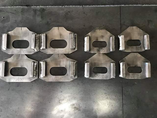

1 Attachment(s)
Outta town working so I sent my cam tab gussets over to my buddy Tim at Timbo's Customs in Auburndale, Fl. to get em welded up. Still a long way to go.....Damn I wish I'd learned how to weld.
