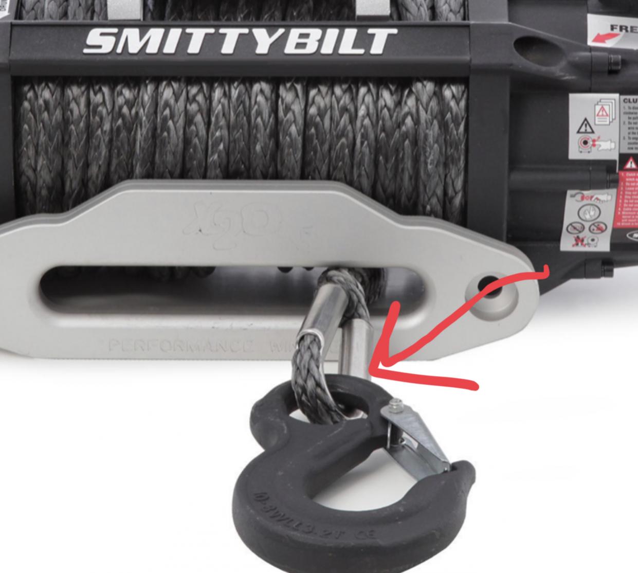

Can the stock hook on the SB x20 be swapped out for a Factor 55 flatlink? It looks permanently attached from the pictures?

You cut the hook off.

Got it..pretty straight forward! Looks like the x20 will work with the SSO hybrids as well.

There are few good youtube videos that show you how to use the tool and rethread the rope once you install your attachment. Super easy!!

Im running a Smittybilt X20 10k as well. I had my mechanic buddy cut my hook off with the air grinder and added a a factor 55 flatlink. Ive used the winch twice for recovery it is a beast for the money

You can also unthread the eyelet if you didn’t want to destroy that hook or don’t have a grinder. The flatlinks have a sliding pin to hold that eyelet. The splicer link and others have to be hand threaded and then the tail gets braided back into the line
