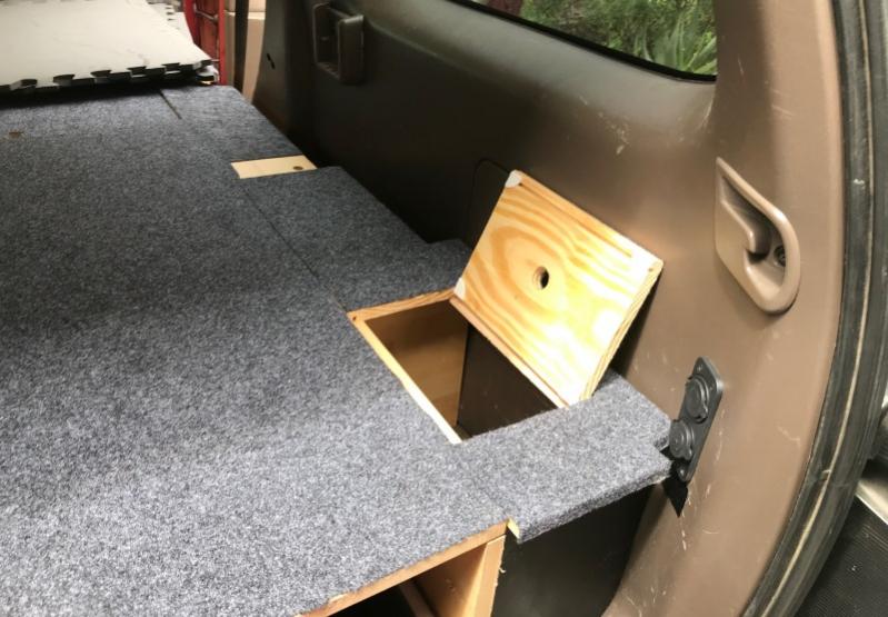

1 Attachment(s)
Did this when I was building out my rear sleeping platform. Wanted a 12V cigarette plug and USB.
I didn't use the stock 12v outlet but same idea. You can tap into the 12v positive from the rear roof light and ground anywhere. I've run air compressor on it but if you're looking for more juice then I would go with TheDurk's suggestion.
