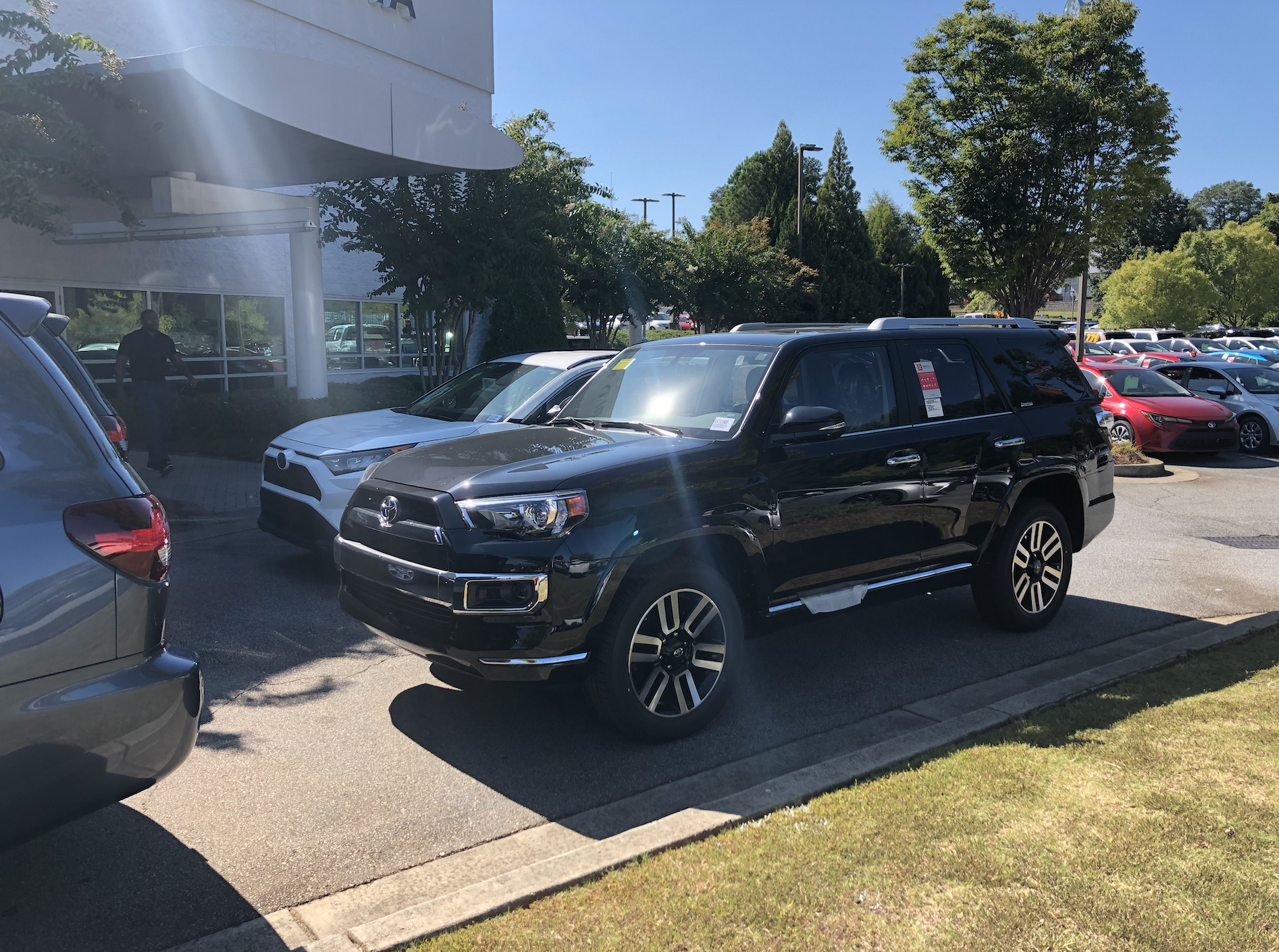

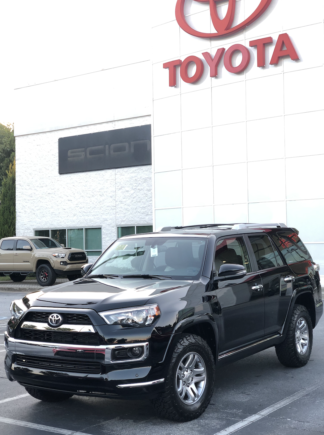

Ok, now that we've set expectations: Hey all - and welcome. I've been active here for years but figured now might be a good time to create one place to consolidate the information and pictures about my new (for now) 2019 Limited 4x4. Yeah, I know you've seen plenty of them around and this one probably won't strike you as special, but that's alright. I'm still going through break-in right now but have already purchased the TRD CAI and Borla Touring exhaust for installation ASAP. I think I've read the TRD CAI installation thread some 6 times, every post on every page, and I finally decided to go for it. Even if the performance/MPG gain is negligible, I like that this intake adds some acoustic character to the engine and I'm willing to give it a try. My plan over the next few weeks is to run and share the results from three dyno tests: Round 1: Stock Round 2: TRD Intake Round 3: TRD Intake + Borla Touring exhaust I'll post the outcome of my runs here in this thread. I'm really curious to see if I can replicate or get close to the +5whp and +19lb-ft of torque that TheWraith saw with his TRD intake alone. I've seen many folks talk about butt dynos, or what does and doesn't actually add power, but very little actual proof. My hope is to shed a little more light in the realm of tangible performance changes, whether good or bad. I've had a 3rd gen, 4th gen, and am now on my second 5th gen. We were a 4Runner family growing up and owned many 2nd and 3rd gens, so 4Runners run in the blood. My parents still have two 5th gen 4runners (a 2018 Limited and a 2019 SR5, with a 2020 Limited on order), and we've got a Highlander on the other side. Toyota all the way around. Last week, I traded in my 2016 Limited 4x4 Black/Redwood for a 2019 Limited 4x4 Black/Redwood because of lingering suspension noises and concerns. I was in a minor accident a year ago (<20mph merge situation) and ever since then, my hood stops were working their way down and making the hood squeak (despite screwing them upwards), and then I had a suspension creak/clunk/knock whenever I turned left and the weight shifted. So, with only 29K on the clock, I opted to just trade it in and start fresh. I had to order the exact combination that I wanted, and there were slim pickins with no more 2019s in production. Hurricane Dorian further complicated things shutting down the port in Jacksonville as well as South Carolina, which is where my backup option was on the lot at Sparks Toyota. But eventually, my dealer called and said, "It just came off the truck. Come check it out!" https://i.lensdump.com/i/0OxRLe.png The build sheet listed "LED Fog Lights" and I originally thought it referenced the port-installed Auer Automotive LED DRL fogs, which I did not want. However, I was very pleased to find the LED Fogs from the Tundra and TRD Pro 4Runner: https://i.lensdump.com/i/0Oxkkx.png My 2016 wasn't really modified, but it did have: - 17" Sequoia/Tundra wheels - 265/70R17 KO2s, Load Range C tires - TRD Skid Plate - Cross bars / chrome exhaust tip ... and I asked for those things to be swapped between old and new. Old in front, new in back - going in for surgery: https://i1.lensdump.com/i/0OxtiQ.png https://i.lensdump.com/i/0Ox19a.png Post swap: Old on the left, new on the right: https://i.lensdump.com/i/0OxIrq.png So this is how I left that night, with everything swapped over and starting over at 3 miles on the clock: https://i.lensdump.com/i/0OxZ4A.png https://i1.lensdump.com/i/0OxTak.png .... are you bored yet? |

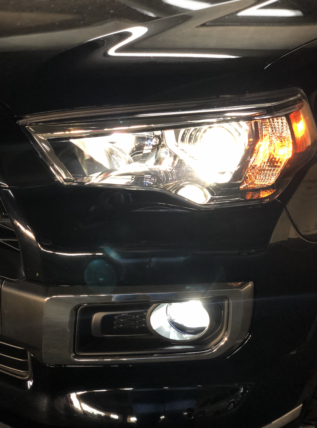

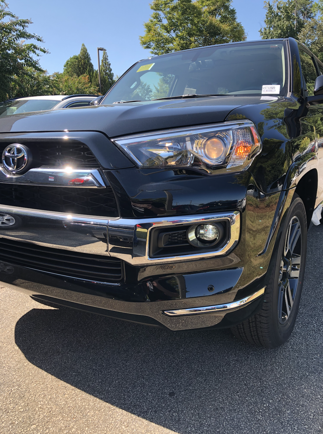

So, as it goes, nothing stay's stock-ish for very long. I broke down some things off my 2016 before trading in, and the first thing I couldn't wait to do was install a HID kit. So I went immediately home and installed a new
@XenonDepot

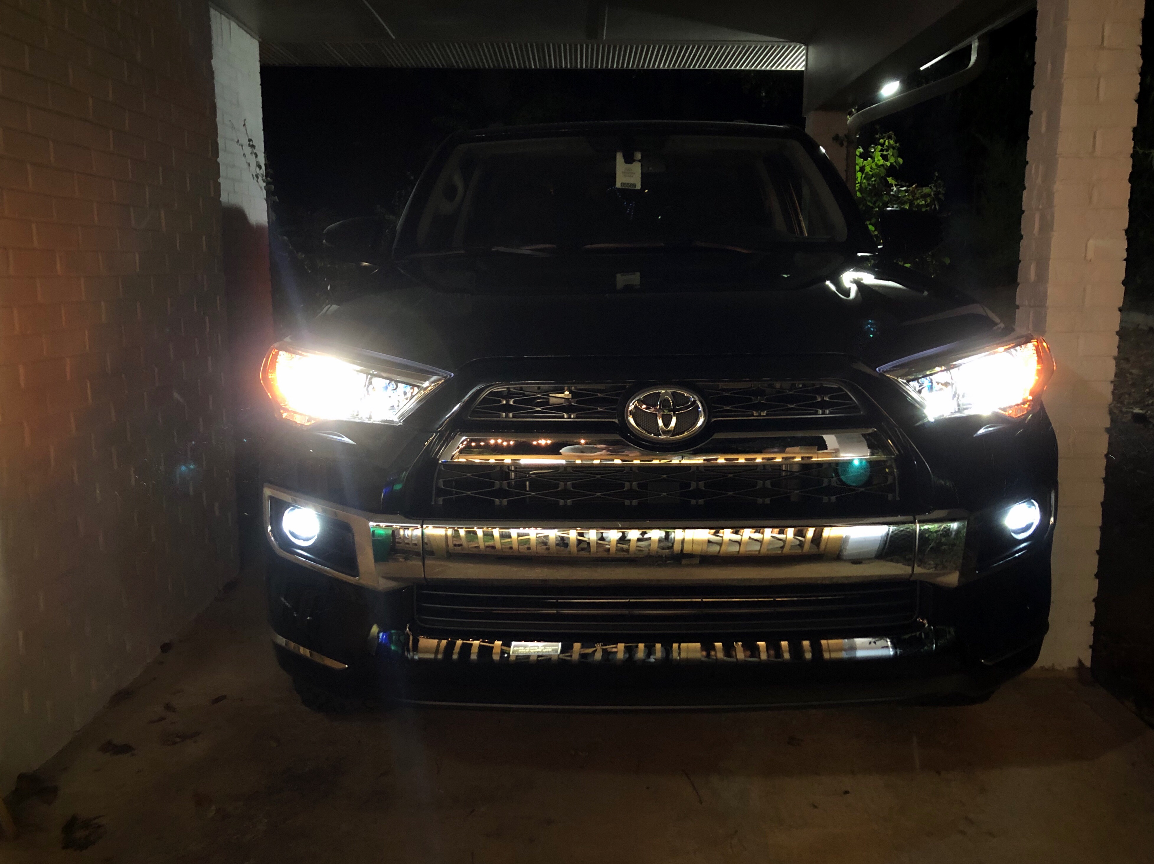

Extreme HID kit with Philips ballasts. 4300k, because that's what I had before, and I had great luck. There's definitely a bit of a color discrepancy between the low beams and the TRD Pro fogs, but this combination throws a ton of light on the road, so I'm happy with that. I also replaced the DRL/High beams with Osram Nightbreakers - same as I had before, and lots of luck.

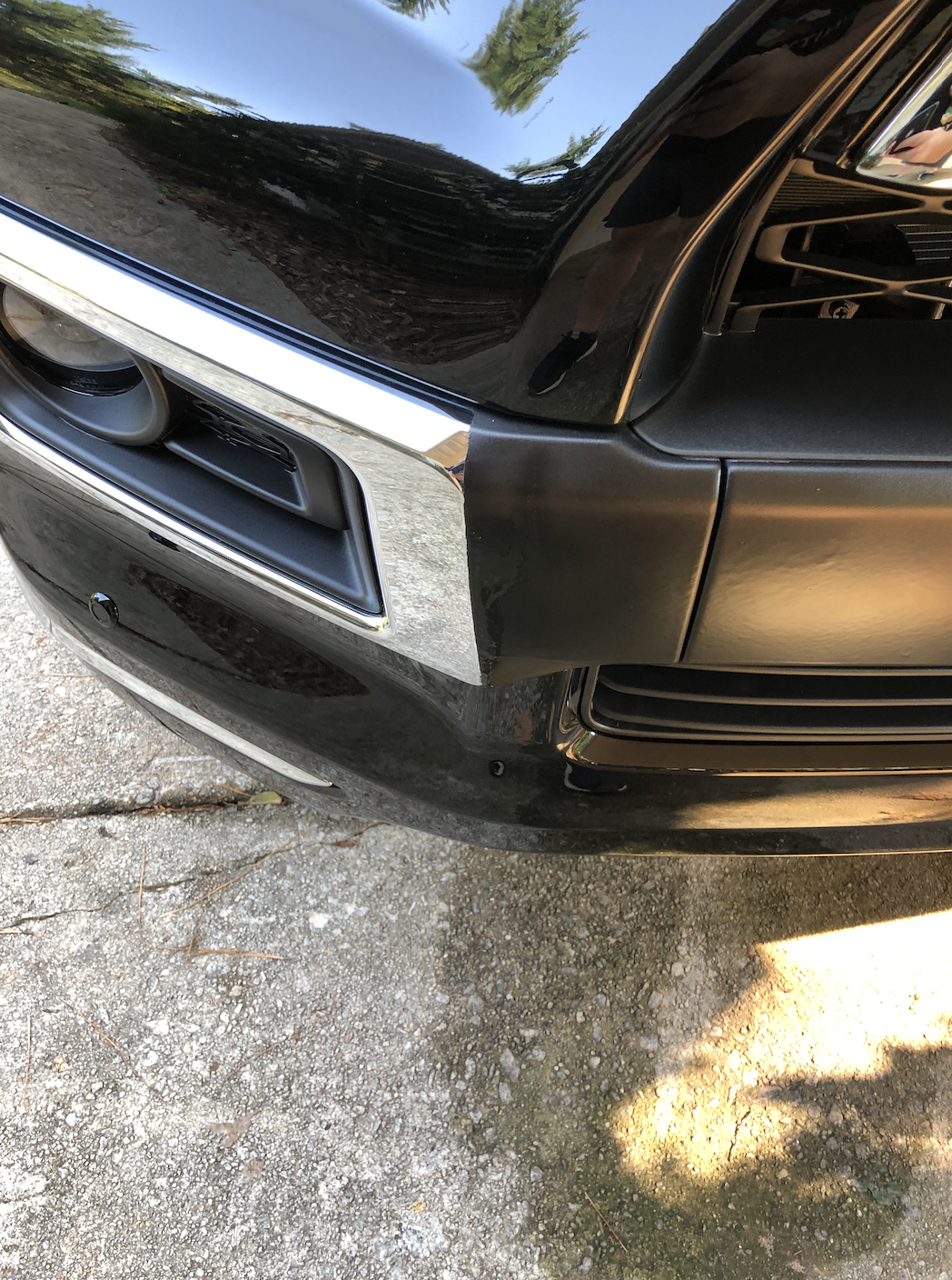

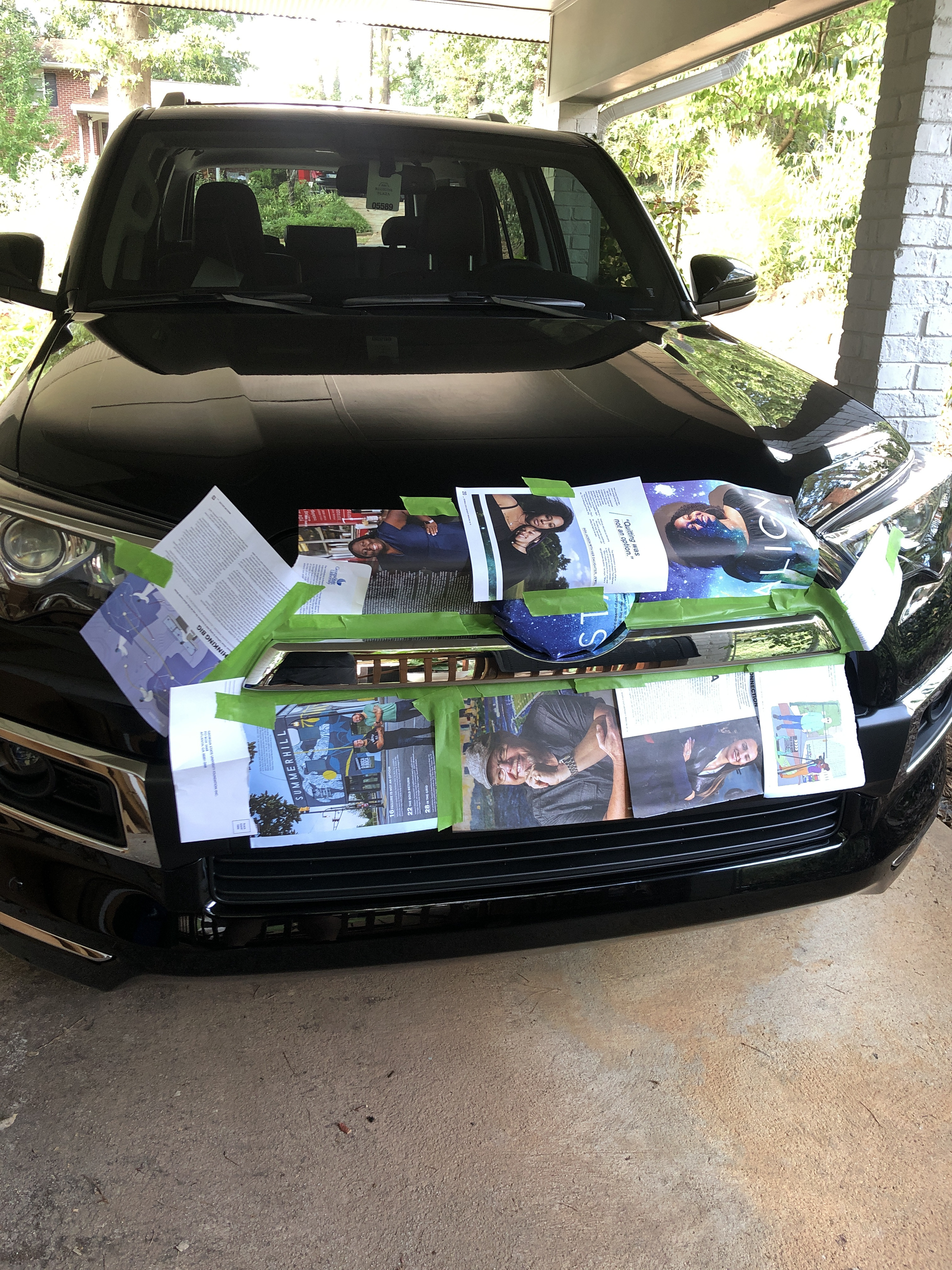

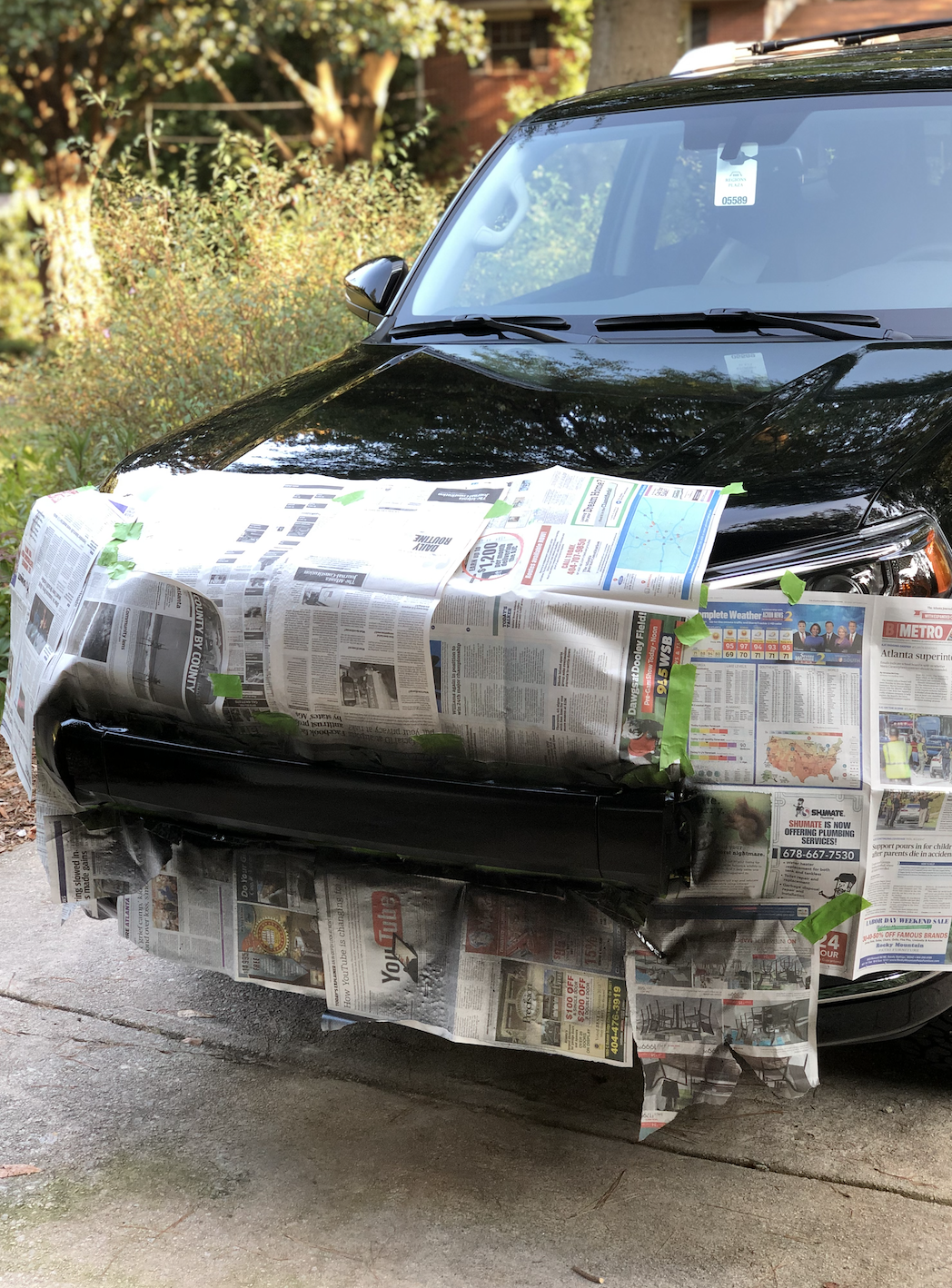

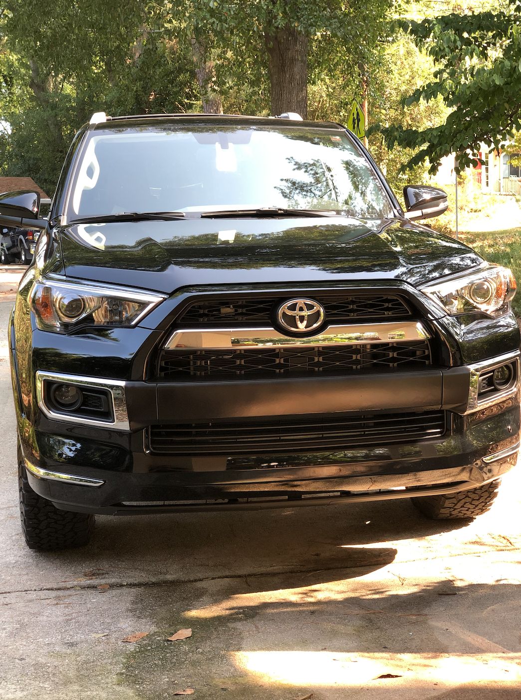

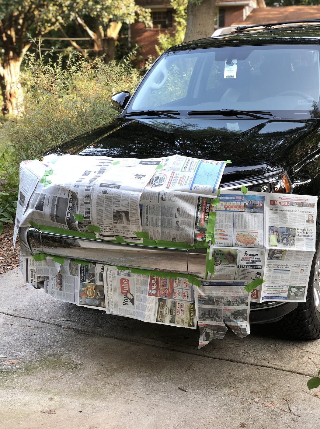

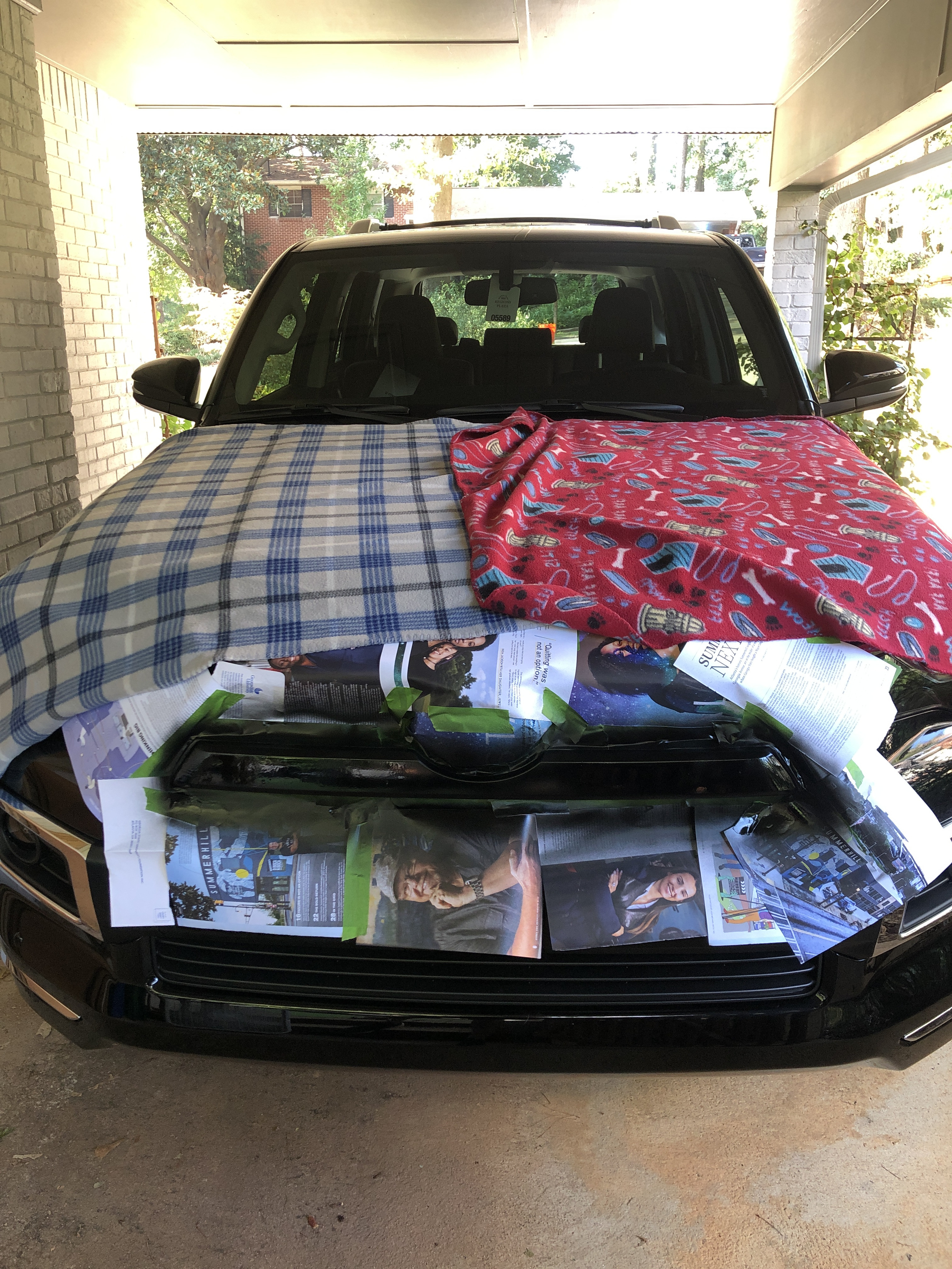

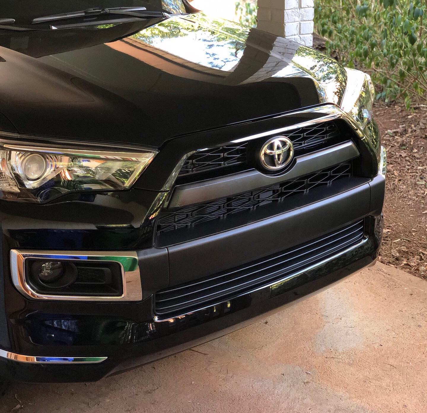

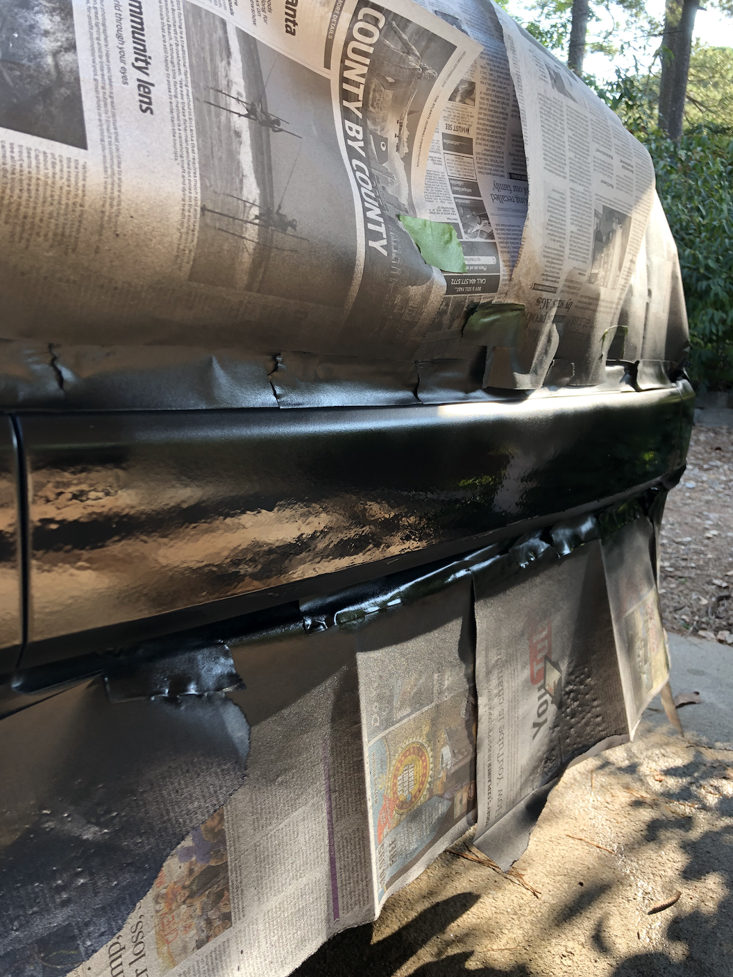

Yes, I immediately leveled the headlights and then angled them down. https://i1.lensdump.com/i/0OwP9i.jpg https://i1.lensdump.com/i/0Owfvo.png Fogs really do have a very nice, clean cutoff. Kind of Lexus OEM LED-ish on the road. https://i.lensdump.com/i/0OwNWm.md.jpg5 And then it was time to LED-ize the interior. I've had the best luck with Philips LED bulbs, so that's what was used: https://i.lensdump.com/i/0OwvH1.jpg And then... it becomes time to de-chrome some of the front end. I've read some folks saying their vinyl wraps don't stick as well as plasti-dip, and I had great luck with plasti-dip before, so that's what I did again: https://i1.lensdump.com/i/0OxjXD.png0 https://i.lensdump.com/i/0Oxil0.png Fedex man showed up in the middle of it with a little gift: https://i.lensdump.com/i/0OXCX5.md.png https://i.lensdump.com/i/0OxWk3.png https://i1.lensdump.com/i/0Ox8GF.png https://i1.lensdump.com/i/0Ox2Lr.png https://i.lensdump.com/i/0Owh97.png https://i1.lensdump.com/i/0Ow5NT.jpg https://i1.lensdump.com/i/0Owy3z.jpg ... really happy with the final product: https://i.lensdump.com/i/0OwbXC.jpg |

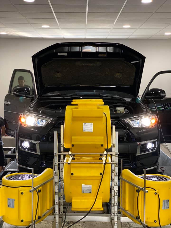

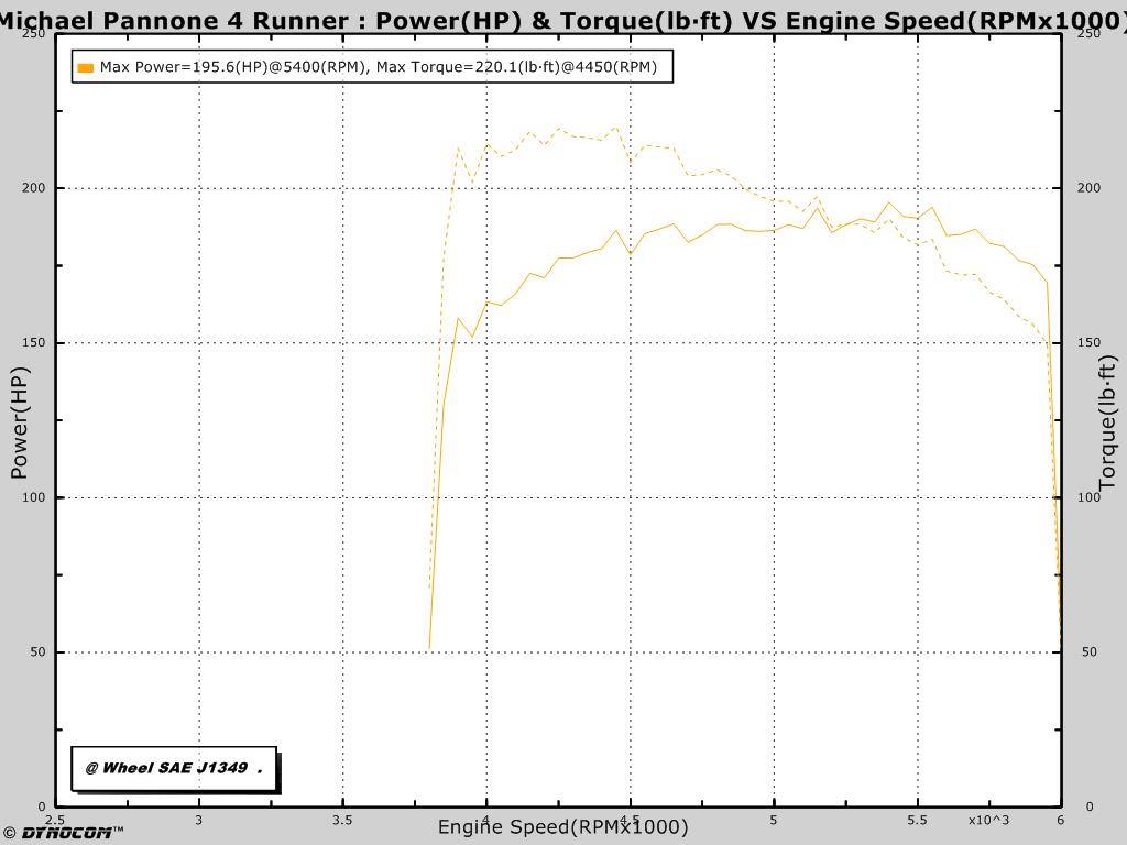

Base dyno run complete:
2019 4Runner Limited 4x4 77 Degrees F 70% humidity 93 Octane Max horsepower: 196hp @ 5,400 RPM Max torque: 220lb-ft @ 4,450 RPM https://i.lensdump.com/i/0Ocosb.jpg https://i1.lensdump.com/i/0OcLcz.jpg YouTube footage (hey, the 1GR sounds better outside than it does inside!): <iframe width="560" height="315" src="https://www.youtube.com/embed/GYugD5IvFbE" frameborder="0" allow="accelerometer; autoplay; encrypted-media; gyroscope; picture-in-picture" allowfullscreen></iframe> <iframe width="560" height="315" src="https://www.youtube.com/embed/Qm6Fc6sWE0c" frameborder="0" allow="accelerometer; autoplay; encrypted-media; gyroscope; picture-in-picture" allowfullscreen></iframe> |
Second dyno run complete:
https://i1.lensdump.com/i/0OcYgT.jpg TRD Cold Air Intake and Borla Touring Exhaust 48F 50% humidity 93 octane Smoothed results (all runs averaged together): Max Horsepower: 209.6 hp @ 5,350 RPM Max Torque: 237.4 lb-ft @ 4,150 RPM Compared to stock, that is: + 18.3hp + 19.5 lb-ft of torque NOTES YOU NEED TO READ: 1) The results I posted above for my first run were the numbers from the best run, but the average/smoothed numbers were 191.3hp @ 5,550 RPM and 217.9 @ 4,150 RPM. This number for the second run is only the smoothed/average number. There was one run that was as high as 212hp and 240 lb-ft, but most were 208-210hp and 236-238 lb-ft. 2) Take a look at the temps. They make a difference. The day I did my first run, it was 77F and 70% humidity. The day I did this run was 48F and 50% humidity. I asked the tech who helped me how much of a difference he thought the temps made, and his assumption was 30-40% boost. If you factor that in, the real increase in performance with the TRD intake (assuming a 35% boost due to temps) would be: +11.9 hp + 12.7 lb-ft of torque So you'd have roughly 203.2hp and 230.6 lb-ft of torque if the temps were the same on my second run. 3) The piping on the Borla Touring exhaust is the same as stock, so I do not assume it had any performance impact and credit the TRD Intake for any changes. Video - I'll post the chart in my next post: <iframe width="560" height="315" src="https://www.youtube.com/embed/3mGw7hc1hEY" frameborder="0" allow="accelerometer; autoplay; encrypted-media; gyroscope; picture-in-picture" allowfullscreen></iframe> |
Third dyno run complete:
https://i.lensdump.com/i/0OcuD7.jpg TRD Cold Air Intake, Borla Touring Exhaust, URD MAF Calibrator 48F 50% humidity 93 octane Smoothed results (all runs averaged together): Max Horsepower: 211.1hp @ 5,300 RPM Max Torque: 238.4 lb-ft @ 4,150 RPM Compared to stock, that is: + 19.8 hp + 20.5 lb-ft of torque Compared to just the TRD Intake and Borla Touring Exhaust, that is: +1.5 hp + 1 lb-ft of torque NOTES YOU NEED TO READ: 1) Remember that these numbers are smoothed/averaged. There was one run that was as high as 215hp and 242 lb-ft, but most were 210-212hp and 237-239 lb-ft. 2) Take a look at the temps. They make a difference. The day I did my first run, it was 77F and 70% humidity. The day I did this run was also the same run that I did with the TRD Intake and Borla Exhaust: 48F and 50% humidity. I asked the tech who helped me how much of a difference he thought the temps made, and his assumption was 30-40% boost. If you factor that in, the real increase in performance with the TRD intake and URD MAF Calibrator (assuming a 35% boost due to temps) would be: + 12.87 hp + 13.3 lb-ft of torque So you'd have roughly 204 hp and 231 lb-ft of torque if the temps were the same on my third run. 3) After doing the second run with the TRD Intake and Borla exhaust, I disconnected the battery, installed the URD MAF Calibrator, drained any residual charge left in the system, let it sit for 20 minutes, reconnected the battery, did a few "warm up runs" and then did a few final runs. Video - I'll post the chart in my next post: <iframe width="560" height="315" src="https://www.youtube.com/embed/QRjfw2znYfQ" frameborder="0" allow="accelerometer; autoplay; encrypted-media; gyroscope; picture-in-picture" allowfullscreen></iframe> |
So here is the final chart of all three runs combined:
https://i.lensdump.com/i/0Ocfv3.jpg Yellow = stock Green = TRD Intake + Borla Touring Exhaust Blue = TRD Intake + Borla Touring Exhaust + URD MAF Calibrator If you were to adjust the numbers from the second two runs for temperature based on a +35% boost due to temps, you'd have roughly: Stock: 191.3 hp and 217.9 lb-ft of torque TRD Intake + Borla Touring Exhaust: 203.2hp and 230.6 lb-ft of torque (+11.9 hp, +12.7 lb-ft of torque) TRD Intake + Borla Touring Exhaust + URD MAF Calibrator: 204 hp and 231 lb-ft of torque (+12.7 hp, +13.1 lb-ft of torque) The piping on the Borla is the same as stock, so I do not assume the exhaust made any impact on the runs and credit the TRD intake. Some here have said that they feel a big difference with the URD MAF Calibrator. I did not, and am not surprised to see such negligible gains with its use. For what it costs, I do not recommend this mod. |
