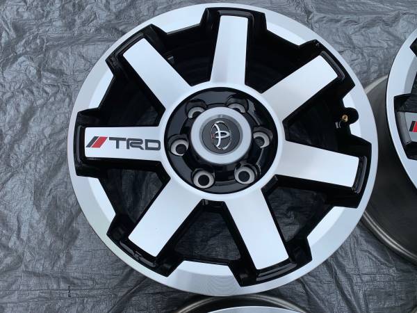

I'm looking to pick up a 2nd set of wheels for my 2008 4Runner SR5 V6 that I can use to mount all-terrain/snow tires on. I currently have the following wheels:
17" Factory OEM wheels: Part Number: 4261135271 Product Number:W69429MS Size: 17" x 7.5" Diameter: 17" Width: 7.5" Lugs: 6 Bolt Pattern: 140mm Offset: 30mm Style: 5 Spoke I have the opportunity to buy a set of 4 stock wheels off a 2015 4Runner Trail Edition. These are the 7 spoke rims that are silver with black outline. This is the only info. I could find on them: 4261135540 | 75154MB WHEEL | OEM ORIGINAL ALLOY WHEEL WHEEL SIZE17 X 7.5 BOLT PATTERN6 X 5.5 FINISHMachined Face/Black Pockets Will these fit my 2008 4Runner? A lookup on google shows that these wheels only fit the 5th gen 4Runners but was wondering if these will also fit 4th gen. Thanks, Dave. |

They'll fit.
I have 2017 Trail Edition wheels on my 05 SE and they fit with no issues. I know offsets can be different but the bolt pattern on the 4Runner has been the same since its conception.
I just found out that my stock 17" wheels have a 30mm offset and the 5th gen 17" Trail Edition wheels I just purchased have a 15mm offset. Will this 15mm difference cause any issues? Am i going to have issues with rubbing?
Thanks for the response. Do you know if the offset of 15mm will be a problem for my 2008 SR5 V6? The stock 17" wheels have an offset of 30mm but the 2015 Trail Edition wheels have an offset of 15mm which I believe will make them stick out a bit more. I plan on putting 265/65-17 AT tires on the new wheels so I'm sticking with the stock tire size. I'm just not sure if the offset will cause an issue.
