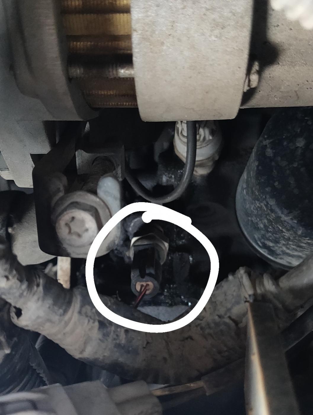

Toyota to Aftermarket Oil Pressure Gauge Adapter this is where you will want that adapter <a href="https://imgur.com/Ht7UIBX"><img src="https://i.imgur.com/Ht7UIBX.png" title="source: imgur.com" /></a> FSM specs for oil pressure <a href="https://imgur.com/80HaLnh"><img src="https://i.imgur.com/80HaLnh.png" title="source: imgur.com" /></a> I just have a test one Engine Oil Pressure Test Kit once I have verified the pressure I will remove it. you can leave this one on the truck and just tuck it over by the battery and drive around. then check pressure whenever you want. |
Any one know what the threads are for this pressure gauge block port? I like to get a T so I can port in a A/M gauge or tester from time to time. Could make a decent mod and have a dash oil pressure gauge like years past..:-)
What did you do with the factory sending unit when you connected the aftermarket one in it’s place?
This is a 1/8” BSP thread T. https://www.ebay.com/i/332974988369?...iABEgJv2PD_BwE Better description on this one of it containing both NPT for aftermarket sender and BSP for OEM sender. 1/8" BSPT Oil Pressure Sensor Tee to NPT Adapter Turbo fits Lexus Toyota Mazda | eBay The China seller add uses some of the same images as the US seller add. |
Quote:
1/8" National Pipe Thread to 1/8" British Standard Pipe 5vz has BSP and most aftermarket stuff in US is NPT I have the yota shop one and it works fine. it's a bit tight in that spot but it does fit. |

@sleepydad
and@ Dieselchessy. I am liking that threaded one as we don't have a lot of space in that area as sleepydad pointed out. :-)
I would have both the OEM one in and the A/M digital one in. I have no reason for a mechanical if I am going to place one in my console. I like that we can just put some thread tape on and nipple that off if need be as well. :-) |
