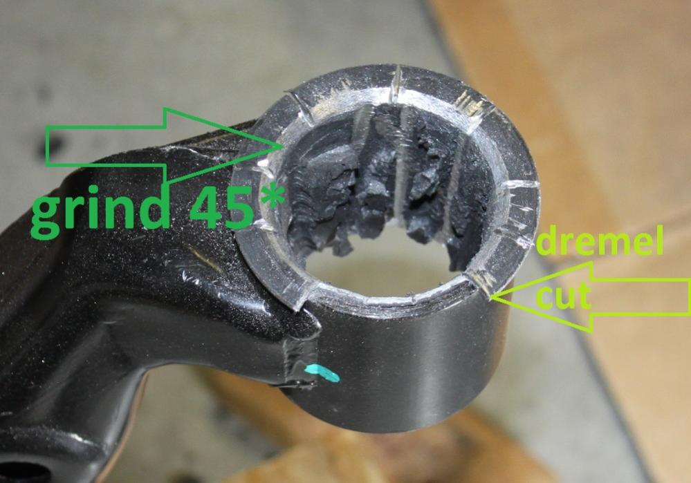

I'll do the best comparison I can after the massacre of seized cams haha. Just looking from the outside, everything appears to be the same. Of course, they could be different on the inside. Yeah I had read about superlube, but also considered some marine grease. I was figuring a grease aimed to withstand water might do well on the suspension that gets splashed or submerged, but I dunno. Still gonna finalize by research on that Oof, looks like a lot of cutting. I'm hoping I can melt the circumference so it will release and then either bottle jack or press them out the rest of the way. The jack method scares me that it could bend the control arm. I've seen a few other tricks on tacomaworld, but I'm also ready to go buy a big press from harbor freight. New toys are always fun |
