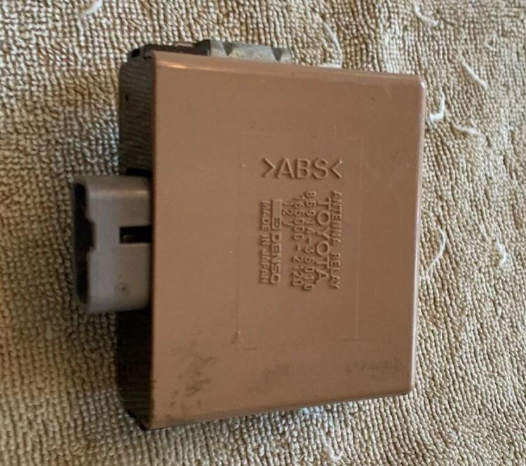

You can pull the antenna relay. That should cut power to the antenna. It's under the dash.
how long did it take to find that with antenna relay in tiny little letters in with everything else and ABS all by itself out to the side :wtf:
I second the idea of simply unplugging the antenna relay. This way, you or a future owner can reconnect the power antenna without any effort or confusion. I see it as the simplest and most "proper" idea rather than cutting wires.

what.....I did not know there was one....where under dash ? Yep first thing I saw was ABS learn something new every day thanks for sharing this |
wow....for fun punched in the relay # as listed on relay. In part to see if it came up as controlling anything else...nope comes up as antenna relay.. List price $304 and only 245 at camelback :)
that is one spendy relay , esp if all it does is make the antenna go up and down |
The relay is going to be tucked into the dash, I believe for a 2000 it's on the right side, on one of the metal support structures. You'll have to remove the center dash bezel to get to it. Not hard but seeing that you have the wood grain dash it's probably going to crack and you'll lose a few clips that will break off (cannot be replaced).
If the prospect of potentially ruining your center dash bezel does not sound appealing, you can also unplug the motor in the wheel well. You'll see the short wiring harness here: https://www.toyota-4runner.org/attac...ntenna-004-jpg Took this from a write up located here: Power antenna fix with pic's |
