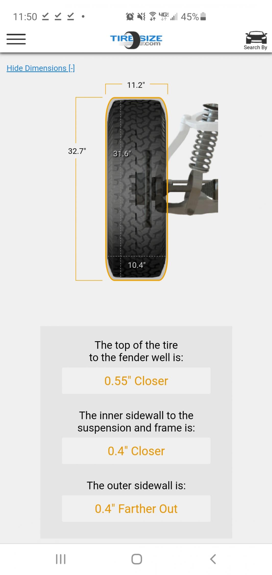

1 Attachment(s)
I would recommend you get the best-quality 275's and call it a day. Maybe add full aluminum skids.
I personally would get the 285's, and do a BMC if needed. With your factory TRD wheels, may well not need the chop. May need a little plastic work on the liner, but that is easy. Mudflaps will have to go. The 285's will be 0.68" bigger at the corners, so at full lock, if you are not within 3/4" of anything with your current tires, you are good. If you later decide you need suspension because you are dragging over things, then do so. |
