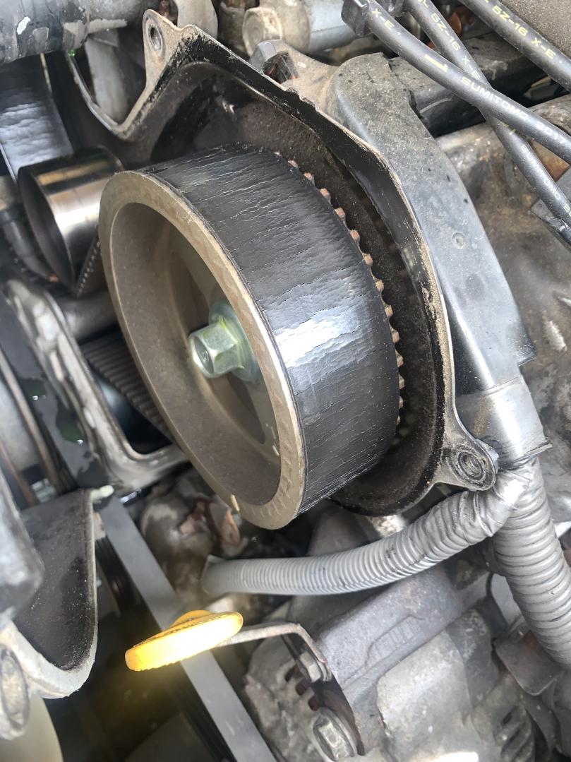

1 Attachment(s)
My 2000 4Runner is (i think) on the original Timing Belt. I plan to change it soon. I got a big surprise when i opened the timing belt cover.
i’ve got almost 250k and the sticker on the timing belt cover says it was done at 80k miles i’m guessing that was the only time it was changed
no coolant leak |
Mine was original on my 5 speed when I changed it at 120k and 21 years old. I didnt want to be stranded if it snapped. Naturally it was developing the hairline cracks. :(
