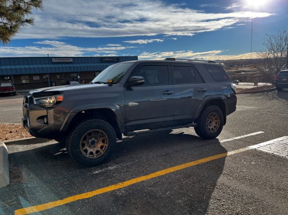

1 Attachment(s)
17x8.5, 0 Offset, 265/70/17, 1 inch spacer up front
- No Rubbing so far - |
