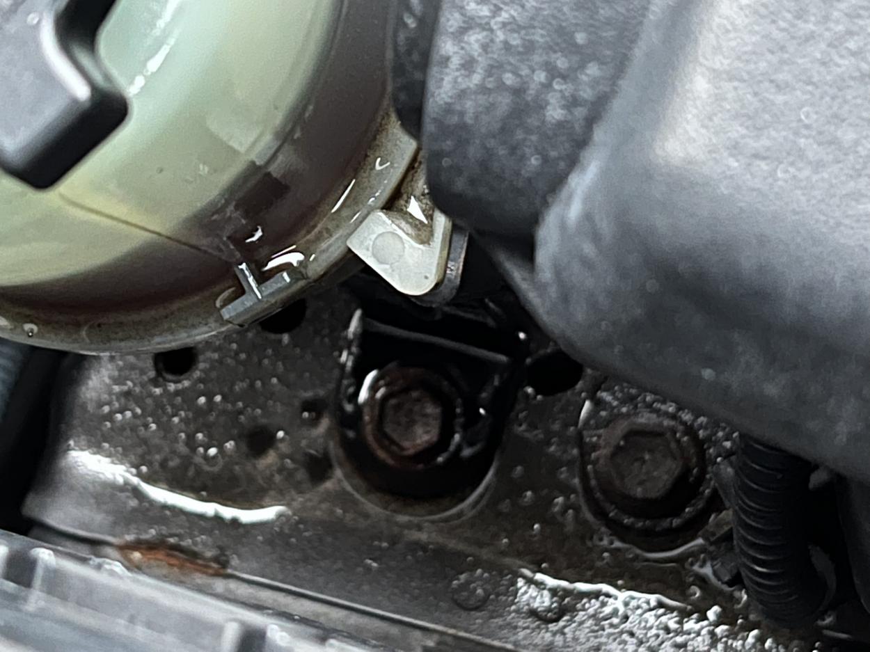

1 Attachment(s)
I can’t imagine that it would have come from anywhere other than the reservoir. It’s difficult to tell if it’s still leaking because there are so many crevices below it that I can’t reach. Is it safe to mix ATF with the Toyota power steering fluid?

Looks like it just overflowed the reservoir. :shrug:
If there's no way to get Toyota power steering fluid I would put some ATF in before I would let it run dry in the pump. But I think I'd prefer the proper power steering fluid. They're both just hydraulic fluids, I just don't know if there's anything seals or hoses or something that would require the use of one over the other. I use ATF in power steering systems on all my old junk. But I would put the right stuff in if it's available because the extra few dollars is worth the peace of mind not having to worry about it.

Looks like it’s definitely the cap leaking, make sure it on there good.
Turning the steering wheel lock to lock with the motor not running is how you bleed a power steering system. It is also part of the process when changing the fluid. At least one of the methods.
