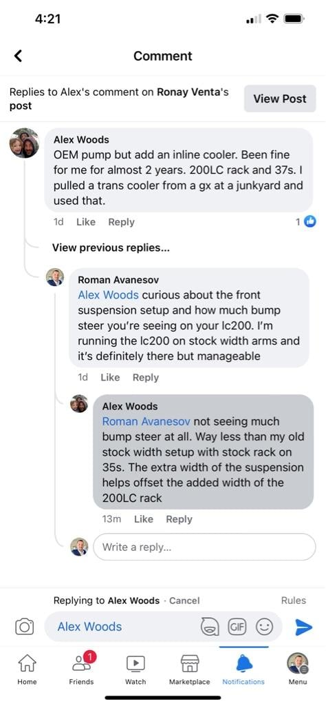

not to revive and old thread, but figured I would document some more feedback.. doesn't make much sense to me whatsoever but people out there apparently running LT with the LC200 rack with no bumpsteer issues :bounce:
so math is either wrong, or people are just living in the fairytale world. Maybe i'm the one missing something here... but all the "calculated" numbers thus far line up pretty close to what I'm seeing real world on stock width.. I just don't see how keeping the same spindle and increasing trackwidth by 2-4 inches DOESN'T result in added bump steer.. https://uploads.tapatalk-cdn.com/202...df88ca0e04.jpg |
