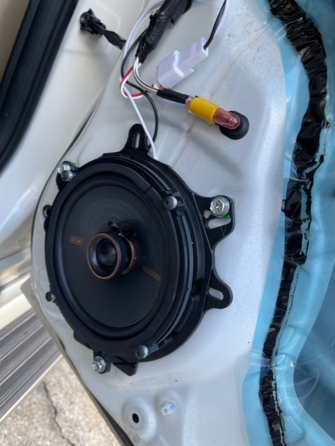

1 Attachment(s)
My 5th Gen Speaker upgrade/setup.
I know it can sometimes be a bit confusing. The automated system at Crutchfield isn't anything more than their vehicle specific recommendations. I did the research before pulling the trigger and my 5th Gen 4Runner now has a great low budget sound system without modifying the stock vehicle wiring.
Lower Front Door/Rear Door: (I installed in Rear Doors) Crutchfield says it won't fit Rear but I used the Kicker OEM spk adapter just fine)
*SEE ATTACHED PHOTO PROOF*
Kicker 47KSC6504
Kicker 47KSC6504 KS Series 6-1/2" 2-way car speakers at Crutchfield
Dash Tweeters: (Component speaker system includes 2 woofers, 2 tweeters, and 2 crossovers)
Kicker 46CSS694
3/4" titanium dome tweeter
Lower Front Door: (Component speaker system includes 2 woofers, 2 tweeters, and 2 crossovers)
Kicker 46CSS694
Kicker 46CSS694 CS Series 6"x9" component speaker system at Crutchfield
Hatch:
Kenwood KFC-1396PS
Kenwood KFC-1396PS Performance Series 5-1/4" 2-way car speakers at Crutchfield
Subwoofer:
BOSS Audio Systems BAB8 Amplified - 800 Watts Max Power, Low Profile, 8 Inch Car Subwoofer
Amazon.com
Head Unit: (In case you're interested)
Boss BV800ACP
Boss BV800ACP Digital multimedia receiver (does not play CDs) at Crutchfield
