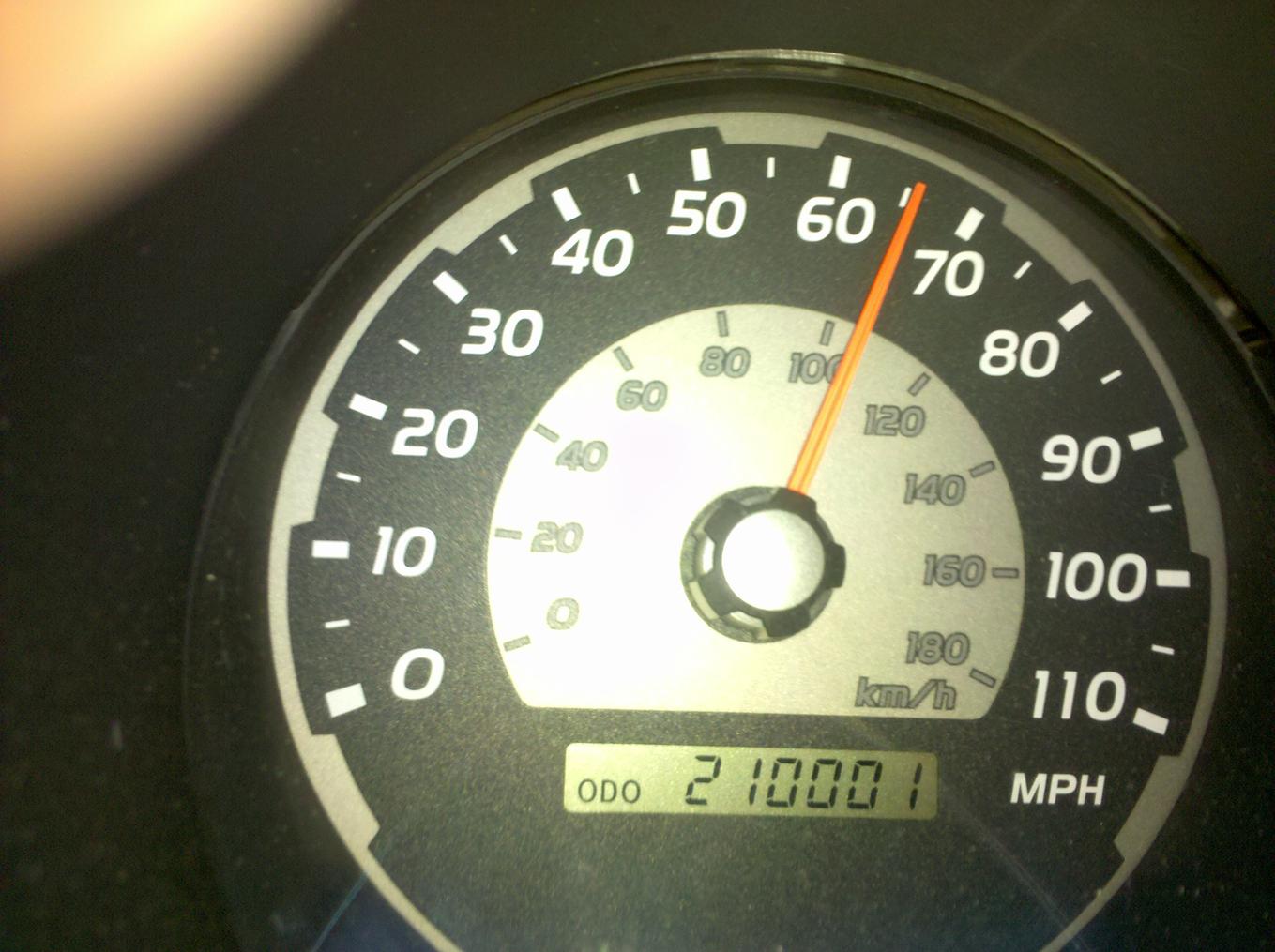

1 Attachment(s)
4Runner8 - I'll get some pics and post soon. Don't have any at the moment. I have white exterior with gray leather interior. Here is the pic of me on the road turning over 210k :)
Attachment 30886
