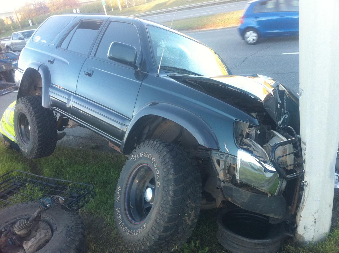

So yesterday as I was driving home from work after picking up my truck from the shop that I always go too. Driving along and all of sudden my drivers side dropped and then lost control. Luckily I was in the far right lane and didnt hit any other cars but there was a pole right in my trajectory. I hit the pole straight on doing about 60 KM/h (37mph). My drivers side front wheel started rolling down the road after impact (Everything still attached to it, half the axle, brakes, and part of my upper) 4runner is wrote, (ill post pictures later).
Anyways, what I had picked it up for is I got my steering rack bushings done and my swaybar bushings done. Im kinda worked up about this situtation cause my babbby is dead, I just want to make sense of things. Could it have been a slip up from the shop? Or was it just bad luck that it fell off after picking it up.

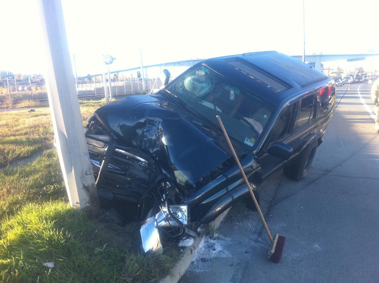

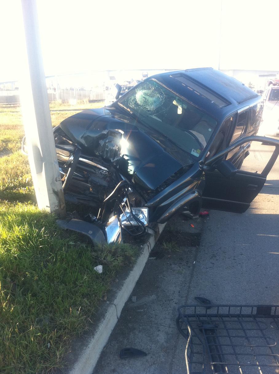

GbRunner 09-28-2010 10:01 AM
3 Attachment(s)
Here are the pictures

peter78 09-28-2010 10:25 AM
When you said you hit a pole, you didn't mention it was a huge cement pole. That is quite a wreck, yes your baby is gone, but I have to ask, are you alright? Also, the passenger window is all broken up, did you have a passenger? I just hope you are all right. Basically you hit a solid pole and came to a complete stop. It does look like the cockpit area stayed intack, thereby not crushing you. Very sorry for your crushed car, but glad you are still around.

LINY4Runner 09-28-2010 11:10 AM
Take the insurance money.
It looks like the lower ball joint failed. Which if done correctly, nothing they did would have caused that. They did steering and a sway bar, neither of which require removal of either ball joints.
I hope you and your passenger are okay, and I'm terribly sorry for the loss of your (and another really nice) 4Runner, but I'd call it a coincidence.
