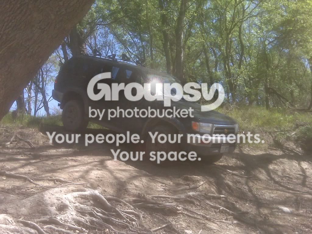

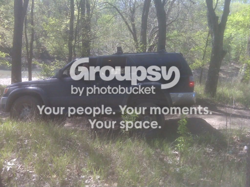

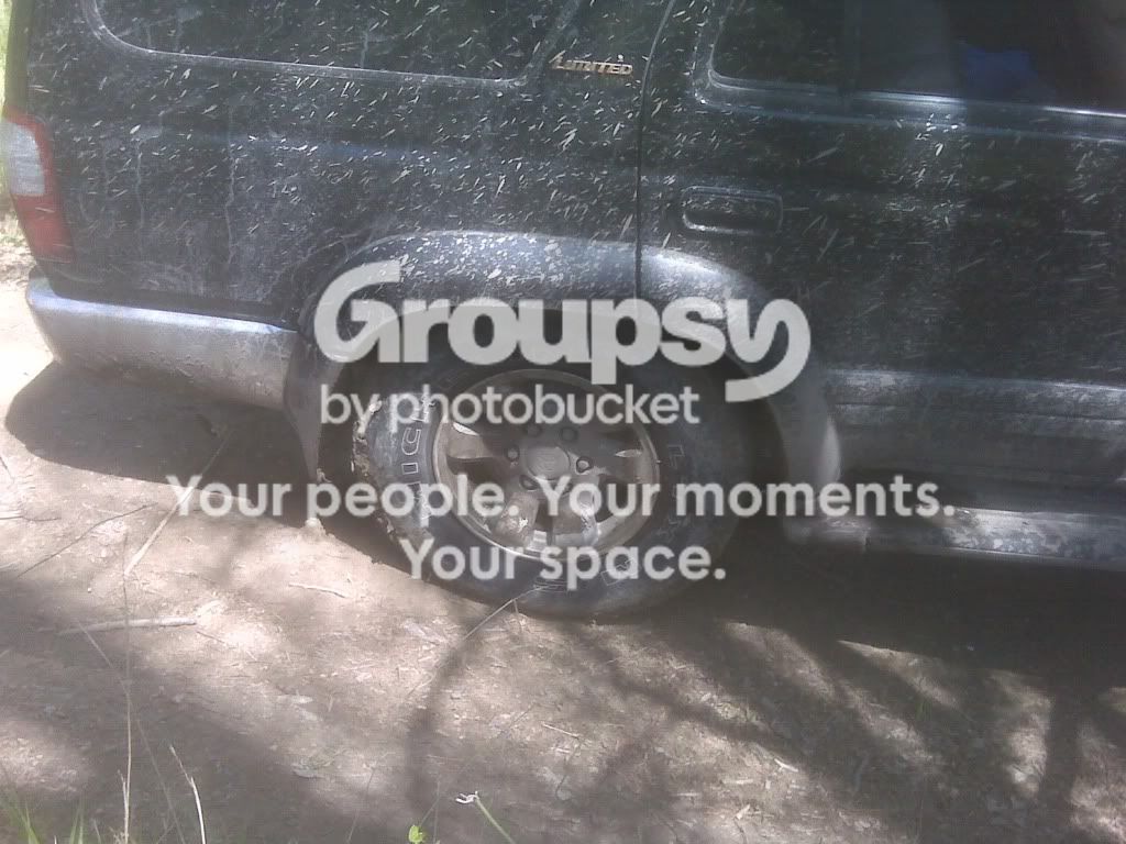

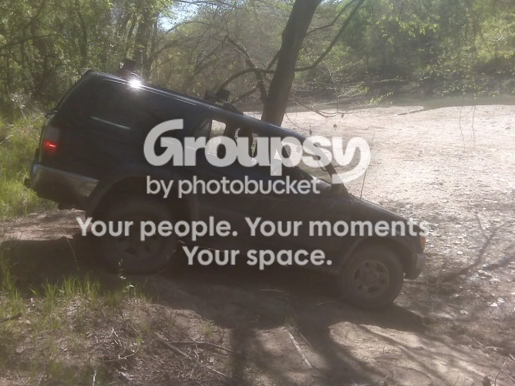

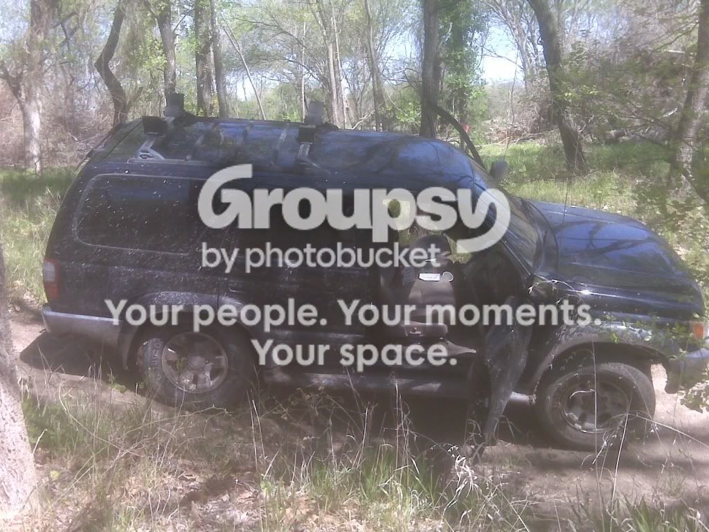

So, a couple questions. I've been trying to find out how high stock 4runners sit as a couple of friends have told me they think it has a slight lift. From fender to ground with 265/70/16 tires it's 34.5" in front and just over 35" in the back. This seems a bit high for stock, yeah?
Although I'm not into the huge lifts I think some day I'll get some 265/75's and the 99 springs or something else that doesn't require the diff drop. I don't know, anything is possible! With that shock/strut leaking in the rear, it looks like I might be doing some suspension work sooner rather than later.... Although, the timing belt calls!
Well, after all that, I forgot most of my questions. So we'll just take this as a 'hello' post.
Oh and yeah, I know, ditch the boards and the gold package HAS to go!

No to address the height issue. My truck with lift sits at 38.5 inches same measure points you used with 33" tires so you are sitting right at stock height no lift.
