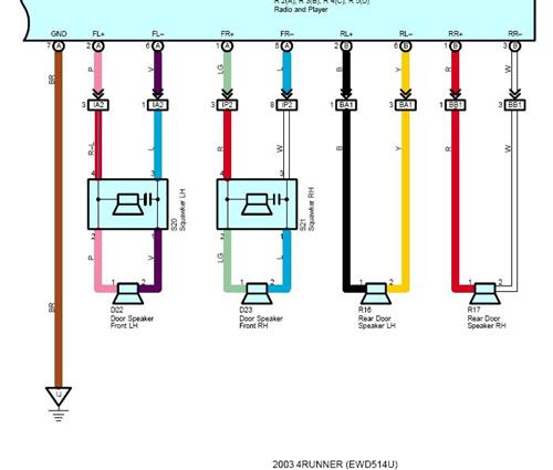

I have the '05 Camry Nav unit and I have purchased Infinity Reference components to replace the front speakers/tweeters and Infinity Reference coaxials to replace the rear speakers. I plan on installing an amp as well, but for the time being I just want to replace the speakers. I have attempted to do this with little success with the fronts. I found this wiring diagram and I am a bit confused with what to do with the stock tweeter wiring.
This is for the 6 speaker system.... Harness behind the HU: Gray=ACC Power Blue/Yellow=Constant Power Brown=Ground Pink=Front Left + Purple=Front Left - Lt Green=Front Right + Blue=Front Right - Black=Rear Left + Yellow=Rear Feft - Red=Rear Right + White=Rear Right - For the tweeters in the Front doors: Left: Red/Blue=Left side + input Pink=Left side + output (then goes to woofer + side) Blue=Left side - input Purple=Left side - output (then goes to woofer - side) Right: Red=Right side + input Lt Green=Right side + output (then goes to woofer + side) White=Right side - input Blue=Right side - output (then goes to woofer - side) The stock tweeters are connected to a clip that has 4 wires comming in and two wires comming out. I have tried to use the positive and negative of the main front speakers to connect to the crossover and then out to the new tweeters and woofers, leaving the harness with the 4 wires unconnected. When I did this I got no sound. I then tried splicing together the positve and negative leads from the tweeter harness together with the main output wires, and I get a very low grade sound comming out of the speakers. I have checked my polarity and everything is connected to the appropiate terminals. What am I missing here, is there a ground that needs to be connected? I am at a loss here, if there is someone out there who has done this, please let me in on the secret to the tweeter mystery. Thanx in advance. |

So then I was on the right track when I spliced the + for the tweeter with the + for the main front and the same with the negative wires, and then ran those to the cross-over and from the cross-over to the new main speaker and to the new tweeter? This is the way I have it now, and the output is much softer than the stock setup (I have only done one side, leaving the other side stock). It sounds as if the polarity is reversed, only I check it and it is not. I noticed when I ripped out the stock tweeter, that it had some sort of resistor or capasitor-thingy attached. Would the fact that I have the Camry Nav unit with its own amp have anything to do with anything? I am thinking of a missing ground.
1 Attachment(s)
The stock front door speakers are wired in parallel. I didn't understand exactly how you wired it, but it should be something like this:
Take pair of wires (the full signal from the head unit) going into the tweeter, wire that to the crossover. Wire the crossover "high out" into the tweeter and the "low out" into your woofer. I changed out my Tacoma stereo way back when with Infinity Separates and the sound was quite a bit lower. I bascially faded the stereo towards the front and cranked the volume. Two reasons, your new speakers are prolly much less effecient, plus, since they are presenting a 4 ohm signal rather than ~2ohm (that is two 4 ohm speakers in parallel => 2 ohm load). I could be wrong about all of this so take my advice with a grain of salt. Diagram follows: Quote:
