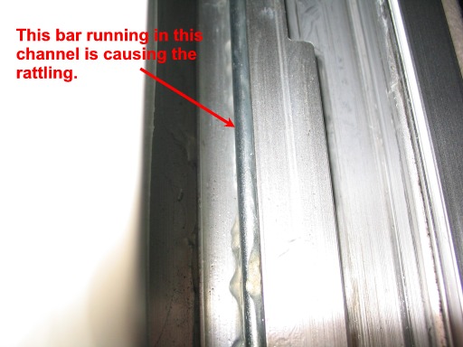

This next picture shows a close-up of the problem area. Note the round bar that runs down this channel. This bar controls the movement of the wind deflector. So it moves forward and backward down this channel. The reason I believe that some people are having this rattling problem and others are not is due to the fact that if the sunroof is not adjusted just perfectly, than this bar has some load on it, which causes it to flex slightly bringing it closer to the channel edge.

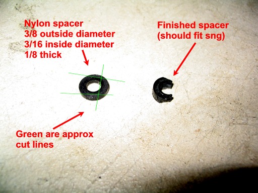

This next picture is of the nylon spacer that I used to fix the problem. You can pick up these spacers at most hardware stores.
The spacer dimensions are:
3/8" outside diameter
3/16" inside diameter
1/8" thick

And this last picture is of the spacer installed. Note that you don't want to spacer to be too tight or it will not allow the bar to move freely.

WhiteSR5,
I tried your homemade remedy....THANK YOU! I found a spacer as close to the dimensions as you suggested and so far no more rattling! I still can't believe that for 50 cents and about 5 minutes, I was able to stop a rattling that the dealership suggested would be "an all day" fix.
I hope others will give your remedy a try
