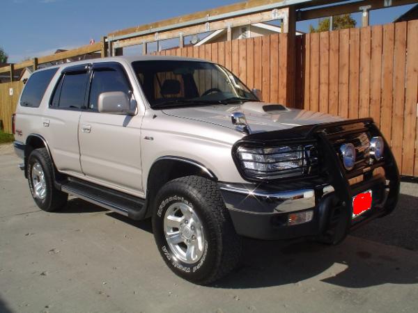

I've got a little dilemma with my 2000 t4r. It seems ive got a continuous drain in the battery. I think i have a short circuit somewhere and i dont know how or where to start looking for it. When i dont use the truck for a few days, 4days the most. You open the door and you can tell right away it has low battery charge bcoz of the dome light is dim and when i try starting it , it almost wouldnt start. I dont have any alarm system or stereo set up on it for the battery to be drained so i conclude that it might be a short. Can u guys give me some thoughts on this or how to solve it. Ive attach a pic of my ride.
