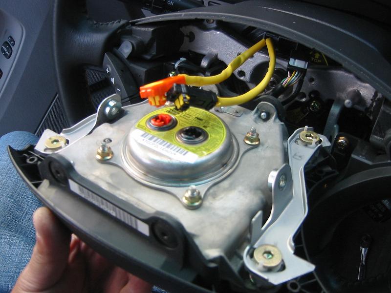

As for the steering wheel, I will try to post a picture of it tonight. But so far, it looks like it's not very normal. Nobody else has asymmetrical lines/creases on their steering wheels? It's the cover with the Toyota logo.
look at this and you'll see why the lines look the way they do:
Slowginjoe, thanks for clearing that up for me. At least now I don't have to worry about the airbag popping out prematurely while I'm driving. I'm going to try to take it to a dealership later today. I guess I'll have to have them drive it to feel the "brake slip feel." Any advice on complaining/questioning?
