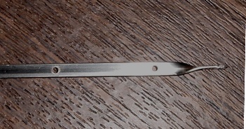

....have drilled holes in the dipstick to get a better read.
You can drill 1/16" holes in the dipstick at the full and add marks.

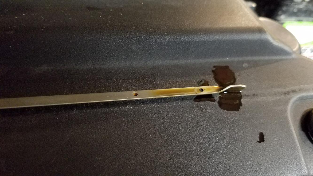

I have a 2007v6 and I've always filled with 5qts and called it good. The "line" was about in the middle (I think). However, based on manual and what was said above I tried adding another .2 qt but now it looks a little high... what do you guys think?
I also tried drilling out the bottom hole... but I'm not sure it's actually easier to read. I just "cleaned out" the top hole (ok the bit broke) but that one actually seems easier to read. Used a 1/16 bit and ran it in the hole for a few min and I like that one better.
Anyway, what do ya'll think about this oil level? Over full? Little full but it's ok? or OMG it's going to blow?
Looks over filled to my eye, it shouldn't be passed the top hole.
But only seeing the one side og the stick it could be OK, I always check it from both side of the stick,
if the level is restively the same on both sides it should be an accurate reading
After draining the oil and the filter, I just fill it with 5 quarts, check the level quickly and never give it a second thought.

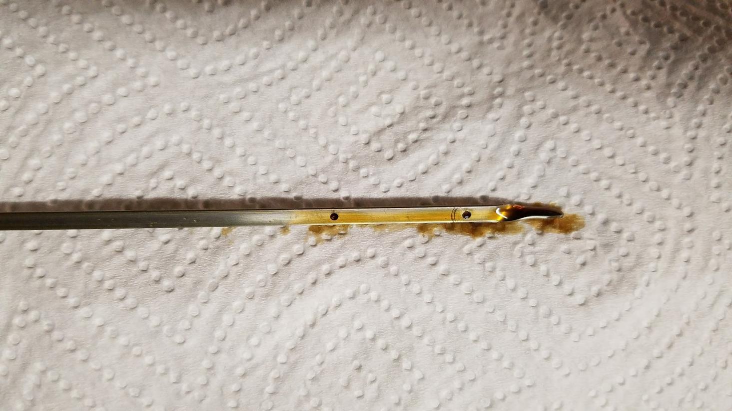

I'm guessing we killed this one but here are some quick notes to help others in the future... I pulled my filter and drained it 3 times to extract .2L of oil (best way I could think of so I could measure systematically) and it's about perfect now. See image below...
Some data points for others not willing to give up.... I have a leveling kit on the front but I jacked up the back to compensate and it didn't make much of a difference. My garage floor slopes 1" to the rear... tried compensating for that also... didn't make much of a difference. I use a 5-us qts jug of Mobil 1 (not 1qt bottles... not sure if it matters), and I have a 2007 4.0 v6 (1GR−FE) with Toyota filter (90915-YZZD3).
