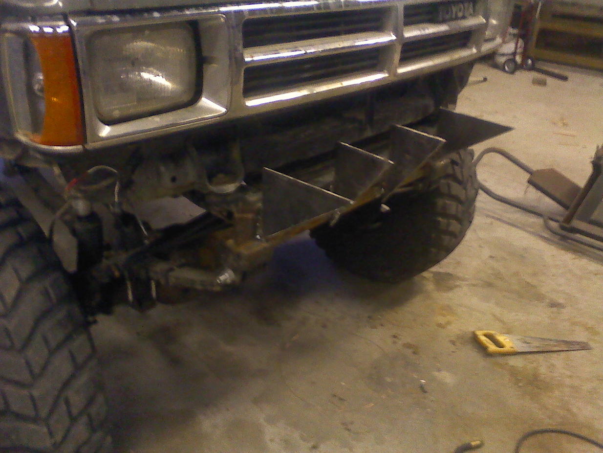

cometobanks New member Jun 8, 2010 #1 Gussets made from 1/25 plate Attachments 0604102030 (3).jpg 138.2 KB · Views: 4,081

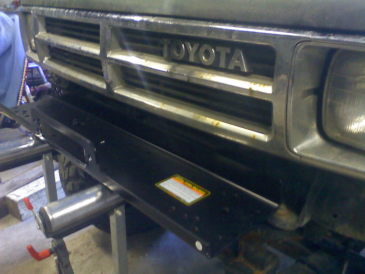

cometobanks New member Jun 8, 2010 #2 Store bought winch plate Attachments 0604101910 (1).jpg 136.3 KB · Views: 1,923

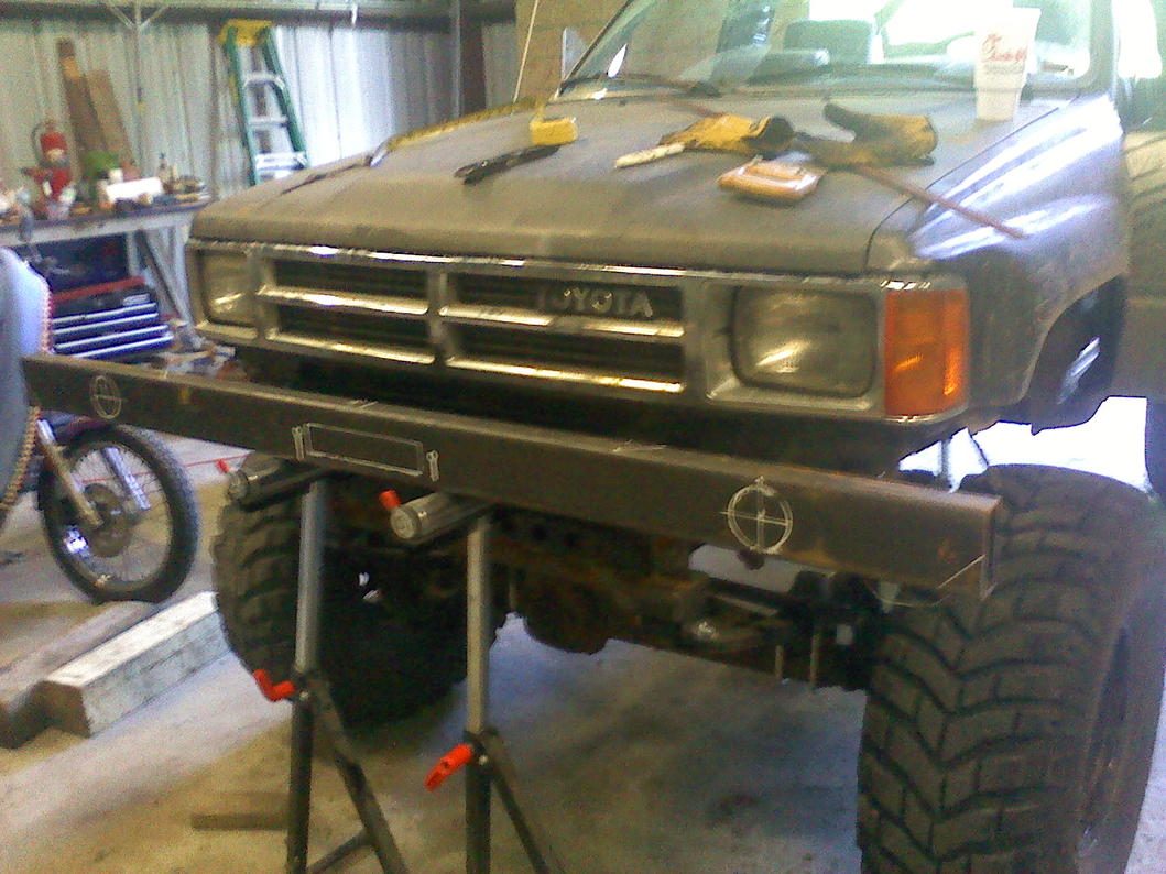

cometobanks New member Jun 8, 2010 #3 2X6 3/16 stock 6' wide Attachments 0604101828.jpg 137.3 KB · Views: 3,395 Last edited: Jun 8, 2010

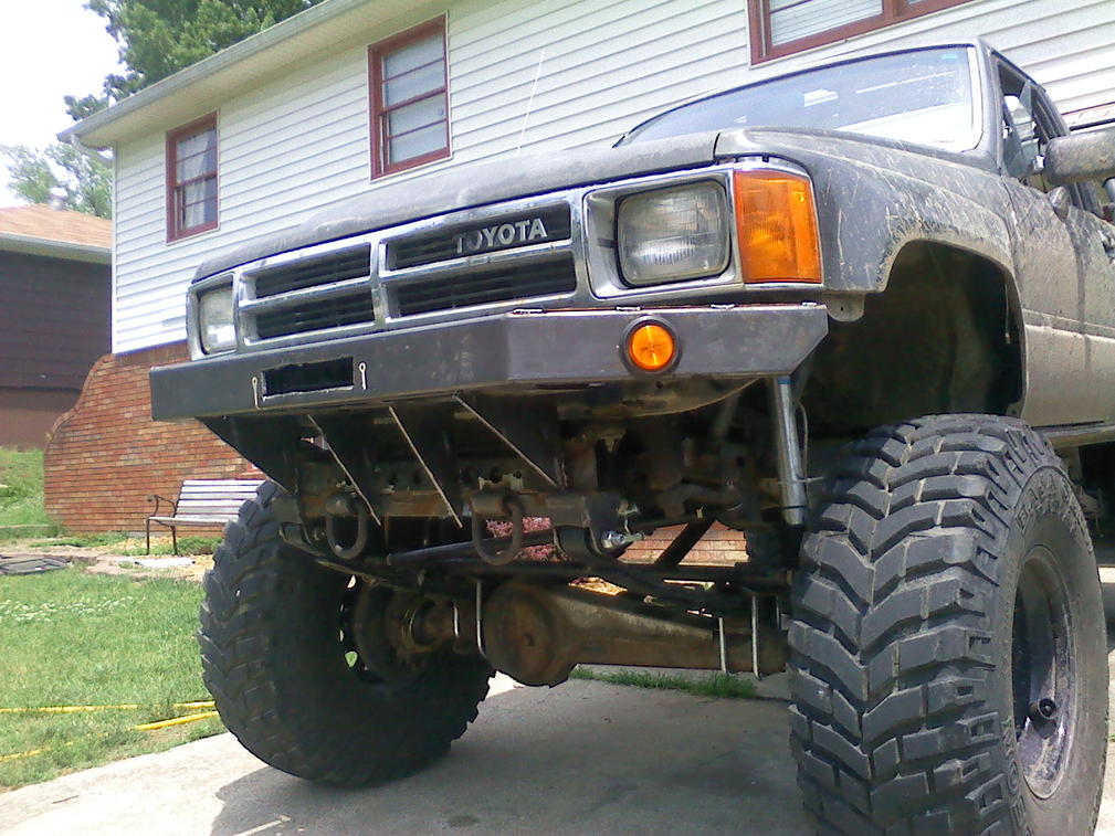

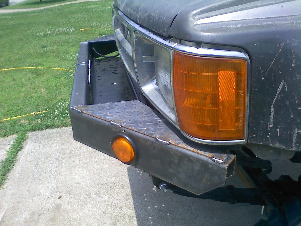

cometobanks New member Jun 8, 2010 #4 bent cut and welded. some 12 ga. floor plate for aesthetics. Tractor Supply tow hooks. Dump truck clearance lights for turn signals. Attachments 0608101420.jpg 136.9 KB · Views: 2,017 0608101421.jpg 138.7 KB · Views: 18,245
cometobanks New member Jun 9, 2010 #6 Yeah, it was tempting to stop at the mad max teeth step and just leave it. Local steel supplier. No winch plans any time soon, but I never know so I always make room for one. Last edited: Jun 14, 2010
