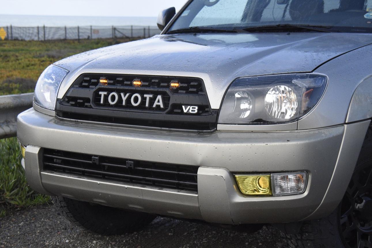

Anzo Crystal headlights were a perfect fit for my 4th Gen and are great-looking headlights with great visibility.
