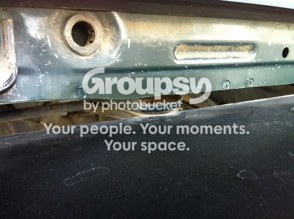

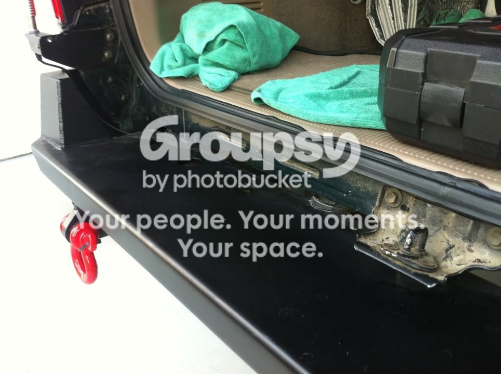

A a few questions on fit. with pictures:
1. Is the front of the plate supposed to fit in this groove or the edge of:

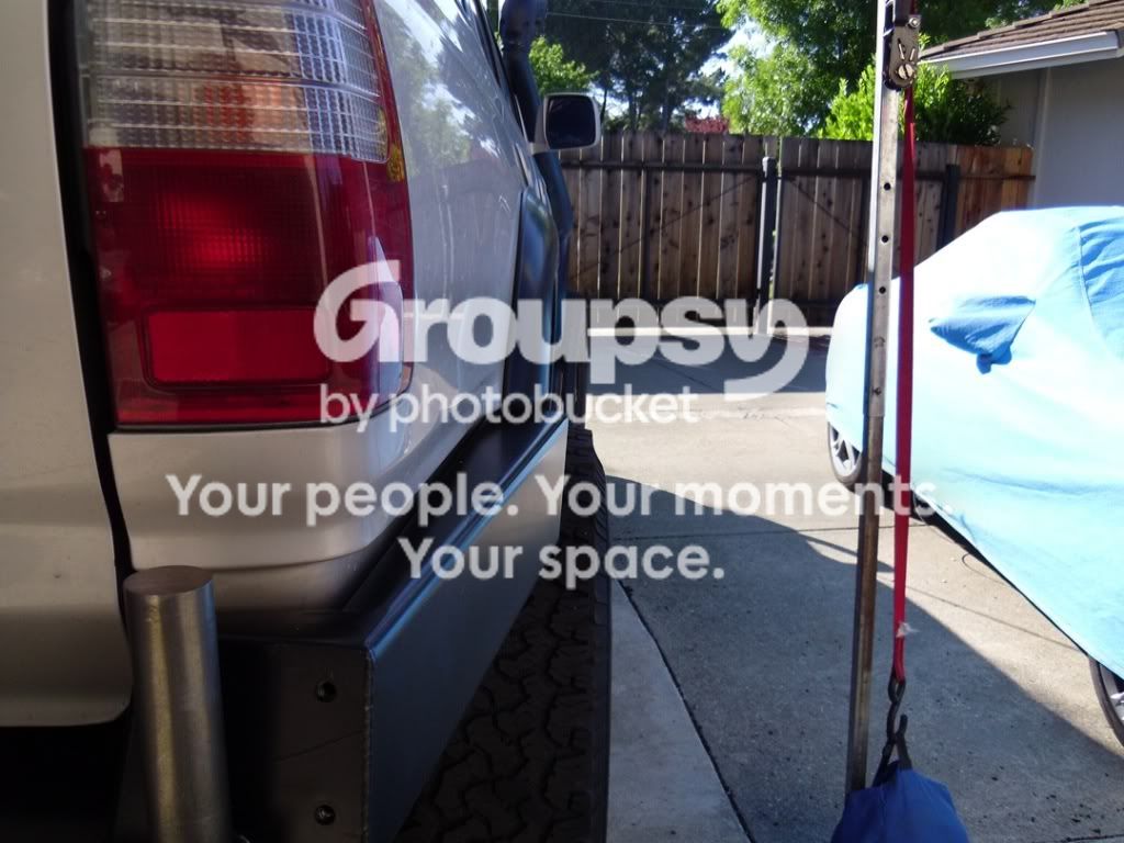

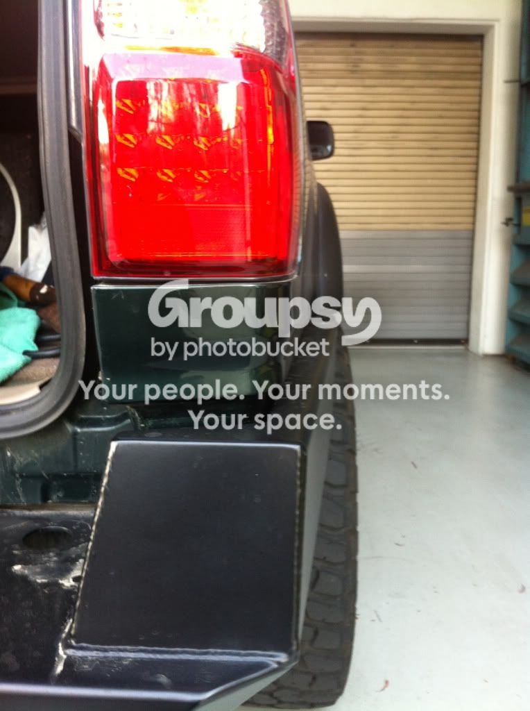

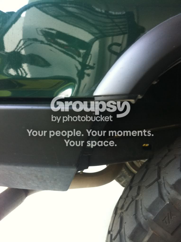

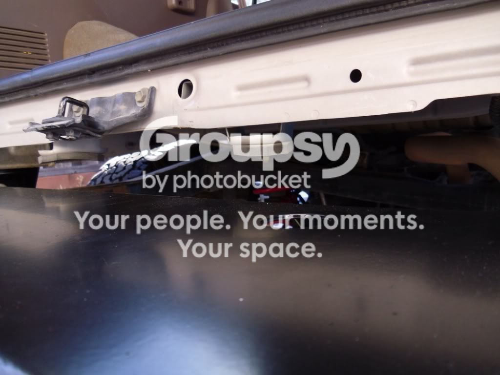

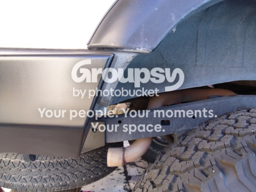

Second does this look right, with respect to the gaps? I would have thought the bumper sides would come forward more? Note: I ordered this bumper to fit with my "bushwacker extend a fender" flairs.
019-1.jpg~original
018-1.jpg~original

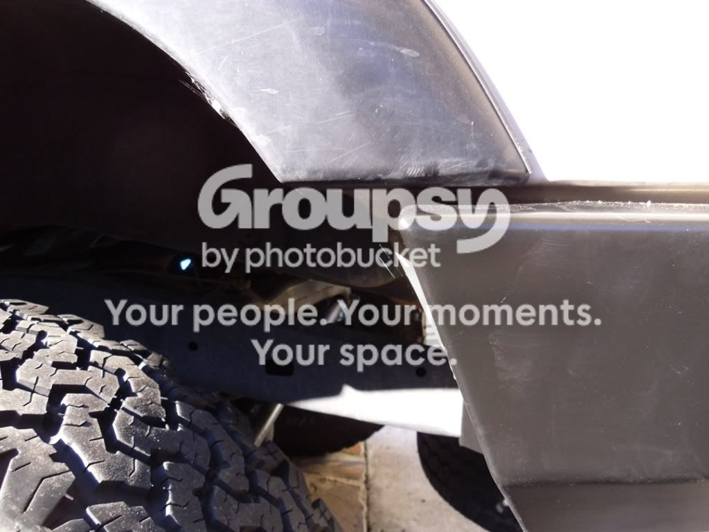

same thing here bumper extends past flairs:
020.jpg~original
Thanks for looking, and the advice. BTW-the bumper is up against the frame rails and as far forward as it can go in the photos.

Second does this look right, with respect to the gaps? I would have thought the bumper sides would come forward more? Note: I ordered this bumper to fit with my "bushwacker extend a fender" flairs. Looks like mine did - I trimmed off the pieces that stuck out beyond my bumper. I thought they looked weird.
020.jpg~original

I cut those spare tire snubbers off mine. They rattled against that top plate on my bumper and it was annoying. The sides of the bumper not extending all the way to the inside of the fender flares are supposed to be that way so you won't rub 33s on the bumper. My 33s are only ~1/32" away from the bumper when I'm fully flexed out. I'm going to have to do some chopping on mine when I get 35s.

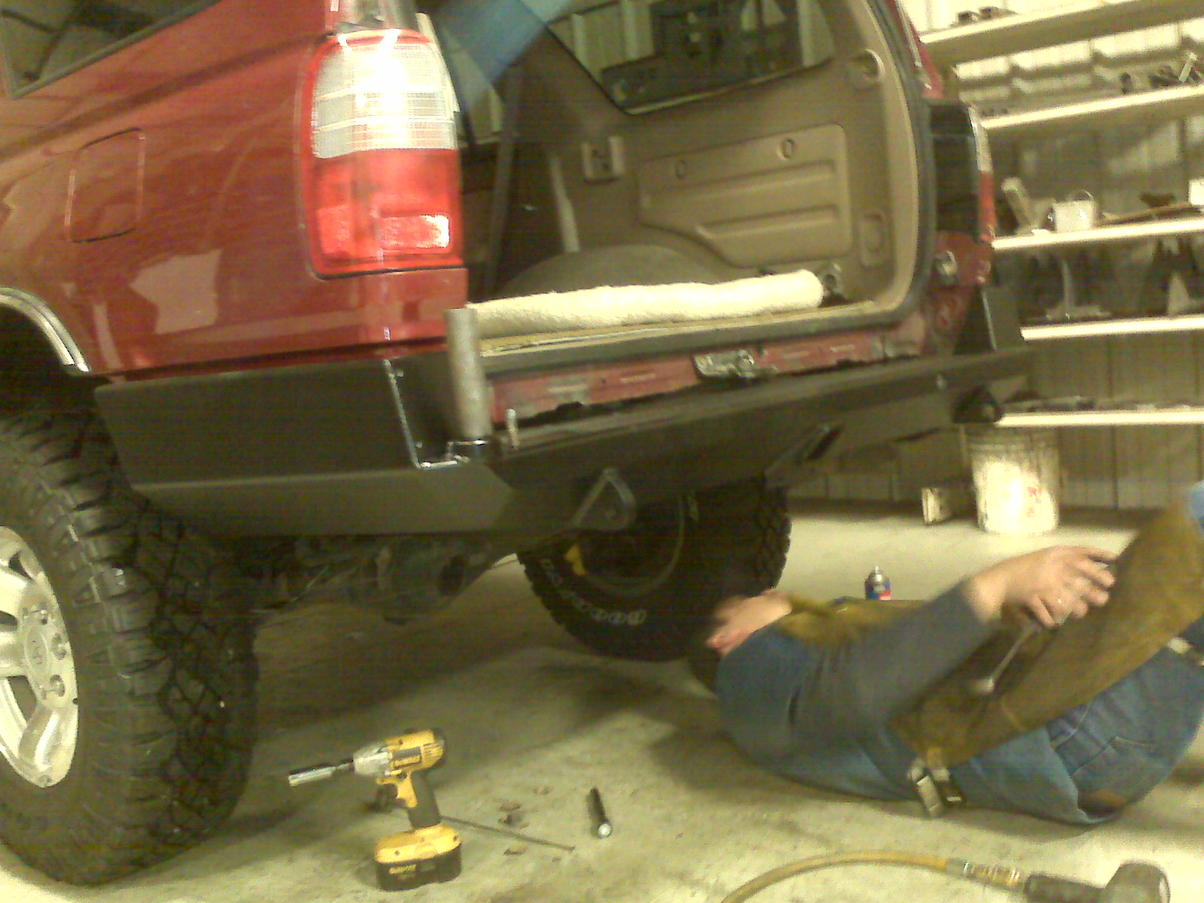

not the best pic but I had to share. the master and maker of these bumpers installed mine.
Steve him self.
(hope he don't mind)

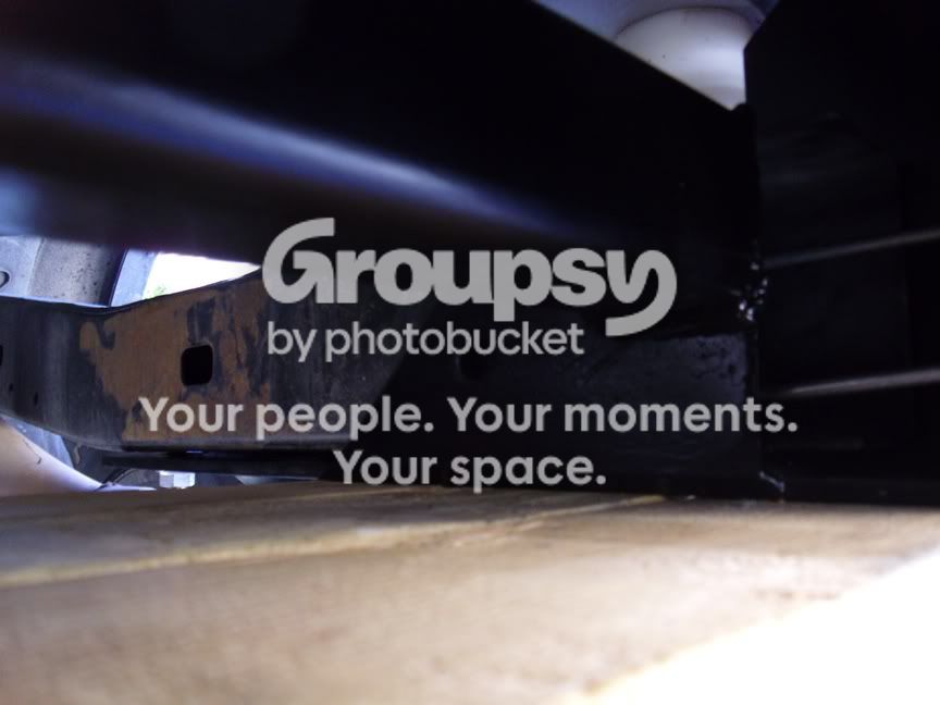

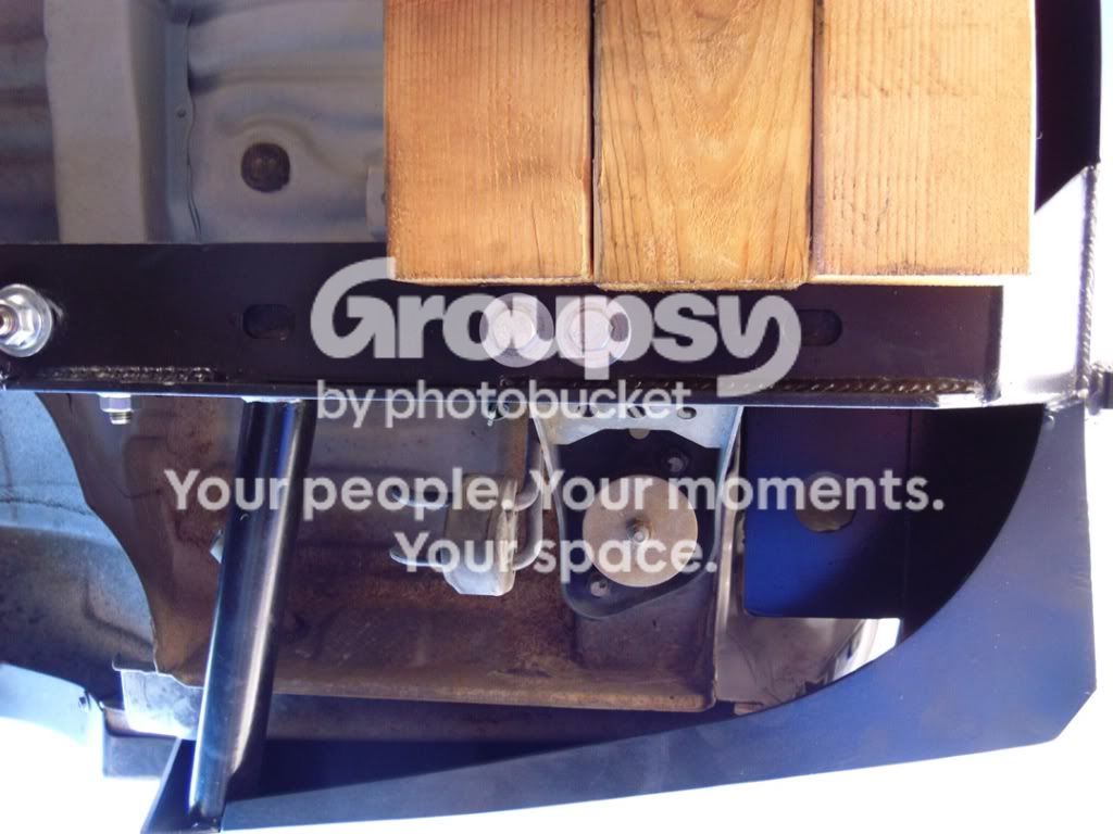

So I mounted the "stick bolts" and the 4 that use the existing welded nuts, but now I have 8 potential holes and 6 bolts left.
Options 4 possibles on the bottom of the frame rail (2 on each side)

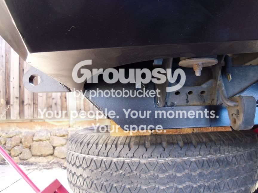

next option outside of frame rail near the back of of the bumper.
009-2.jpg~original
Drill the one on the right - should stop it from levering down.
010-1.jpg~original
You will probably have to grind down the body mounts that are showing - I did. This is the last hole I drilled, figured 10 mounting points was sufficient.

Thanks for the guidance, anyone drilled the remaining holes without removing the bumper? I took a sharpie, outlined the holes on the frame then pulled the bumper off, center punch and drilled. And yea, after I had the exhaust chopped, I did this all on my own! Git er done! By myself this was a total PIA :boxer:to get to this point, really don't want to repeat that.

Yep, got a hold of Nathan yesterday afternoon and got the skinny. Furthest hole back on bottom of frame rail, inside and outside of rails. The most forward of the potential holes wasn't needed.
Went to Harbour Freight Tools after work and bought a low speed drill that would accept a 1/2" bit, marked the holes with a drift punch, removed the bumper (had to) and started drilling away. Lots of oil, and sweating but made it through. Had to stop for dinner. I'll remount the bumper after work and start putting the swingout together.

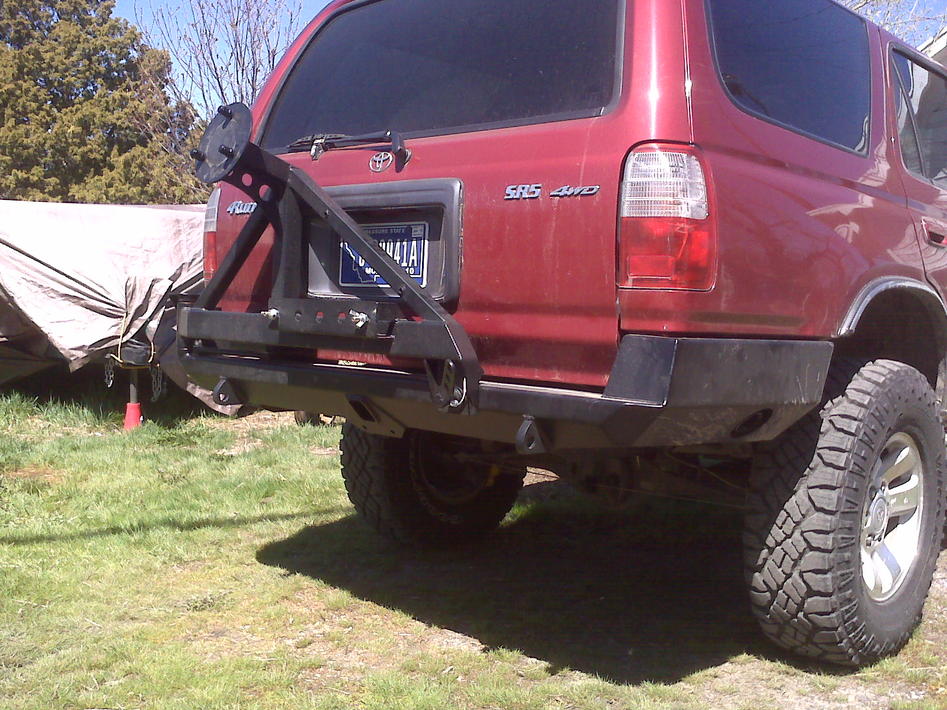

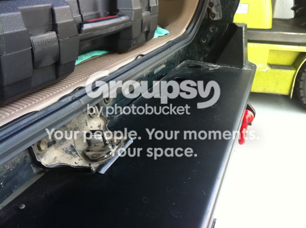

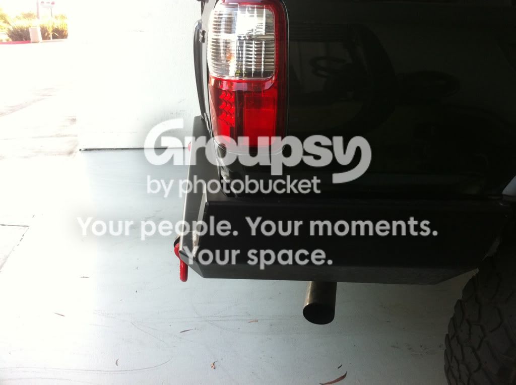

CBI rear w/swing out mounted
Ok, so finished last night after work(mostly). Still need to mount the lic plate light and the lever leash for the swing out.
I'll post some pictures after work.
Thanks for all the advice and pictures that people contributed.
The bumper install is fairly straight forward, but with lot's of pieces and no readily available printed instructions a little/lot of second guessing was present.
