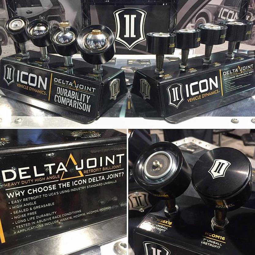

Called the Delta Joint.
These look promising. Should retrofit into most uni-ball UCAs.

A company up here in Canada has been making something pretty much exactly like this (or looks like it at least) for some time now. EMF Rod Ends
Will they fit in my all pros? They have 1.25 uniballs
Sent from my Pixel using Tapatalk
If I had to guess, the "HCOM20" designation in the last line in the picture on the left would be 1.25", based on the designation of the FK bearing HCOM-20T(which is what we use in our All Pro's).
Could be mistaken.
I just realized my initial post was confusing. I typed ball joint on accident instead of uni-ball.. I just corrected it.
These are heavy duty high angle ball joints designed to press in and replace uniballs.

If there's no rubber sealing boot for grease it's gonna just be a gimmick. It'll be a single sided greasable uniball. Been tried before, doesn't work. That's why uniballs are the new hot thing. Now then, if they've found a way to seal the bottom, I'm game for a set. But I haven't seen anymore info on these for a while
See at the bottom where it says "applications include wssx16, hcom16, hcom 20, hcom24"? Those are the bearing sizes. 16 is 1", 20 is 1.25", 24 is 1.5". Wssx is a wide series, stainless steel, non-Teflon lined bearing. hcom is chrome plated, hardened, low carbon steel. Really not sure why icon insists on using predominantly non-stainless steel bearings, aside from being lower cost/higher profit margin

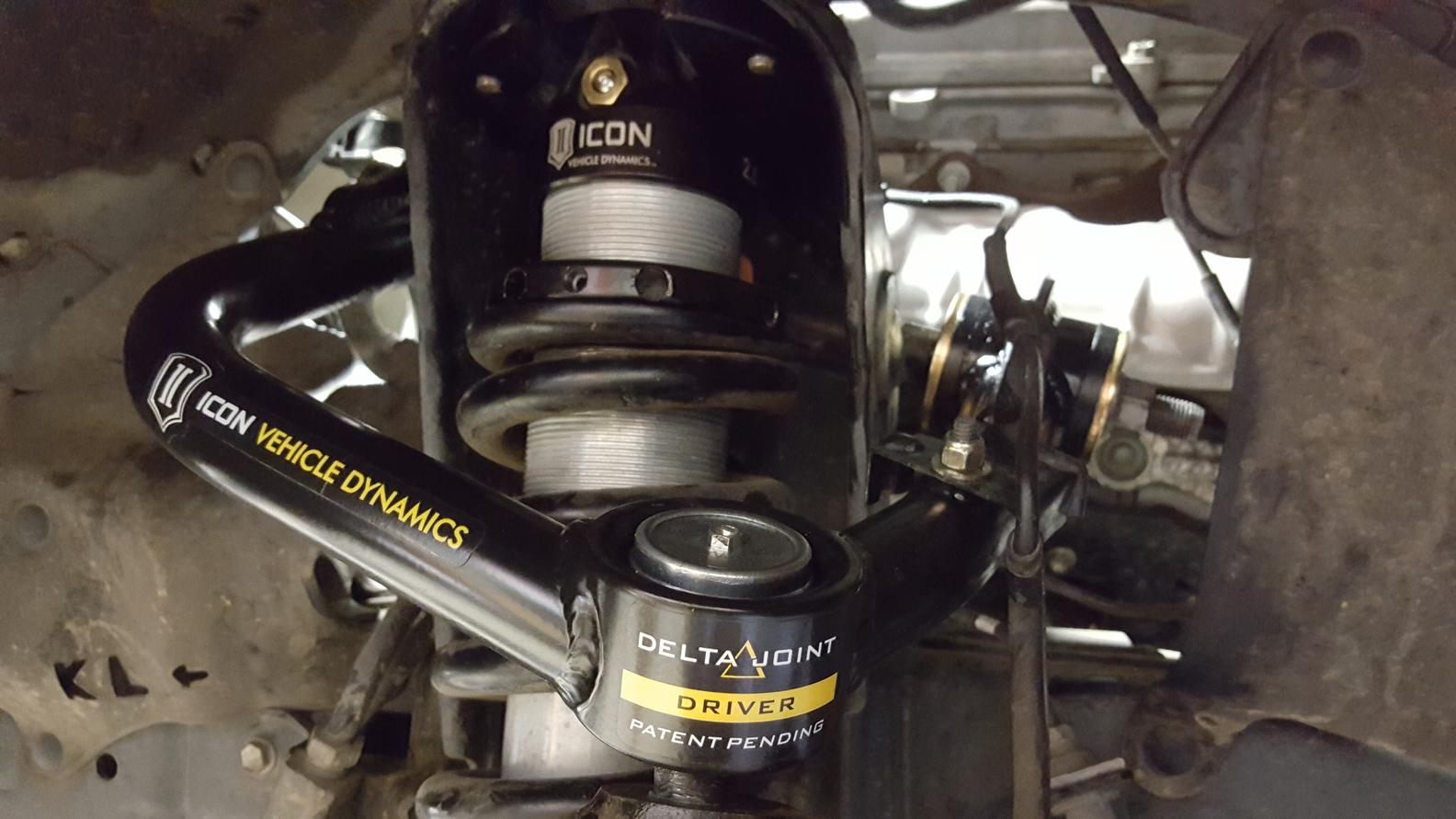

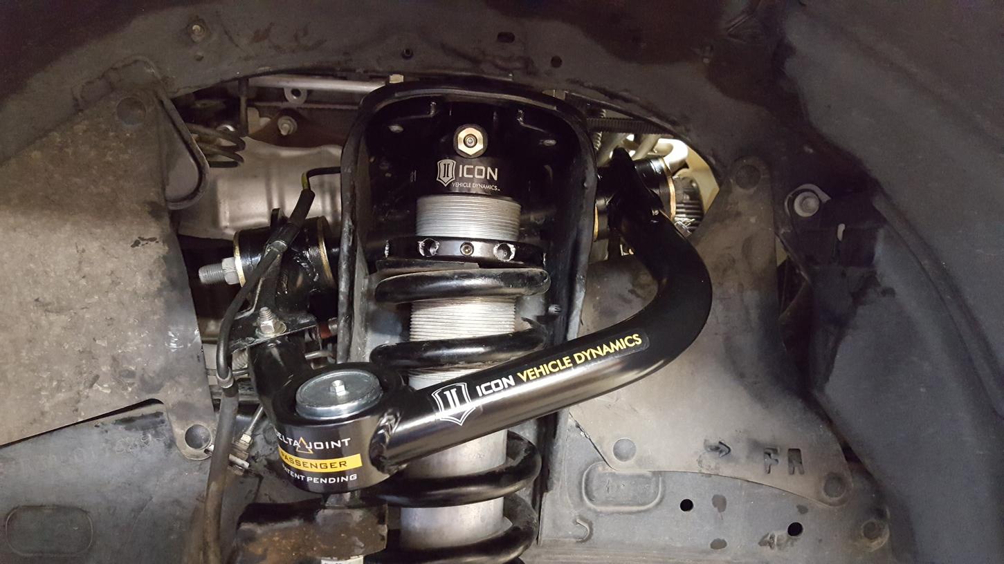

I installed a set on my 10 trail last weekend. Aligned great and no issues/noises DDing it the last couple days.
There is a wiper on the bottom of the joint that keeps grease in and crud out. IMO this is the joint to use if you live in snow country.
The common sizes for other UCA's will be out around SEMA.
It took me about 4 hours to install and that included rebuilding the Icon shocks and dicking around with the KDSS to re-install the shocks.
